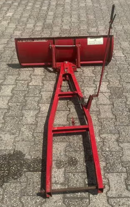

Stan50 247 #1 Posted July 10 I found this snow plow on not -a local - marketplace, extremely rare in EU; Will that fit my 312-8? I suppose that is 42" plow,long frame? I have plow bracket on my transmission. Looks like there is all what is needed. 1 Share this post Link to post Share on other sites

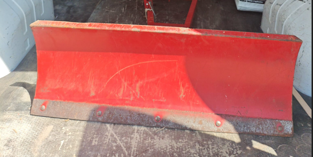

ri702bill 13,365 #3 Posted July 10 Yes, it will fit. And it looks complete, but without the optional bent metal skids. But by using the Dial-a-Height adjuatment, they are nice to have, but not absolutely required. How is the cutting edge? It is symmetrical and can be flipped over - if that has not already been done. 1 Share this post Link to post Share on other sites
sqrlgtr 4,214 #4 Posted July 10 I cant tell in pic but appears the push/pull rod is missing that changes the blade angle. No biggie very easy to fab one up with a couple Heim joints and round stock, all thread would work but not very stout. Very handy piece of equipment and one of my favorite seat times, pushing snow. Share this post Link to post Share on other sites

Ed Kennell 47,887 #6 Posted July 10 Yes, it will make a useful addition for your 312-8. You may have to modify the blade angle lever to clear the foot rest. The lever can be bent, the offset turned around, and spacers added to clear the foot rest. I also like the lever that pulls the locking pin in the front so my fingers are squeezing the lever. If you intend to use the blade for grading , a solid lift link can be used to apply down force for scraping. 1 1 Share this post Link to post Share on other sites

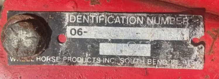

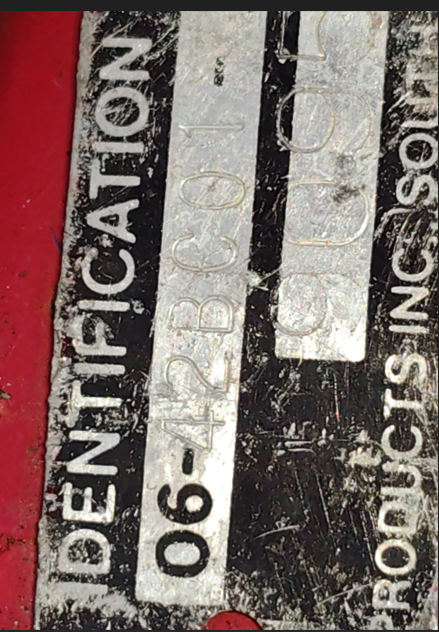

gwest_ca-(File Mod) 12,552 #8 Posted July 10 If you end up getting this am interested in knowing what is on the ID tag. The 9095 build date is not correct. It should be 0095. The end of a calendar year often messed with their Julian build dates. The model number is readable 06-42BC01 - a 1980 model The serial looks like 1116x 1 Share this post Link to post Share on other sites
Stan50 247 #9 Posted July 10 Thanks guys! I will try get that plow then. Just ad pop up today and I was not sure about it. Share this post Link to post Share on other sites
Stan50 247 #10 Posted July 10 (edited) 12 minutes ago, gwest_ca said: If you end up getting this am interested in knowing what is on the ID tag. The 9095 build date is not correct. It should be 0095. The end of a calendar year often messed with their Julian build dates. The model number is readable 06-42BC01 - a 1980 model The serial looks like 1116x Ok, I hope that I get this, I'm waiting for answer from the seller Edited July 10 by Stan50 1 Share this post Link to post Share on other sites
Brockport Bill 2,538 #11 Posted July 10 do you have the rear axle bracket to attach the plow FRAME to underneath the rear axle? 1 Share this post Link to post Share on other sites
peter lena 10,121 #13 Posted July 11 @Stan50 https://www.lowes.com/pd/Hillman-2-5-in-Silver-Hitch-Pin-Clip/3012926?user=shopping&feed=yes-_-0? on the rear axel frame mount hook up , swing lever , bracket there is a small side hole , get a couple of these hitch pin clips , push them thru to the end big hole ? they will not get lost or fall out , lubricate the swing lever . pete 1 Share this post Link to post Share on other sites
Brockport Bill 2,538 #14 Posted July 11 32 minutes ago, peter lena said: @Stan50 https://www.lowes.com/pd/Hillman-2-5-in-Silver-Hitch-Pin-Clip/3012926?user=shopping&feed=yes-_-0? on the rear axel frame mount hook up , swing lever , bracket there is a small side hole , get a couple of these hitch pin clips , push them thru to the end big hole ? they will not get lost or fall out , lubricate the swing lever . pete 1 Share this post Link to post Share on other sites
Stan50 247 #15 Posted July 13 (edited) I get this . I have only a few pics, plow is paid and waiting for delivery from NL , so maybe in 2-3 weeks I will have it at my place. On 7/10/2026 at 7:10 PM, gwest_ca said: If you end up getting this am interested in knowing what is on the ID tag. The 9095 build date is not correct. It should be 0095. The end of a calendar year often messed with their Julian build dates. The model number is readable 06-42BC01 - a 1980 model The serial looks like 1116x Serial # 11164 On 7/10/2026 at 6:26 PM, sqrlgtr said: I cant tell in pic but appears the push/pull rod is missing that changes the blade angle. No biggie very easy to fab one up with a couple Heim joints and round stock, all thread would work but not very stout. Very handy piece of equipment and one of my favorite seat times, pushing snow. @sqrlgtr I think that all pieces are there On 7/10/2026 at 6:13 PM, ri702bill said: How is the cutting edge? It is symmetrical and can be flipped over - if that has not already been done. Edited July 13 by Stan50 1 5 Share this post Link to post Share on other sites
Ed Kennell 47,887 #16 Posted July 13 Excellent condition.. Share this post Link to post Share on other sites
ri702bill 13,365 #17 Posted July 13 42 minutes ago, Ed Kennell said: Excellent condition.. And the moldboard is neither bowed nor bent... not too ofter you find a straight one... Share this post Link to post Share on other sites
gwest_ca-(File Mod) 12,552 #18 Posted July 13 Thank you for the data plate verification Often wondered if the Julian build date 9095 was for Belgium production but in 1978 their serials were up to 16xxx and theirs were consecutive from year to year. This proves it to be South Bend produced. 9095 clearly a mistake with a serial that high. Some were produced 9095 but with lower serial numbers. 1 Share this post Link to post Share on other sites

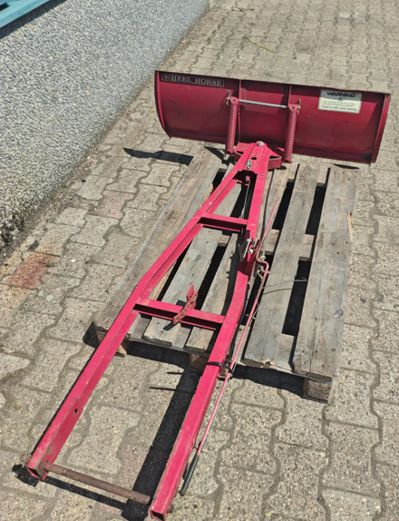

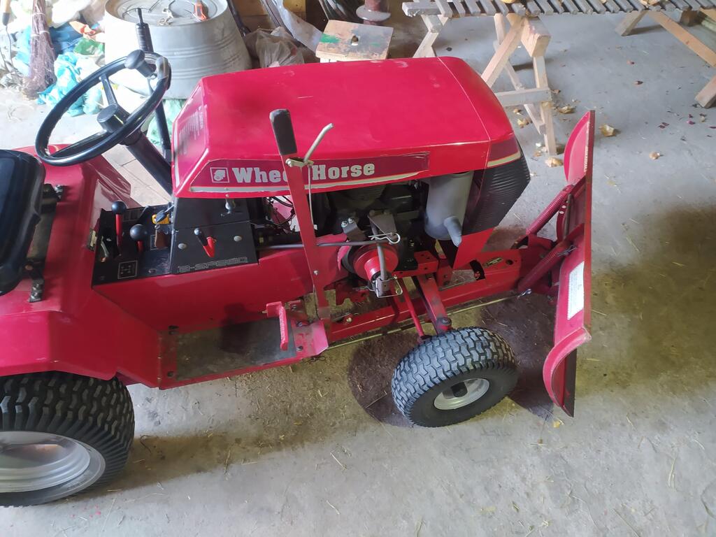

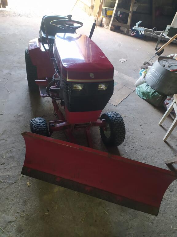

Stan50 247 #19 Posted August 19 Finally I have it installed , all the pieces are there (almost), works as it should. I have to tweak some things here and there, I probably oil rusty parts, I am not going to paint it. Pivot points needed some grease. There is connection bar with holes, I don't know, maybe chain links are better? I installed plow just to check if everything works. . 2 Share this post Link to post Share on other sites

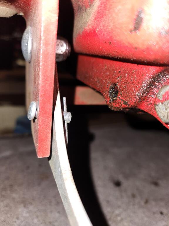

Stan50 247 #20 Posted August 28 Guys, how to set blade just above ground in down position,lets say 1/2- 1/4 in? I don't have dial a height/knob. I'm gonna install rubber mat under the cutting edge anyway, but is there a way to raise it a little bit when plowing snow? Share this post Link to post Share on other sites

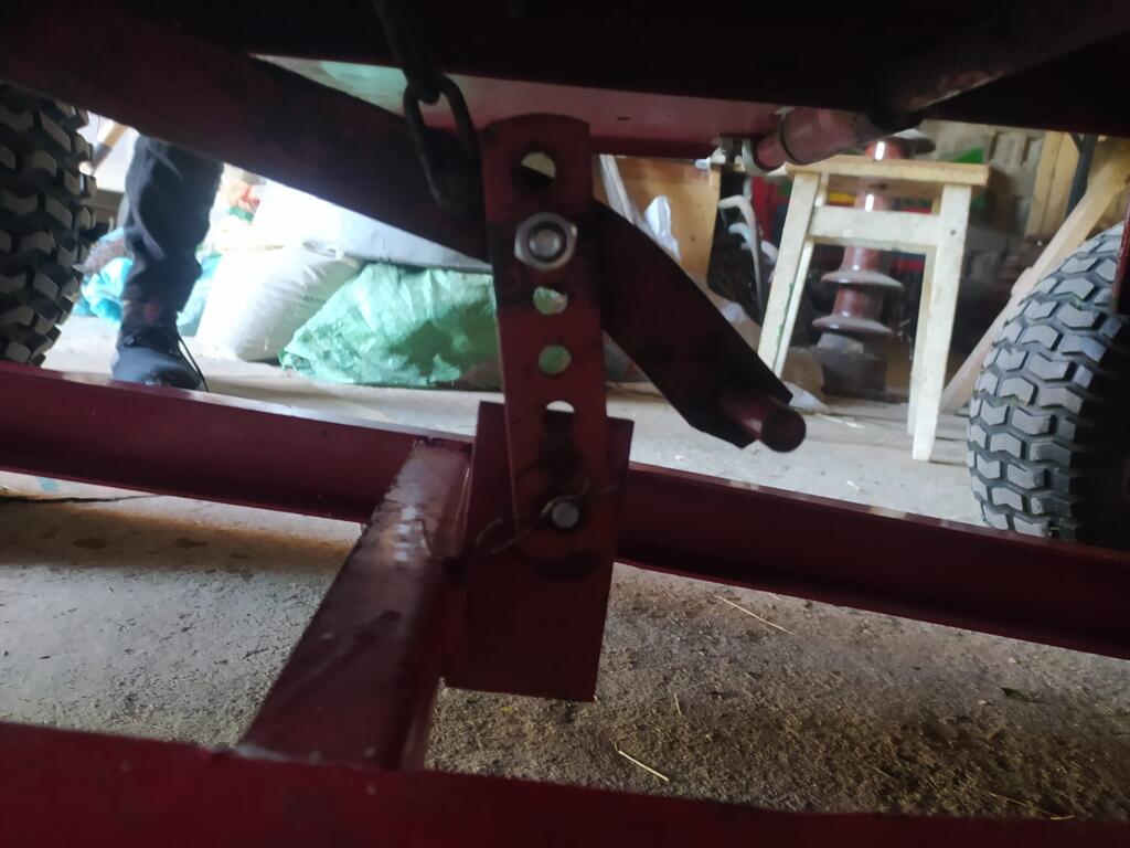

Ed Kennell 47,887 #21 Posted August 28 I and others have added a anti sway device to the front of the plow frame to keep the blade centered. On mine I can also adjust the minimum blade height on this device. I use it when plowing the stone roads. Dozer blades..Keep em centered. - Implements and Attachments - RedSquare Wheel Horse Forum 2 Share this post Link to post Share on other sites
Stan50 247 #22 Posted August 28 Great! Thank you. 2 in 1! I like it and it will be my next project 58 minutes ago, Ed Kennell said: On mine I can also adjust the minimum blade height on this Treaded rod,washer and nut to adjust blade height? or just a couple pins with corresponding holes? I assume that lower part of that vertical rod should be smooth, so pins are way to go? Share this post Link to post Share on other sites
Handy Don 17,731 #23 Posted August 28 14 minutes ago, Stan50 said: I assume that lower part of that vertical rod should be smooth, so pins are way to go? Yes, smooth at the bottom. Threads will wear--both the hole and the rod. You’d need very sturdy through pins in this application to handle the shear forces. Alternatively, you could weld a flange onto the bottom end of the rod (under the plow frame) and do the adjusting with nuts on a few threads at the upper end (above the bracket on the attach-a-matic adaptor). That way, the plow frame floats on the smooth part of the rod and not the threaded part. Note that a minimum height setup is great on the level, but dips or rises on the driveway are another matter! 1 Share this post Link to post Share on other sites

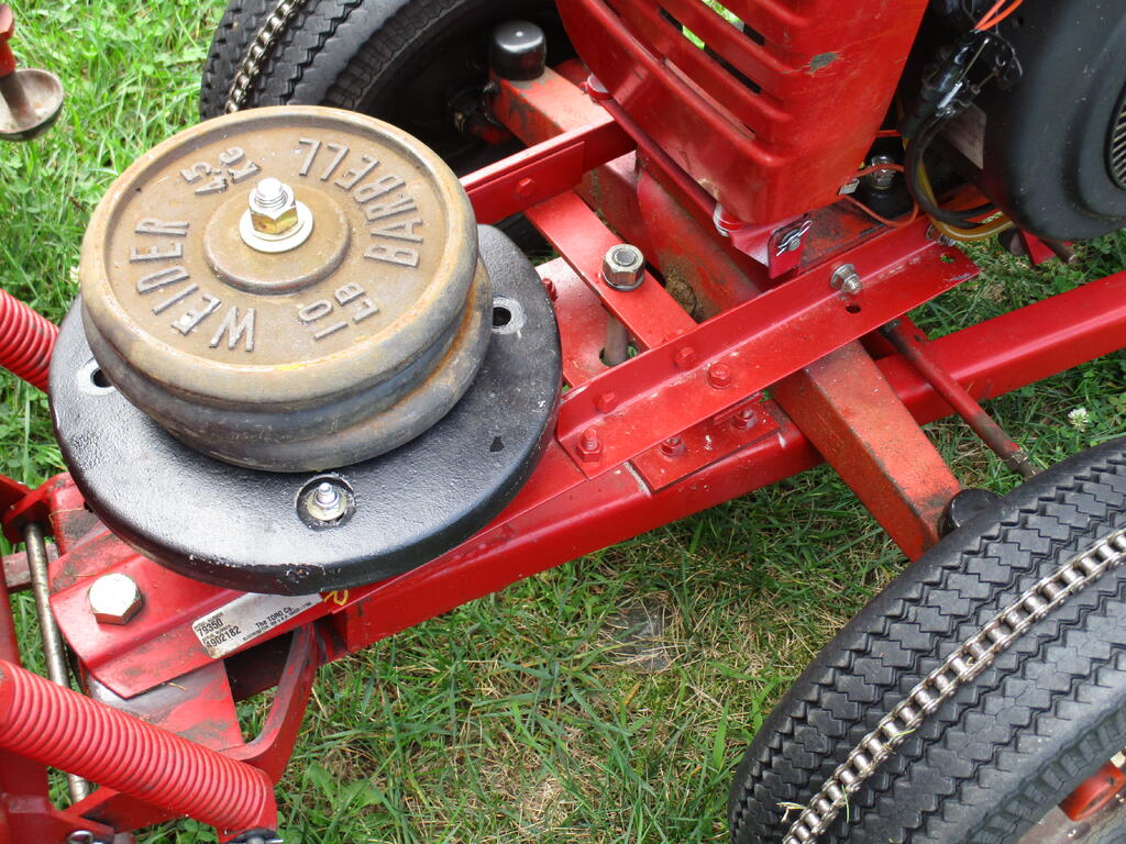

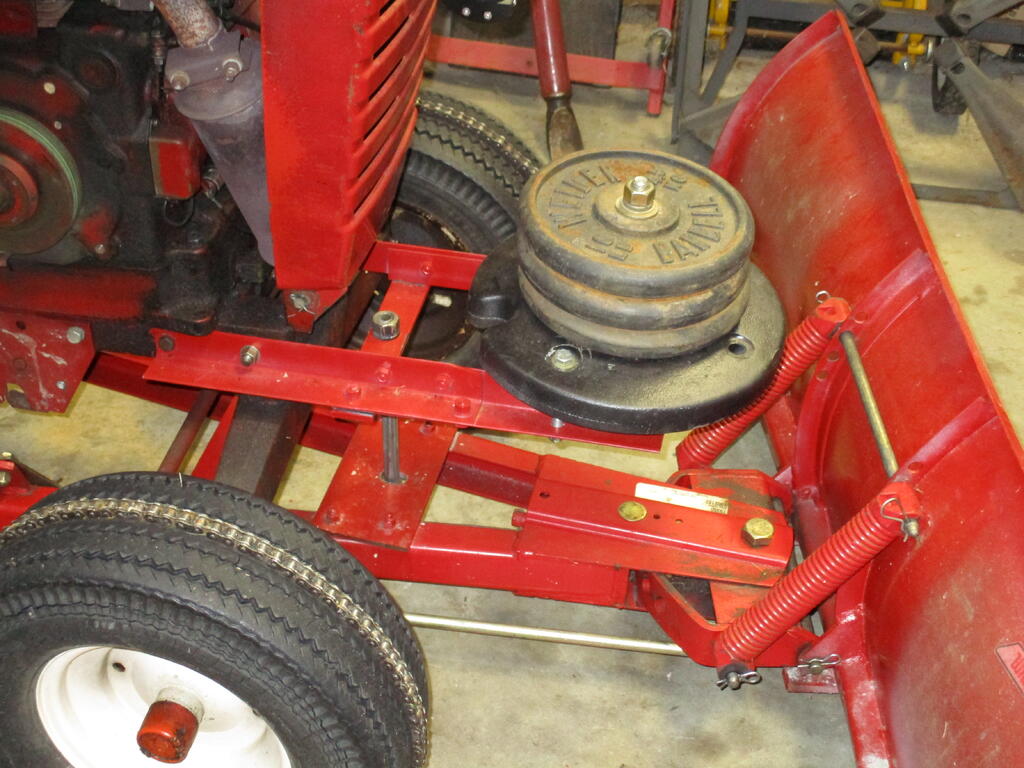

Ed Kennell 47,887 #24 Posted August 28 1 hour ago, Stan50 said: r just a couple pins with corresponding holes? I drilled 1/8" holes every 1/2" and use a washer and hairpin clip to set the blade height. 1 Share this post Link to post Share on other sites
