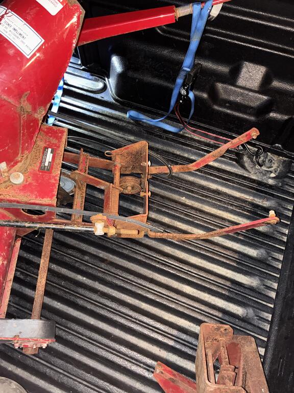

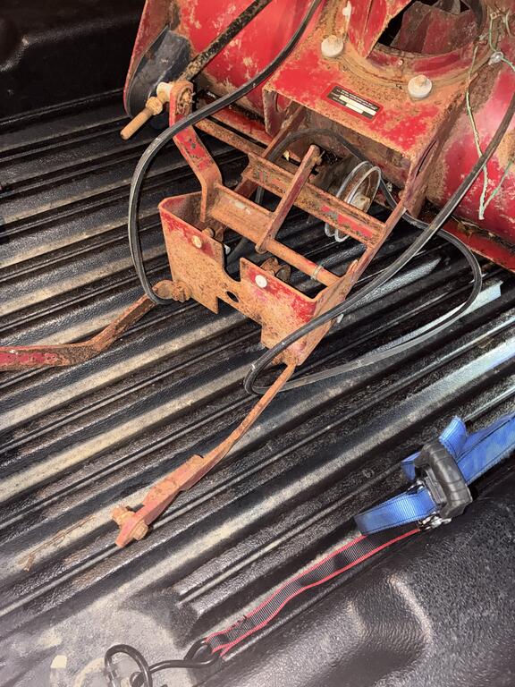

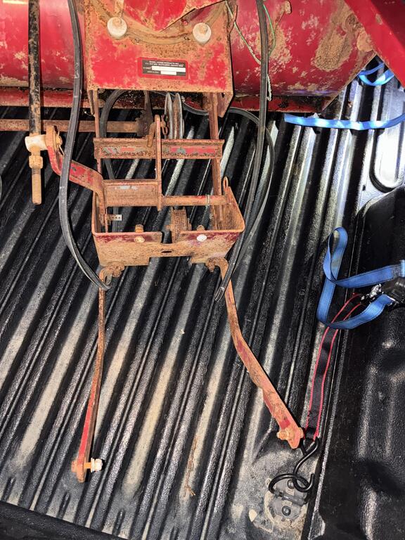

SamHit 0 #1 Posted 1 hour ago I got a snowblower in a trade, when I bought a c175. But I just can’t understand how it would be able to work with any machine, let alone the c175. I’ll include some photos. The belt seems to be centered, while all the wheel horses have the pro for the belt coming down from the side of the machine. Share this post Link to post Share on other sites
wallfish 20,147 #2 Posted 1 hour ago Wrong blower for your tractor. That blower is designed for a vertical shaft tractor and will not work on a HZ shaft tractor without modifications. Share this post Link to post Share on other sites
Ed Kennell 46,456 #3 Posted 58 minutes ago 24 minutes ago, wallfish said: will not work on a HZ shaft tractor without modifications. And those mods are not minor. There should be plenty of correct blowers for sale in your area for around a $100. Maybe another trade deal. Share this post Link to post Share on other sites
