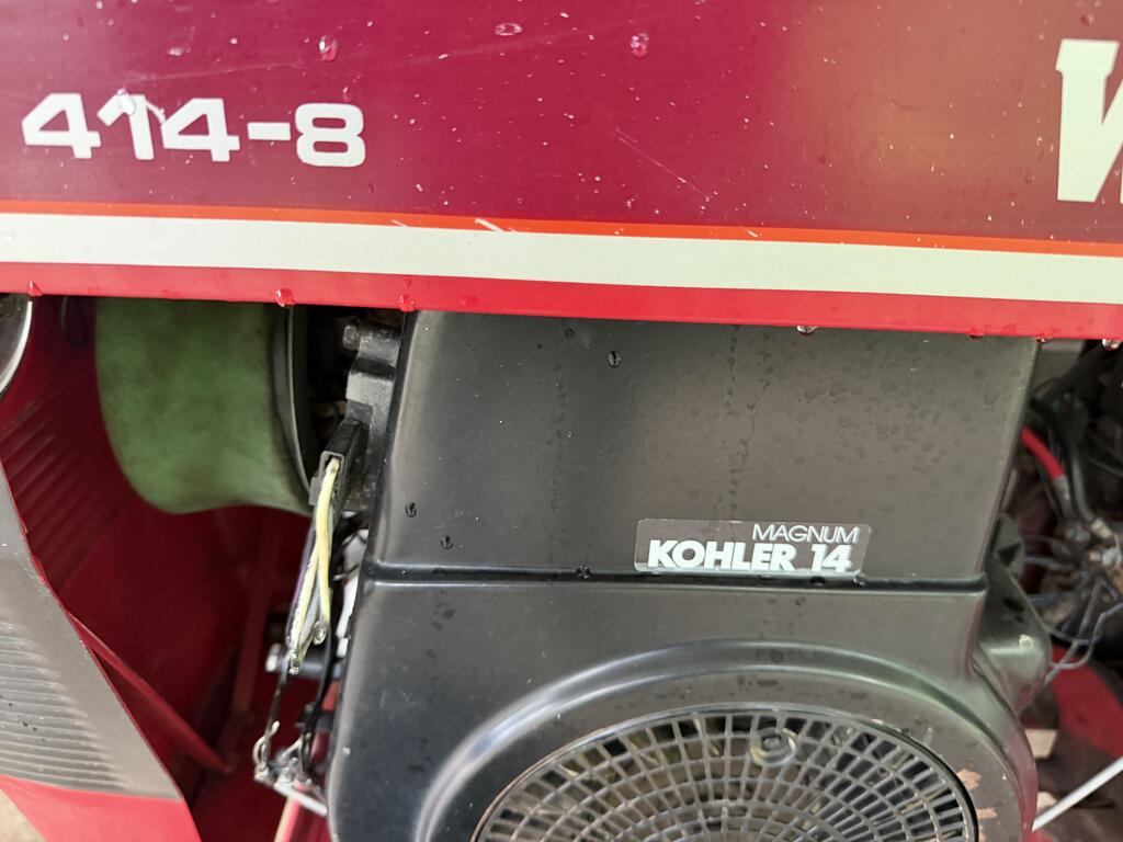

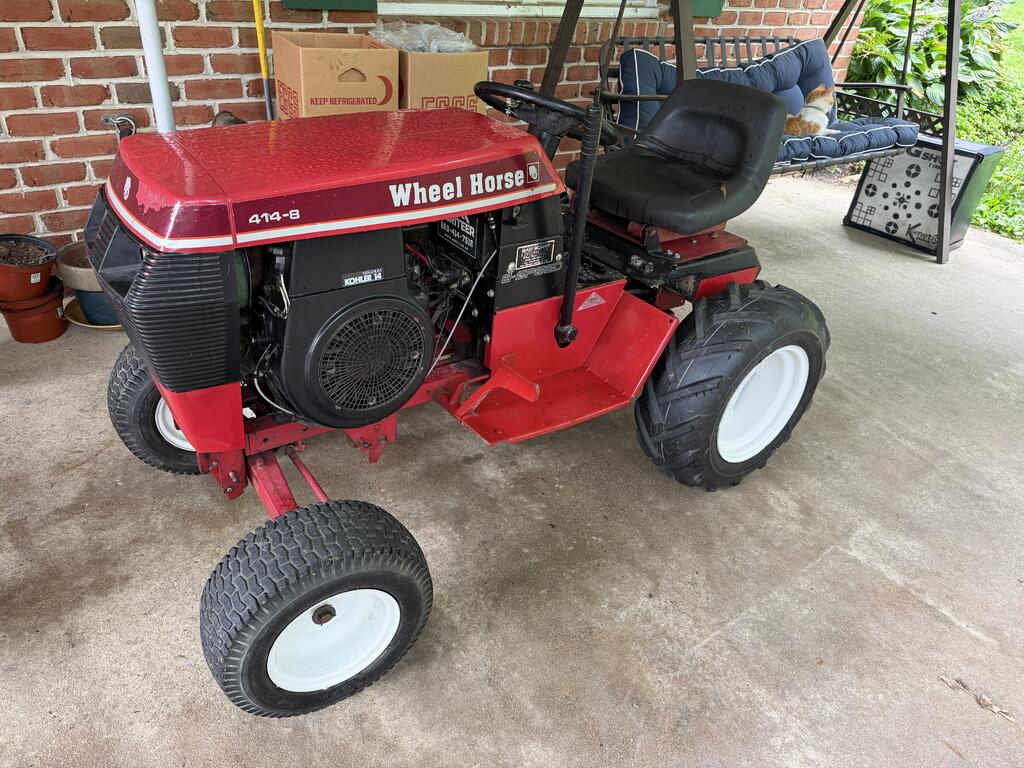

Hi,
I bought a Wheel Horse tractor yesterday for $500.
I looked all over the thing and can't find any plate or serial number.
Can you help me identify it by its features in the photos?
Or tell me where I can find the serial number or year information?
Thanks!

  That’s a 1987-1989 414-8.
 The data on those year’s was on a decal on the rear fender which you don’t have.
 Very capable rig…I have the same machine here.

Check this out comment #7 to narrow down your model year based on the engine numbers
Since you have a magnum engine on there it appears if the engine is original its a 87-89 model year
The model is the 414-8 which is the 400 series 14 hp and 8 speed manual

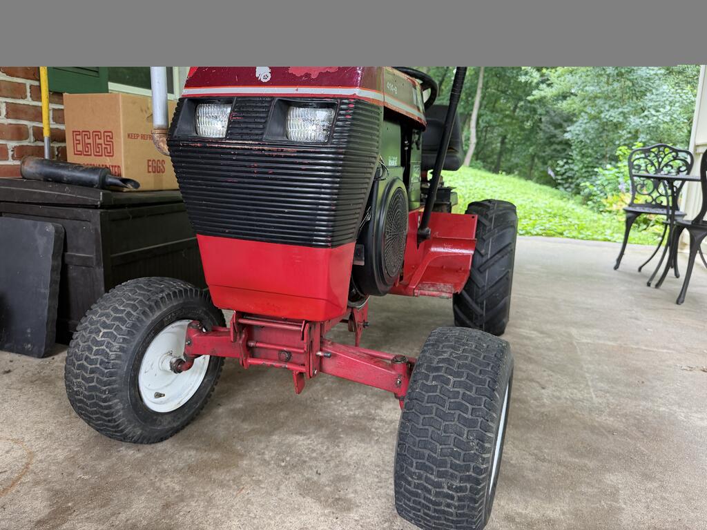

I have the same  tractor mine is a 1989, you also have the air filter cover missing.

If you post the Kohler serial number it may help to identify the model year of the tractor.
