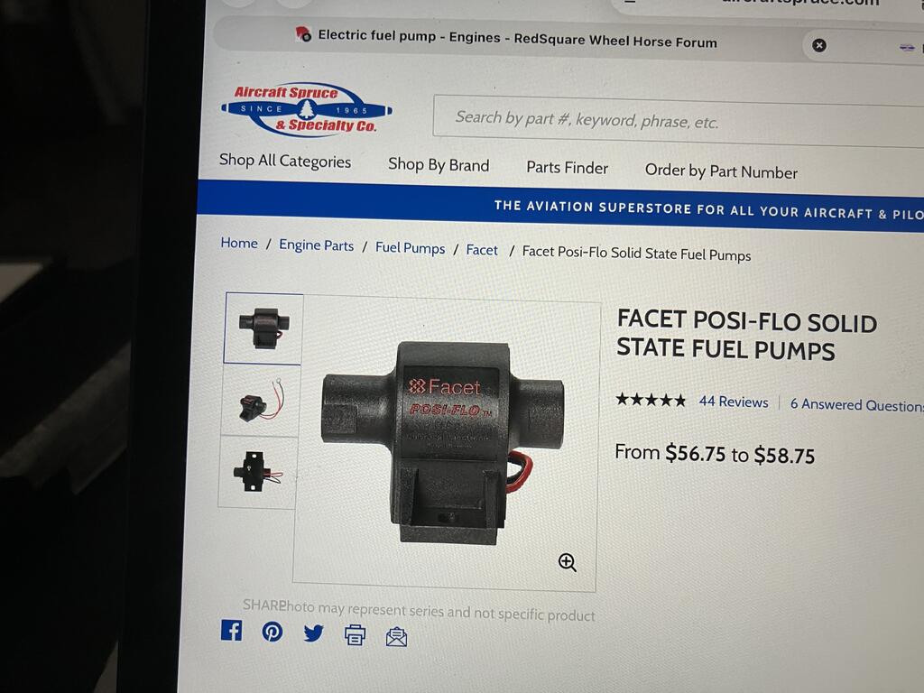

953 nut 69,242 #10 Posted July 11 I am an advocate of using an electric fuel pump. This is a pump many of us use and like very well. They can be found on for about $ 25.00 1 1 Share this post Link to post Share on other sites

sqrlgtr 3,911 #12 Posted July 11 I have used both of these and prefer the all metal one because of the smaller physical size, not much but is smaller. Share this post Link to post Share on other sites
