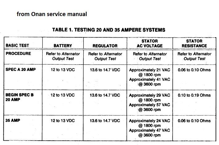

I've got a 416-H with the Onan engine. The battery is not charging. I measure about 12.45 at the battery whether it is running or not. I get the same voltage at the regulator output with the engine at full throttle, so it is not charging the battery. I've cleaned and tested the connections and run through the diagnostics as explained in the topic below. It appears that my voltage regulator is not working. I noticed, however, that my AC voltage across the regulator terminals measures about 52 volts AC. Is this normal and will this cause the rectifier to go bad? And why would it be so high? I haven't found any mention of anything like this in the forums.
