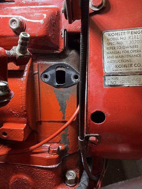

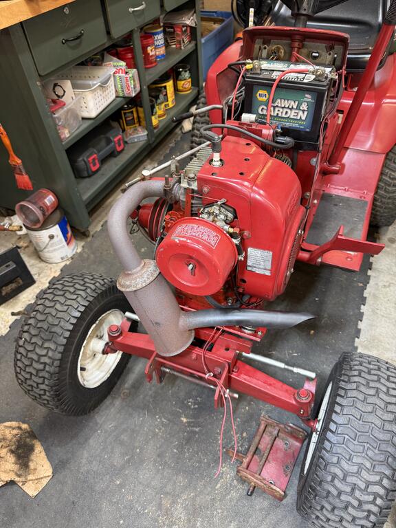

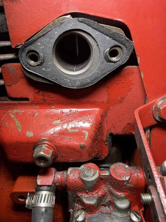

  Well my new C-81 from the Wheel Horse Show had a pretty good oil leak that I didn’t notice at first. Showed up after a 20 minute drive.

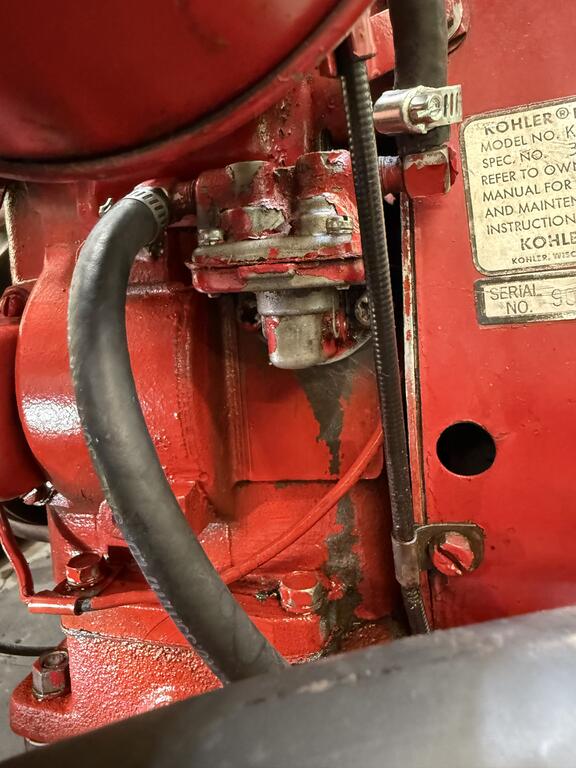

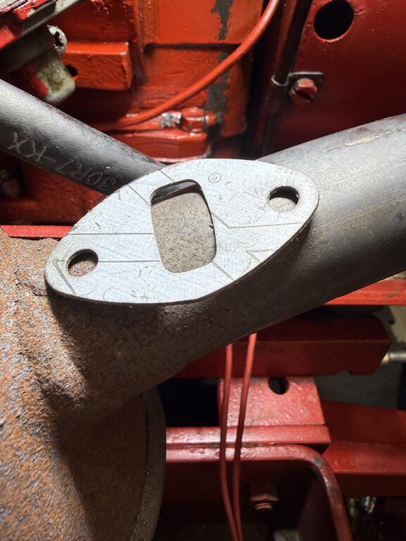

  Turned out the fuel pump gasket was on UPSIDE DOWN! Had a new gasket here in stock and it was an easy fix. I don’t have a gasket for the carb to engine block as that one isn’t correct, but it does seem to seal.
 Any reason I need to do the carb gasket???

if you are going to run her long and hard you might want to get the correct gasket as it insulates the carb from engine heat.  Honestly I have several engines with whatever gasket i could find and haven't had issues but most are limited duty.
If you can get that one to reseal and set exactly where it was, it'll be fine for now.

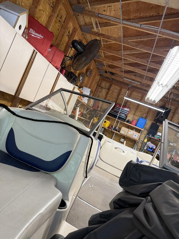

Garage is 28’x36’ (1008 sq/ft) and not insulated…how big an AC unit ya think I need :lol:.

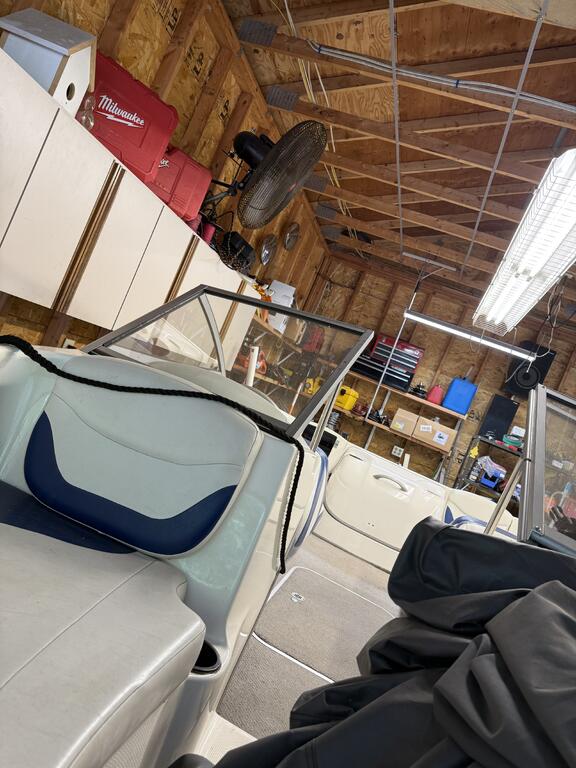

 I do have this industrial/oscillating fan cranking away…helps some.
  And before all the comments about “go boating” :lol:…the local lake is a zoo being a holiday weekend and they shut down the boat launch.
Plus my wife had knee surgery and she wouldn’t be able to climb in and outa the boat.

Mike - I agree it can be resealed - either with Permatex #2 - the non hardening stuff, or a smear of heavy grease.
FYI when I get a new to me WH and the carb is removed, I use the Permatex #2 to "glue" the new gasket to the engine and apply the light coat of grease to the carb mating flange. Makes carb removal easy down the road...

 I still chuckle when I think about that carb gasket on the C-81 you bought off me. Bizarre that it even fired and ran!

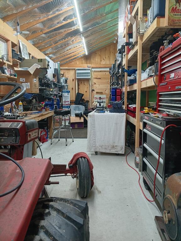

That's about what we have in the workshop space. Permanently mounted in the back wall.
10 x 40 ft. Very light insulation (the silver stuff).
The room is as airtight and rodent resistant as we could do.
Because of my body issues I can't take the combination of heat and humidity. Anything above 80⁰ and mild humidity and I'm just absolutely spent.

I wouldnt worry about (if it seals up right) but have one on hand fer next time ya have carb off...

yeah I try and keep a few small block and big block carb to block gaskets on hand.

New gaskets or old carb gaskets, I use a tiny bit of silicone gasket sealer. Never had one leak, and the excess wipes off easily after all the bolts get torqued. Just a little insurance... :thumbs:
