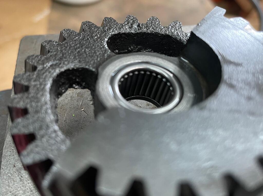

eo1bart 54 #5 Posted July 5 (edited) After disassembly and taking measurements, I decided to go with the full rebuild kit. (Standard size). Just ordered it off ebay One other question, Yay or Nay on reinstalling the balance gears? Edited July 5 by eo1bart 1 Share this post Link to post Share on other sites
WHX?? 58,387 #6 Posted July 5 4 hours ago, eo1bart said: Yay or Nay on reinstalling the balance gears? No brainer Bart leave them out and I can say I am speaking for the rest of us here. Just out of curiosity what did the bearings in them look like? Share this post Link to post Share on other sites
JoeM 10,318 #7 Posted July 5 1 hour ago, WHX?? said: leave them out should you do that in a magnum? Share this post Link to post Share on other sites
eo1bart 54 #8 Posted July 5 (edited) 2 hours ago, WHX?? said: No brainer Bart leave them out and I can say I am speaking for the rest of us here. Just out of curiosity what did the bearings in them look like? The bearings and everything else in the crankcase were in excellent condition Edited July 5 by eo1bart Share this post Link to post Share on other sites
