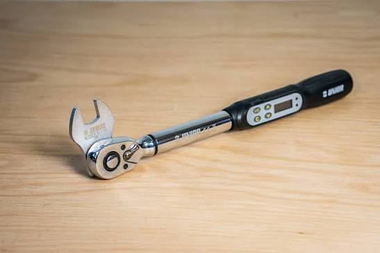

pfrederi 21,136 #11 Posted July 4 Slightly off topic ...I know when you use a crowfoot on a torque wrench facing forward yo have to adjust the torque setting. If you have it to the side as in the picture do yo have to make an adjustment?? 3 Share this post Link to post Share on other sites
ebinmaine 80,572 #12 Posted July 4 37 minutes ago, pfrederi said: Slightly off topic ...I know when you use a crowfoot on a torque wrench facing forward yo have to adjust the torque setting. If you have it to the side as in the picture do yo have to make an adjustment?? I was taught that a crowfoot ALWAYS uses different readings. Rotation position didn't matter. I use one so little that I have to look it up every time. Share this post Link to post Share on other sites

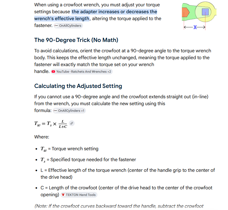

pfrederi 21,136 #14 Posted July 4 Found this if you trust AI 3 Share this post Link to post Share on other sites
