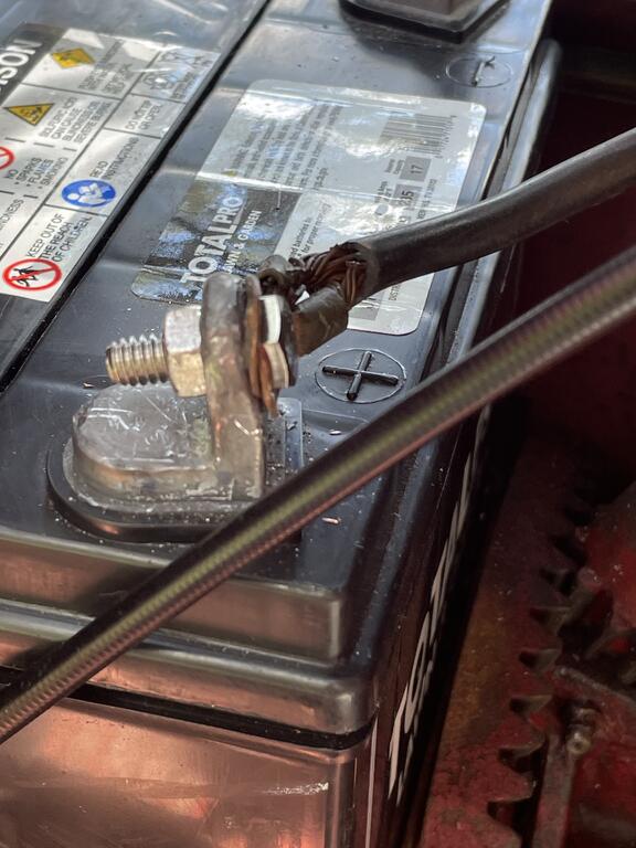

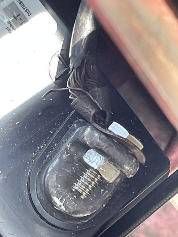

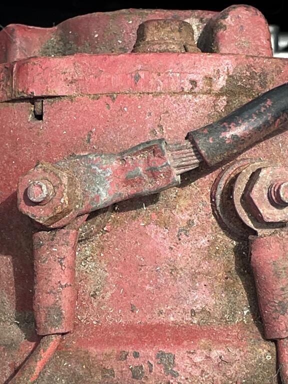

FLtractor 223 #1 Posted July 2 (edited) Afternoon, My 856 started ran drive on Sunday… since then I moved the ignition to a new dash hole so it’s not loose.. raised tank up. Added inline fuel shutoff valve.. added proper fuel hose clamps.. attached air filter, checked engine oil level and smell. Went to start it up today and cranked briefly then didn’t even wanna turn over just sounded like a fart of air from the starter. I checked connections.. positive cable at ignition somewhat loose so I tightened it up.. didn’t fix it. Battery fully charged. Could these cables corrison fraying be the issue that Started other day now not at all. Edited July 2 by FLtractor Share this post Link to post Share on other sites
702854boy 1,149 #2 Posted July 2 I'd start with checking all your grounds and redoing the battery cables. That positive cable looks like it needed replaced 20 years ago. 5 1 Share this post Link to post Share on other sites
pfrederi 21,150 #3 Posted July 2 Ar least take the wires off the S/G and clean them up. are you using teh original heavy duty switch with 3 terminals ...Make sure you check them for tightness 2 Share this post Link to post Share on other sites
squonk 48,119 #4 Posted July 2 Those cables are junk. A starter gen takes about 60 amps to start turning the engine. And you need clean grounds including where the gen and gen bracket mounts. 3 1 Share this post Link to post Share on other sites

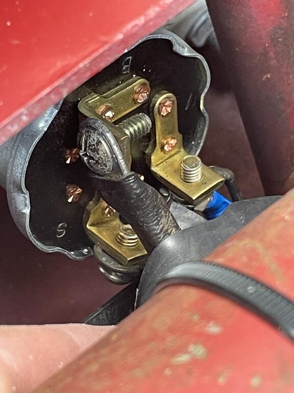

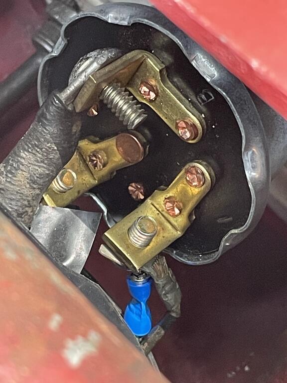

pfrederi 21,150 #7 Posted July 2 Please post a picture of the back of your ignition switch. For cables 6ga is adequate (4 ga better) but you need small terminal lugs 1/4" 2 Share this post Link to post Share on other sites
FLtractor 223 #8 Posted July 2 7 minutes ago, pfrederi said: Please post a picture of the back of your ignition switch. For cables 6ga is adequate (4 ga better) but you need small terminal lugs 1/4" Share this post Link to post Share on other sites
pfrederi 21,150 #9 Posted July 2 You need 1/4" or 5/16 terminal lugs. They can be a bit harder to find...but if you try to use the more common 3/8 you have to be very careful about putting then on the ignition switch that they do not touch something other than the terminal and you will need a couple washers so the bolt head does not slip through. 1 Share this post Link to post Share on other sites

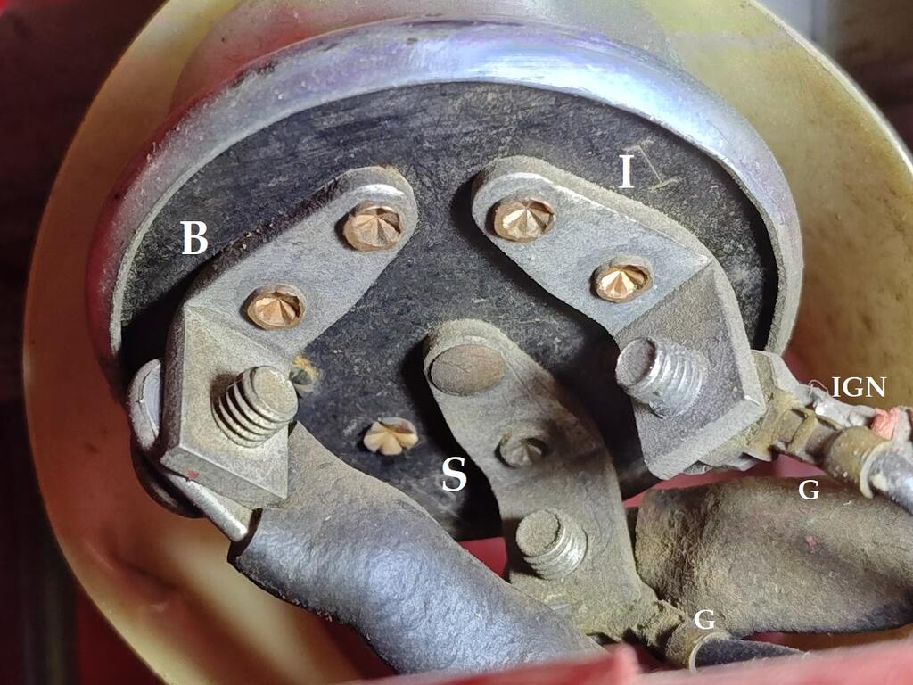

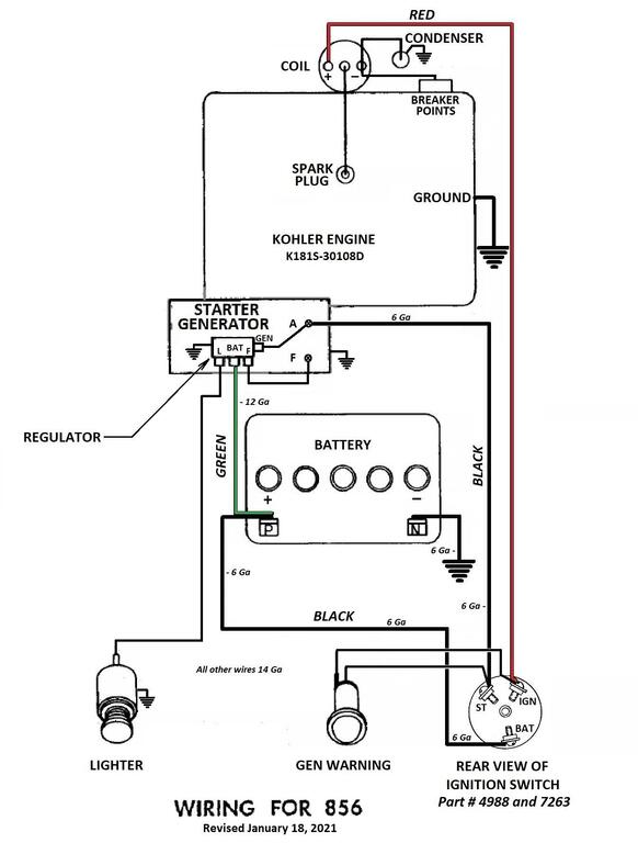

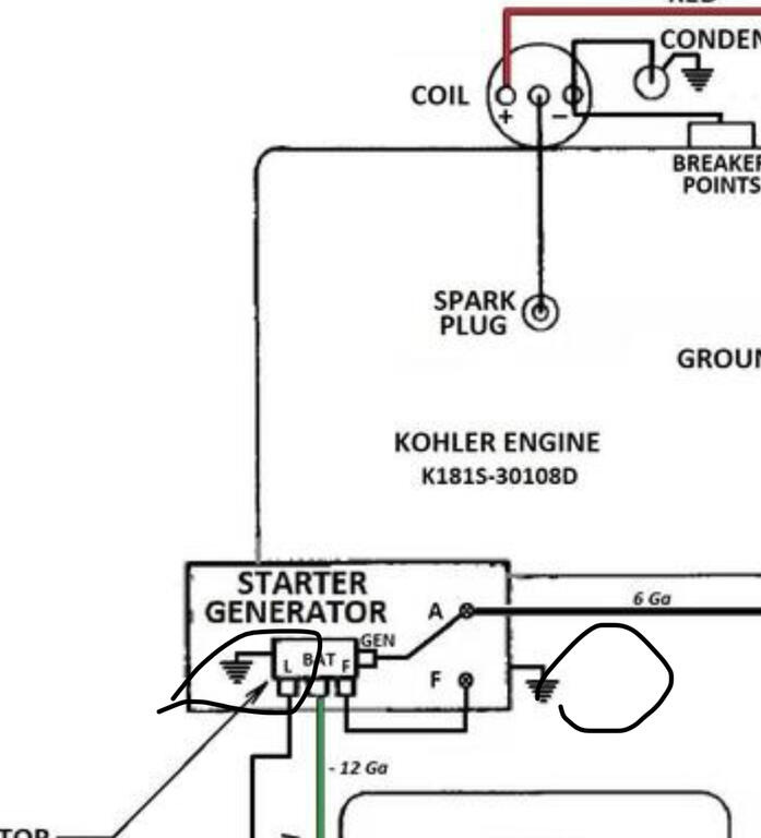

rmaynard 17,582 #10 Posted July 2 I can't see all the wires, but if it is wired like it shows on the diagram below, everything should be fine, Share this post Link to post Share on other sites
Thegearhead0324 1,842 #11 Posted July 2 1 hour ago, FLtractor said: Any recommendation on which brand or replacement battery cables I should get? I’ll just get new ones I just went to the local parts store for different length cables, although I had to cut and crimp my own ends anyways, no brand specific. Share this post Link to post Share on other sites
FLtractor 223 #12 Posted July 2 19 minutes ago, rmaynard said: I can't see all the wires, but if it is wired like it shows on the diagram below, everything should be fine, What are these 2 triangle arrows representing? Share this post Link to post Share on other sites
Thegearhead0324 1,842 #13 Posted July 2 2 minutes ago, FLtractor said: What are these 2 triangle arrows representing? those are the grounds. Share this post Link to post Share on other sites
rmaynard 17,582 #14 Posted July 2 This is the back of my 857. B - Battery I - Ignition S - Starter G- Generator light IGN - to ignition coil 1 Share this post Link to post Share on other sites
FLtractor 223 #16 Posted July 2 17 minutes ago, rmaynard said: This is the back of my 857. B - Battery I - Ignition S - Starter G- Generator light IGN - to ignition coil What does the G stand for on your 2 cables here? Share this post Link to post Share on other sites

oldlineman 1,809 #24 Posted July 3 (edited) Looks like PO didn't have the right size barrel lug so they split cable and used two smaller lugs. In itself is not bad but would not use for permanent connection. Reason being more contacts points, you are guessing size of barrel for conductor, and just not right.Just my option after working around electricity for over 50 years, although most was AC not DC, but many things very similar. Bob Edited July 3 by oldlineman 1 1 Share this post Link to post Share on other sites
