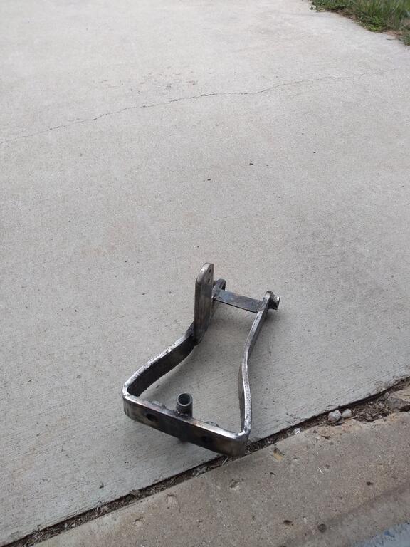

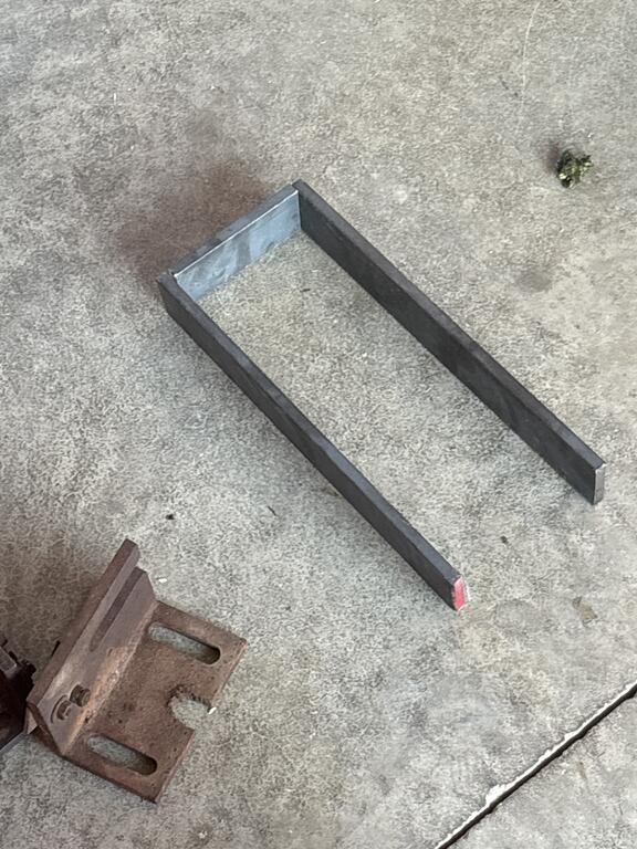

Handy Don 17,557 #4 Posted July 2 There can be a ridiculous amount of rotational torque on a sleeve hitch so be sure the cross-to-legs and sleeve-to-cross welds are some of your best work. That most of these are bent from straight bar stock is not an accident. 1 Share this post Link to post Share on other sites
AlexR 3,121 #5 Posted July 11 (edited) I thought I had posted about one I made but apparently not. The bolts are 1/2" bolts I forget how long probably 2 1/2" I do remember I used some steel pipe (like black pipe for gas and cut the threaded ends off) for the pipe piece you are talking about I believe it was 1/2" pipe you will have to measure ID to verify it's 5/8" you might still have to run a drill bit through to clean it out. Like has been mentioned I would recommend bending it, but looks like you are past that point. Edited July 11 by AlexR Share this post Link to post Share on other sites
