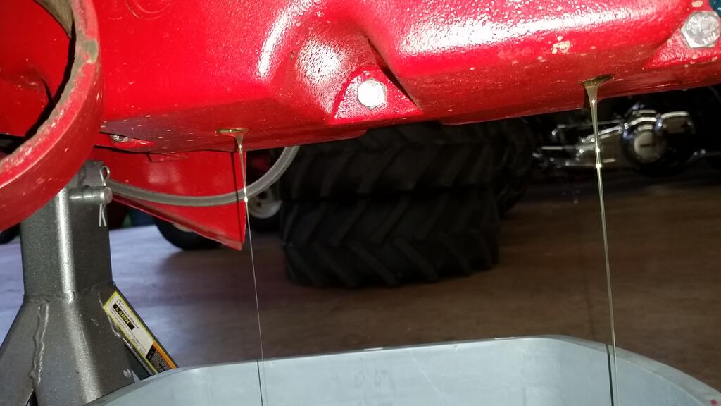

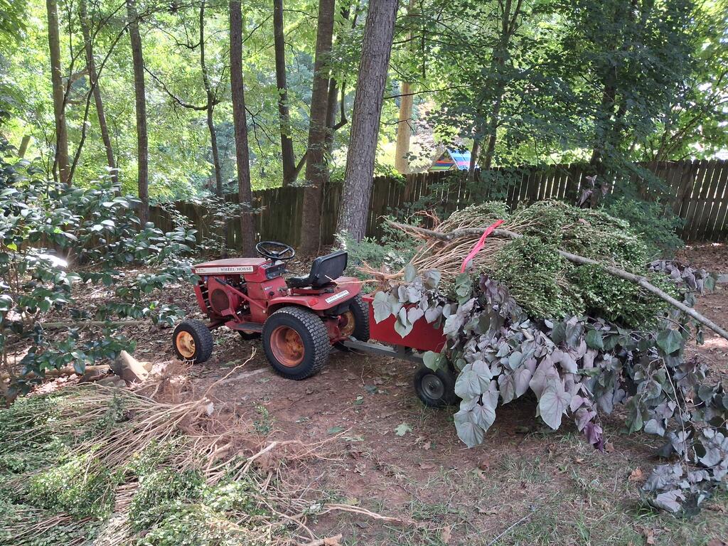

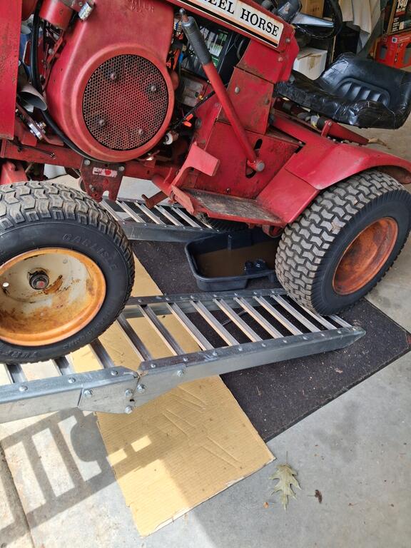

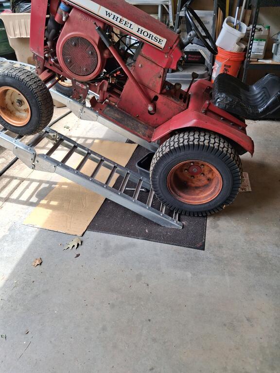

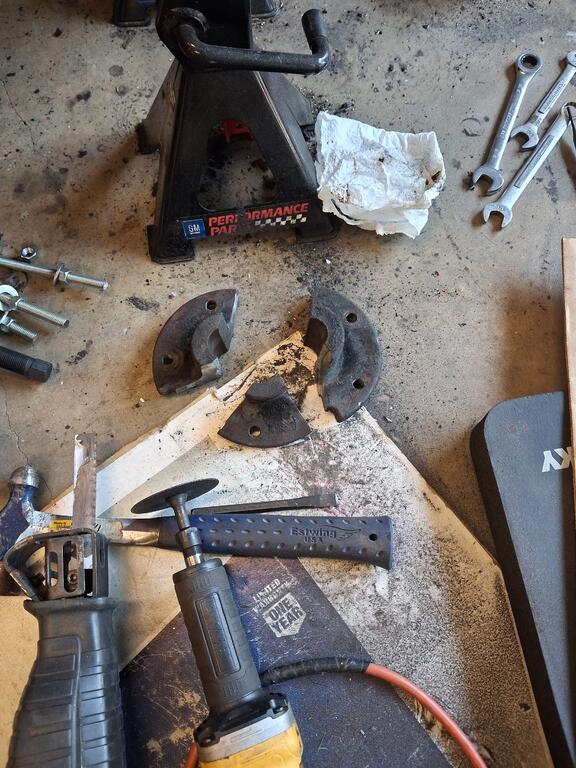

John c 222 #1 Posted July 1 The transmission on my C101 was really suffering from his past lifes adventures, missing the shifter boot, 3 of 4 seals leaked, and what oil was left in it was watery and milky brown after I got it all that squared away I mixed up some diesel fuel and a little bit of cheap 30wt and ran it for an hour or so to flush it out. The best way I found to get as much of the flush solution over the hump was to start it up the ramps. I was saving some pruning debris from a couple of weeks ago to have some "work" for it, I'm glad I got that machine and my yard work taken care of when I did. Heat index is 100* + in NE Ga. this week 2 6 Share this post Link to post Share on other sites

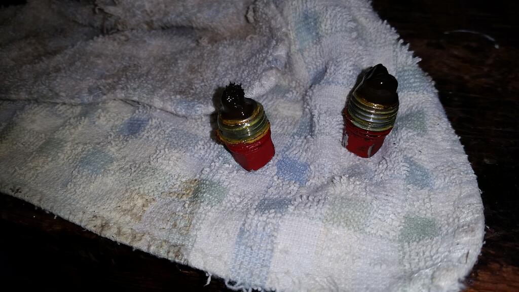

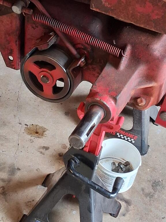

WHX?? 58,043 #2 Posted July 1 Good job John. SAFELY lifting the front up is something we always preach. I like to add a drain plug if I gotta tear into it and make my own magnetic drain plugs. 9 Share this post Link to post Share on other sites
