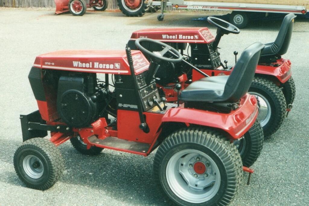

JCM 11,415 #2 Posted July 1 Back around the year 2000 I repainted this 1986 312-8 and installed OEM decals dry. Being older now I use either a small amount of Dawn dish shop mixed with water or my preferred method is Windex WITHOUT ammonia works very well. Patience helps a lot. Good luck 2 Share this post Link to post Share on other sites

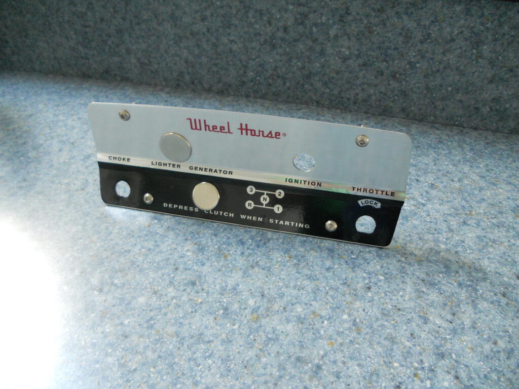

Racinbob 13,187 #4 Posted July 1 I believe you're talking about this style dash similar to the 500 Special I did. Terry's decals are typically very easy and forgiving to apply but these dash decals might be the toughest. Make sure the surface is prepared very well. The metallic decal will show any imperfection. I primed, sanded and cleaned it like I was going to apply paint. Since this decal is so different from the others I started at the bottom and slowly worked my way up fitting it tight to the ridge across the center. The credit card thing works very well although I used an AARP card. 3 3 Share this post Link to post Share on other sites

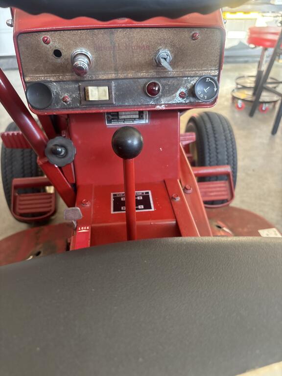

1968Commando 189 #6 Posted July 1 Thank you, yes this is my dash. This it what it looks like right now. Share this post Link to post Share on other sites

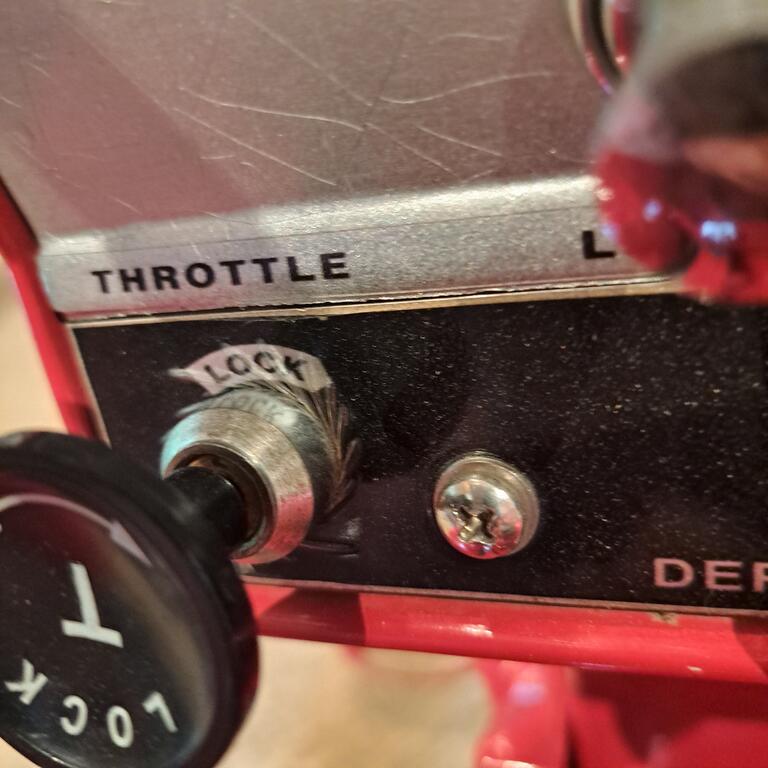

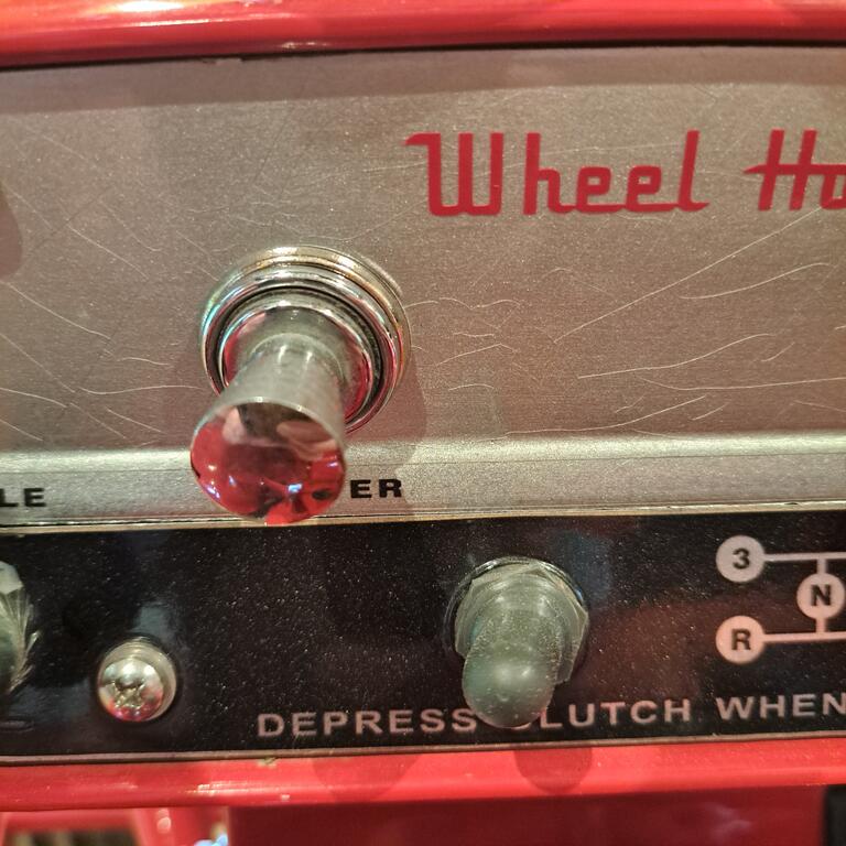

WHX?? 58,115 #9 Posted July 2 (edited) 1 hour ago, WHX?? said: funkyness going on with the dash on Radferd. So I don't what happened here. Looks worse in sunlight and I'm sure what with @Achto's analness for prepping it was done proper. Something else to watch for is don't rely on the D hole to keep the knob base from turning during tightening. I hate to tell you to clamp a vice grips on it. Will mar it for sure. Every one I have done did this you think I would have learned. Possibly cut the decal out from under the knob with an exacto knife so it doesn't set on the decal??? Same with the four corner screws and switches. Use plastic washers underneath. Looks like Dan cut the decal just above the black to silver transition. Edited July 2 by WHX?? 1 2 Share this post Link to post Share on other sites

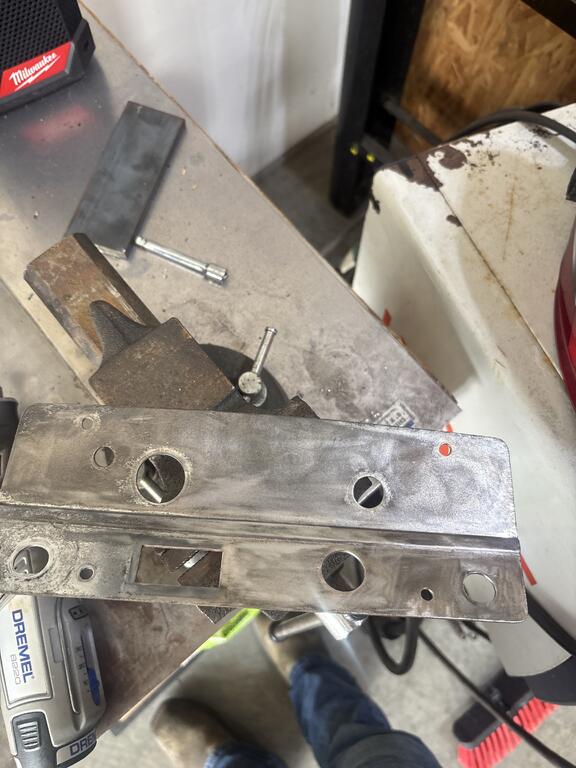

1968Commando 189 #14 Posted July 4 On 7/2/2026 at 9:37 AM, WHX?? said: Your not the first guy I heard that from Wrencher. Dan I noticed some funkyness going on with the dash on Radferd. Will get some pics. Your biggest chore is going to be removing everything to get the dash on the work bench Commando. Then having to put it all back together. Got it out. Share this post Link to post Share on other sites

1968Commando 189 #16 Posted July 4 Is this clean enough? Share this post Link to post Share on other sites

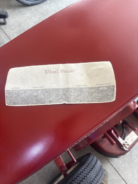

1968Commando 189 #18 Posted July 5 Yeah I got these decals a year ago 1 Share this post Link to post Share on other sites
Achto 32,687 #19 Posted July 6 On 7/2/2026 at 11:14 AM, WHX?? said: So I don't what happened here. I used Terry's 3 piece decal on that dash. The cracks you see are some issue with the silver and clear coat that I used on the dash before I put the decals on. Did not show up until a year or 2 later. Not super noticeable so I have not addressed it. 1 Share this post Link to post Share on other sites
