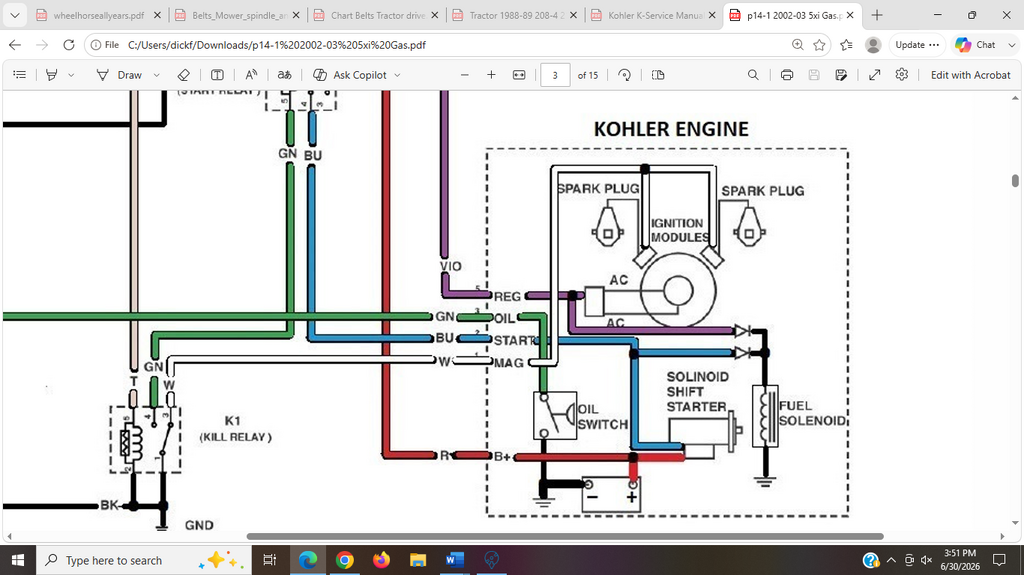

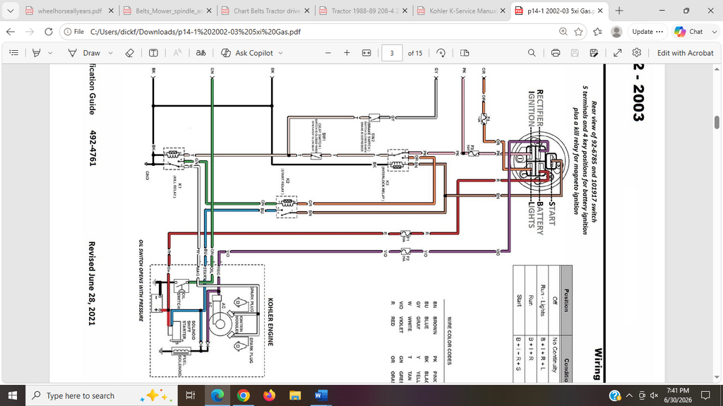

Will guess at this one. Download the file and in it is a diagram for just the ignition. Easy to follow.

953 nut
Your charging system has a diode that feeds the fuel shut-off solenoid while the engine is running. The solenoid is fed directly from the key switch in the start position.
Take a look at the VIOLET colored wired from the charging system to the fuel solenoid and its diode.

That system has been used by Wheel Horse for years, primarily on Briggs powered B & C series tractors.
Here is a thread I did a few years ago that shows how simple it is.

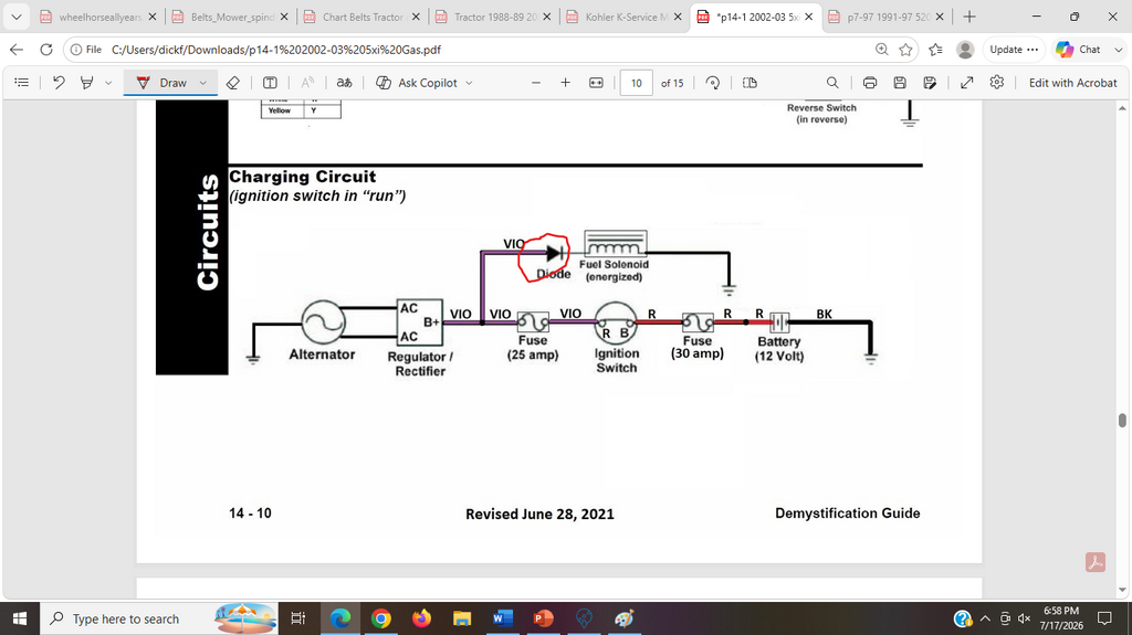

So I tested it last night and I have no voltage on fuel solenoid while in run position, and 11.93 vdc when cranking.
Where do I look next.
gwest_ca
The purple wire should have power with the ignition in the RUN position - engine does not need to be running.
There is a fuse in that wire so check that. You should have power both sides of the fuse. If not check connections at the ignition switch and possibly ignition switch failure. This circuit also charges your battery.
This is true IF the diode on the purple (Violet) wire to the fuel solenoid is good.
