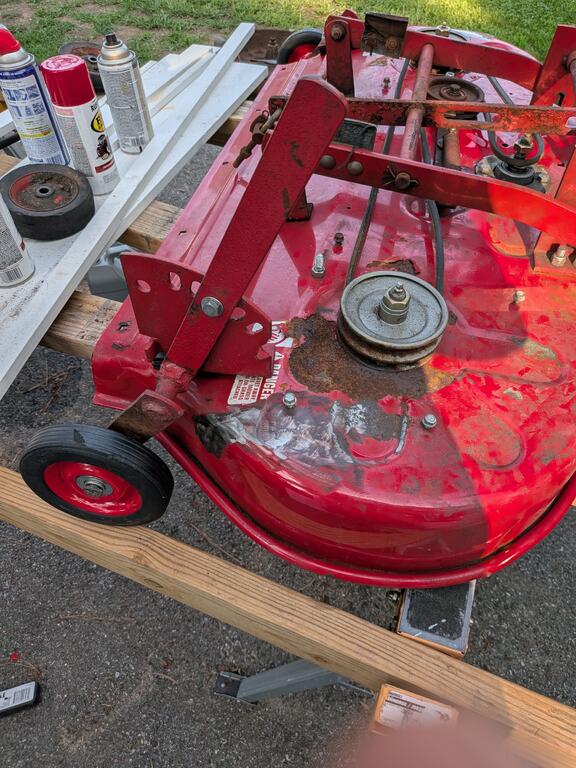

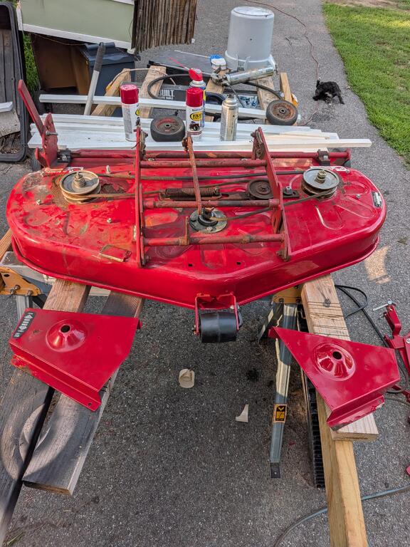

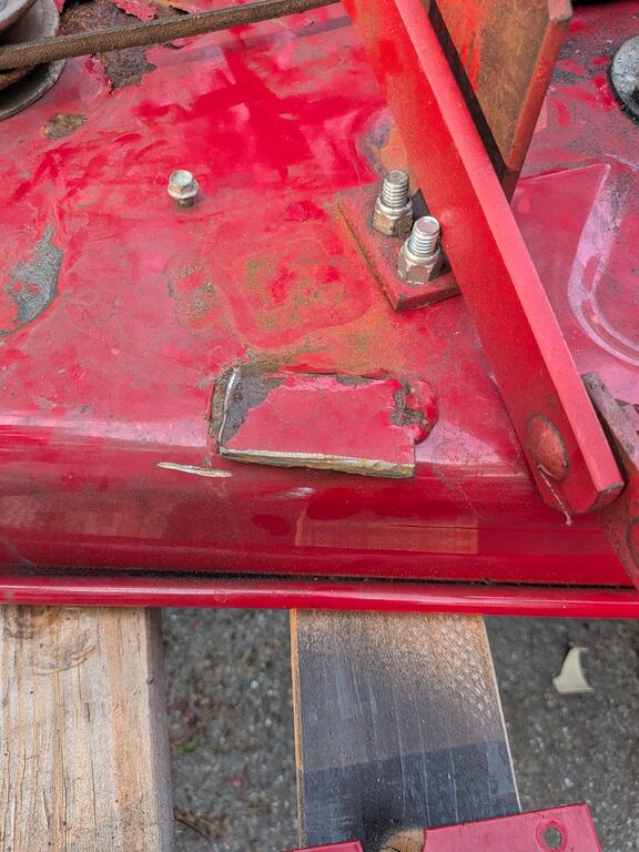

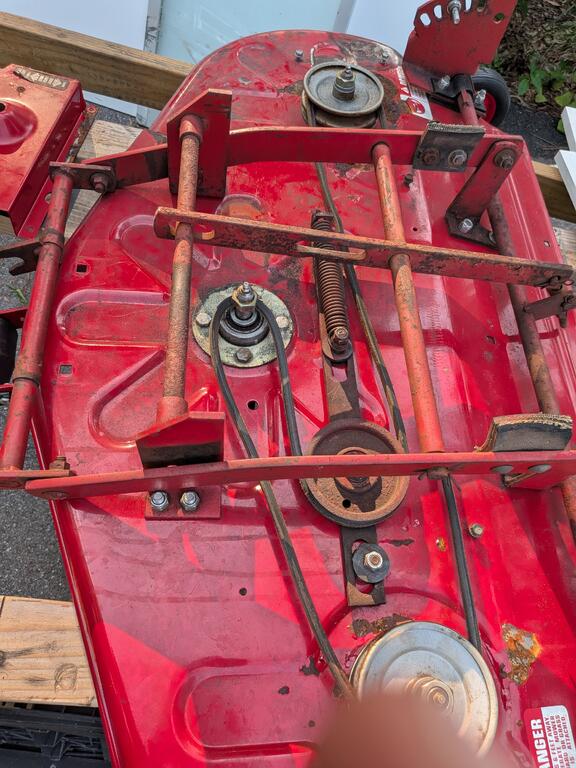

Tomk 4 #28 Posted July 19 Well it worked. The stamping is the exact same thing. I didn't have to drill one hole. I did have to cut off the height adjustment and I still have one tab on the front. I'm going to cut off when I blow apart the paint. Share this post Link to post Share on other sites

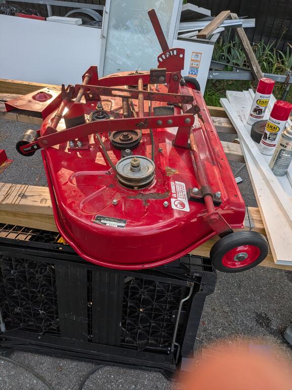

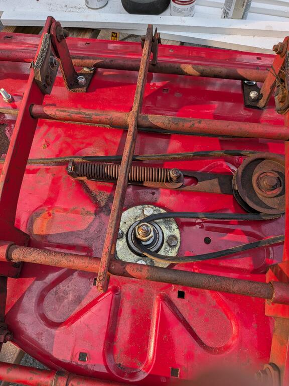

Tomk 4 #29 Posted July 19 I could still use some help. I've used the new spindles from the New Old stock mower deck. I want to set up a stacked center pulley like the original wheel horse. So from my understanding this Deck stamping is off of a 1990 600 series Toro zero turn 42-in rear discharge. I need a stacked pulley for the center anybody got any ideas? Otherwise I will figure it out. But happily everything else worked. Share this post Link to post Share on other sites
