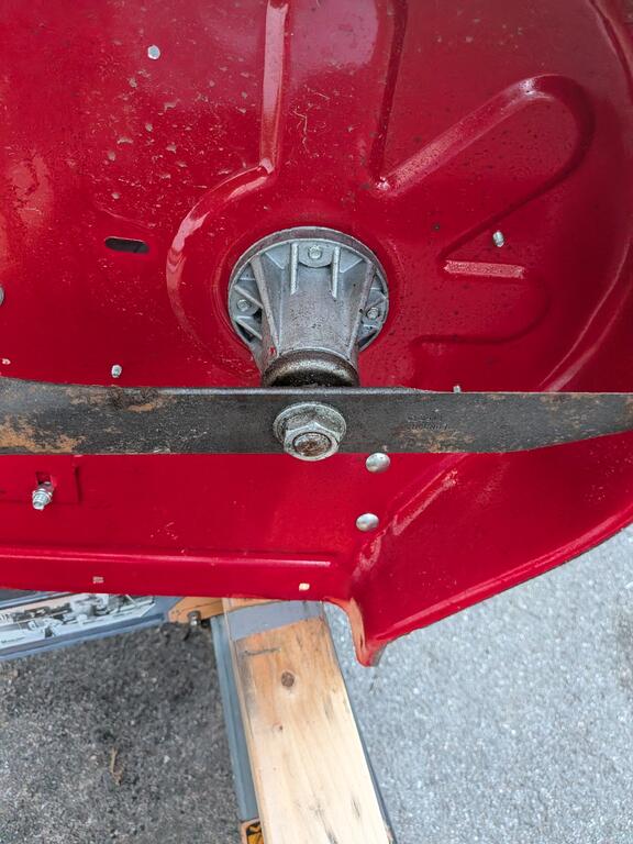

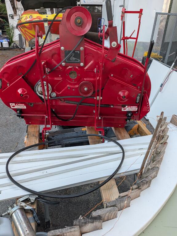

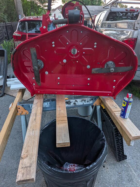

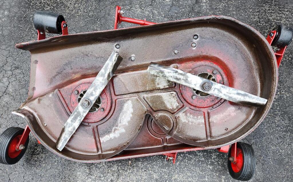

Tomk 4 #1 Posted June 30 So questions I found a new old stock 42 Rear discharge stamping. I'm going to switch everything over from my old deck that I need to convert this to what I need. The difficulty I see right now is I will have to get out the welder to attach the new rollers from my old unit. Anybody got any suggestions I'm open. My question is before I start I've already ordered a new spindle for the one that's missing. What can I do to make this last forever? What can I paint on the inside of it? What can I do to the spindles? Anyone have any suggestion? Changes blah blah blah? 2 Share this post Link to post Share on other sites
lynnmor 9,040 #4 Posted June 30 If you want it to last forever, build a ramp and run the tractor up so you can clean the deck completely after every mowing. Coat it with oil for long periods of storage. 3 1 Share this post Link to post Share on other sites
ri702bill 13,050 #6 Posted June 30 Tom - I do not see the area where to rollers are missing.... Preserving the underside - there are several methods. Some spray it with POR-15, some use spray-on truck bed liner, some do the used motor oil rub down & hot sun soak-in. I prefer to wash out the underside with a blast of the garden hose, run the deck after to move the water out, & let it sit in the sun to dry ANY time the grass is even the slightest bit wet. Keeping the blades sharp & the spindles greased is the key. 1 1 Share this post Link to post Share on other sites

peter lena 10,065 #9 Posted June 30 @Tomk picked up a very similar one year's ago , close to new , first thing i did ? clean out and re grease every related bearing with lucas , x tra hd green chassis grease , guess what ? never had any bearing whine / noise or failure , also did my mule drive bearings , and pto cone inner needle bearing . spin up is smooth quiet easy . if you don't do this now , rest assured , it will come back at you , have a regular usage / maintenance that has been bombproof , also zero deck rot , pete Share this post Link to post Share on other sites
lynnmor 9,040 #10 Posted June 30 13 hours ago, ri702bill said: Preserving the underside - there are several methods. Some spray it with POR-15, some use spray-on truck bed liner, some do the used motor oil rub down & hot sun soak-in. I prefer to wash out the underside with a blast of the garden hose, run the deck after to move the water out, & let it sit in the sun to dry ANY time the grass is even the slightest bit wet. Keeping the blades sharp & the spindles greased is the key. I have a zero turn with a standup deck that I clean every time. The ONLY time I had no significant buildup on the deck underside was the time I mowed with the grass sopping wet. Usually I need to do considerable scraping with a sharp putty knife and mowing when very dry doesn't have a lot of buildup but it takes more effort to remove the hardened stuff. 1 Share this post Link to post Share on other sites
Tomk 4 #11 Posted July 4 On 6/30/2026 at 8:23 AM, peter lena said: @Tomk picked up a very similar one year's ago , close to new , first thing i did ? clean out and re grease every related bearing with lucas , x tra hd green chassis grease , guess what ? never had any bearing whine / noise or failure , also did my mule drive bearings , and pto cone inner needle bearing . spin up is smooth quiet easy . if you don't do this now , rest assured , it will come back at you , have a regular usage / maintenance that has been bombproof , also zero deck rot , pete Thank you very much. I think I'm going to follow that advice. Share this post Link to post Share on other sites
peter lena 10,065 #12 Posted July 5 @Tomk thanks for the shout , all those bearings have , easily removable grease side shields , small flat pocket screwdriver , or smallest flat putty knife , they are always reusable . be delicate , wipe out original , lube, carb cleaner flush, then hand pack every related bearing ,replace shields , reinstall. its the hi stress / heat rating that insures bearing life , when a bearing starts to WHYINE , WITH DRAG NOISE , its telling you its LUBRICATION is failing , none of my tractors do that . that pto inner needle bearing , also needs a careful clean out , same lubrication failure , VEY LIGHT AMMOUNT OF LUCAS GREEN , excess flings to clutch facing , want to avoid that , spin that up by hand to verify , total ease of movement , we are at opposite ends of the maintenance zone , so we both see , something different , I also picked up a very low hr , deck years ago , did the very thing I am suggesting , never had any related failure on it , glad for you , pete Share this post Link to post Share on other sites

Handy Don 17,474 #16 Posted July 7 18 hours ago, Tomk said: However, I was watching a video the other day and they removed and left off The inside dust cover from the bearings so that when grease was pumped into the fitting it could enter the bearings. There are valid arguments for and against this. I fall in the “get good sealed bearings, confirm good grease is in there, and leave them sealed” group. This might involve injecting a known quality grease myself before installation. Keep in mind that a good bearing does not have to be packed solid with grease, in fact solid packing is not advisable since it can obstruct the bearing carriage. My objections, to the “leave one side unsealed” option are that it is hard to know if grease is really reaching the bearings, Interior voids in the fixture may need a LOT of grease, there may be openings where grease can escape and cause a mess, and does “old” grease actually leave the bearings to be replaced by “new” grease (and where does the old grease go, anyway?). 1 Share this post Link to post Share on other sites
953 nut 69,285 #17 Posted July 7 On 6/29/2026 at 8:33 PM, Tomk said: What can I paint on the inside of it? I applied truck bed liner on my deck about nine or ten years ago and it is holding up well. 1 Share this post Link to post Share on other sites
Tomk 4 #18 Posted July 7 26 minutes ago, 953 nut said: I applied truck bed liner on my deck about nine or ten years ago and it is holding up well. Thank you very much. That's what I'm thinking about using. 6 hours ago, Handy Don said: There are valid arguments for and against this. I fall in the “get good sealed bearings, confirm good grease is in there, and leave them sealed” group. This might involve injecting a known quality grease myself before installation. Keep in mind that a good bearing does not have to be packed solid with grease, in fact solid packing is not advisable since it can obstruct the bearing carriage. My objections, to the “leave one side unsealed” option are that it is hard to know if grease is really reaching the bearings, Interior voids in the fixture may need a LOT of grease, there may be openings where grease can escape and cause a mess, and does “old” grease actually leave the bearings to be replaced by “new” grease (and where does the old grease go, anyway?). I can see all of your points. The guy in the video his theory was that the grease warmed up during operation and would flow around Share this post Link to post Share on other sites
Brockport Bill 2,478 #19 Posted July 8 I agree with many of the prior comments which are more about deck maintenance after use rather then some type pre-use preparation -- Yes, you can use various underneath shell surface treatments but i believe its the underneath maintenance over the years that is more important -- i see photos of decks for sale that have had almost NO grass cleaning --- thick buildup to make me wonder sometimes how the blades even spin or how grass gets discharged ?? i suggest sharp blades - don't mow wet grass which sticks to shell - run throttle at top rpms - and clean underneath regularly -- either pressure wash, hose - putty knife etc --- and routinely rub or spray on some type non stick treatment - Fluid Film spray, WD 40, or some people just use motor oil - new or used? ( see photo ) Also clean loose grass debris off top of deck cleaned from pulley covers and around pulleys and belts - reduces friction wear and tear and rot - and don't leave tractor/deck outside to prevent water rotting top of deck -- Lastly, if you do not have deflector flange for rear discharge - suggest, you get some vinyl base cove molding and attach with carriage bolts - that will help keep rear underneath of tractor cleaner good luck Share this post Link to post Share on other sites
Handy Don 17,474 #20 Posted July 8 (edited) 14 hours ago, Tomk said: The guy in the video his theory was that the grease warmed up during operation and would flow around Did he supply proof of this theory? Might be valid as long as you know both the expected operating temperature and that the grease will flow and retain its lubricating quality at that temperature. I’m no grease expert, though. Edited July 8 by Handy Don Share this post Link to post Share on other sites
Tomk 4 #21 Posted July 9 12 hours ago, Handy Don said: Did he supply proof of this theory? Might be valid as long as you know both the expected operating temperature and that the grease will flow and retain its lubricating quality at that temperature. I’m no grease expert, though. Absolutely not and that's why it's just a theory for me. It seems odd that they put a grease fitting on something that has sealed bearings just makes you feel better that you go out and grease your mower. What is the grease fitting for Share this post Link to post Share on other sites
Handy Don 17,474 #22 Posted July 9 11 hours ago, Tomk said: Absolutely not and that's why it's just a theory for me. It seems odd that they put a grease fitting on something that has sealed bearings just makes you feel better that you go out and grease your mower. What is the grease fitting for And how many owners of machines with zerks: a) know what a zerk is, and b) have a suitable grease gun that they know how and when to use?! No mystery that the block that holds both the upper and lower steering shafts on a WH is so often lacking lubrication! Share this post Link to post Share on other sites
