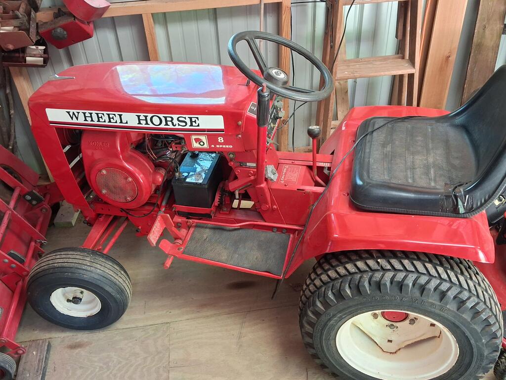

10 minutes ago, Natejc_98 said:
Were this all the original parts restored? Or did you purchase aftermarket?
No not all the parts are restored. That is a very hard thing to accomplish when tractors are well used and in rough shape.
Get better original used parts if you need them, use the original carb if possible. @ebinmaine can help you with the carb when you get there.
A lot of times when restoring these old tractors, a lot of us like to make some things better one example would be the tierods, making some using heim joints which is what I did. Another upgrade I did that was not model/year correct was put different front axle pivot plate that allows the newer mower decks and snowblowers using the attach-o-matic system to be installed.
Your tractor already has that as it's a 73' which is the first year for that.
In the end what we most like seeing is a tractor running and driving again and being used preferably with a Kohler engine.
Don't be afraid not to keep it 100% original, especially if it's your first go at it.
Your biggest hurdles in disassembly if you are taking it all the way apart will be- rear hitch pin, rear hubs, and separating the steering wheel from the steering shaft.
Things to check for high wear- front axle spindles, the main pivot on the axle, tierods, check the steering block the steering wheel shaft goes to right behind the battery for cracks and wear, the f-plate of the frame to the transmission for cracks around the 4 bolts from that plate to the transmission, and the rear axles/hubs keyways.

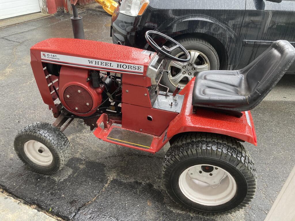

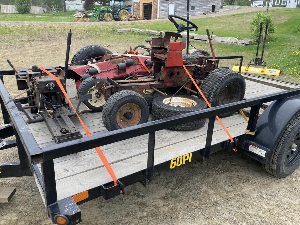

@AlexR  Heckova transition there. Love those before n after pics!
