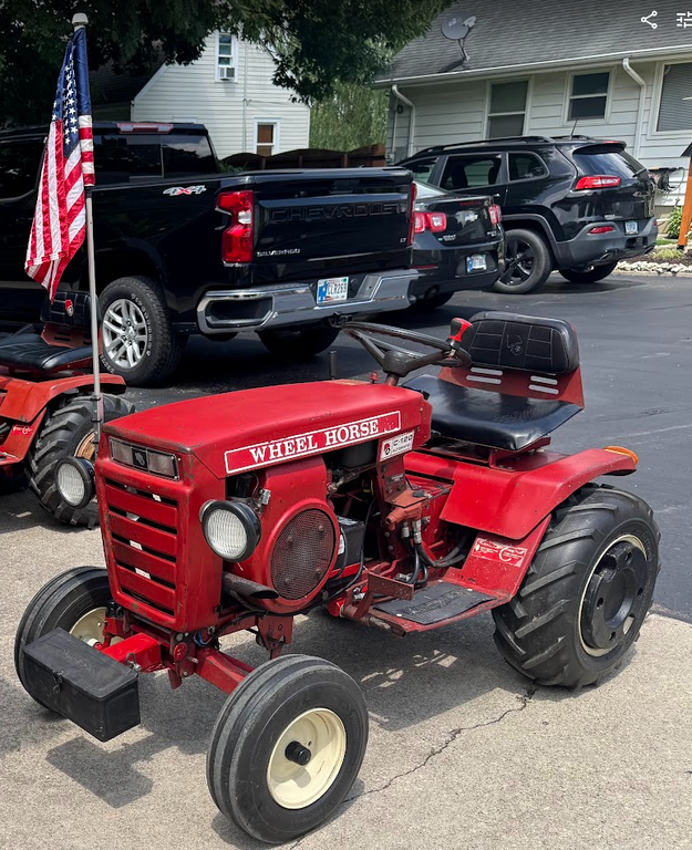

Bar Nuthin 3,642 #1 Posted June 29 (edited) My neighbor volunteered me to ride in a 4th of July parade, but the temperature is supposed to be around 100° F. How concerned should I be about my K301 overheating - or suggestions on best RPM or other tips on running the engine? Or should I just opt out? Edited June 29 by Bar Nuthin Share this post Link to post Share on other sites
