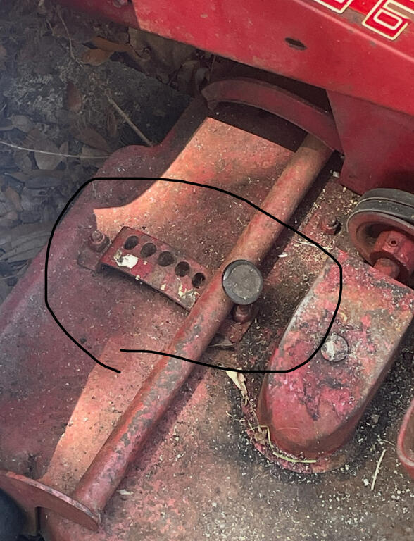

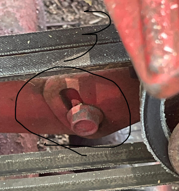

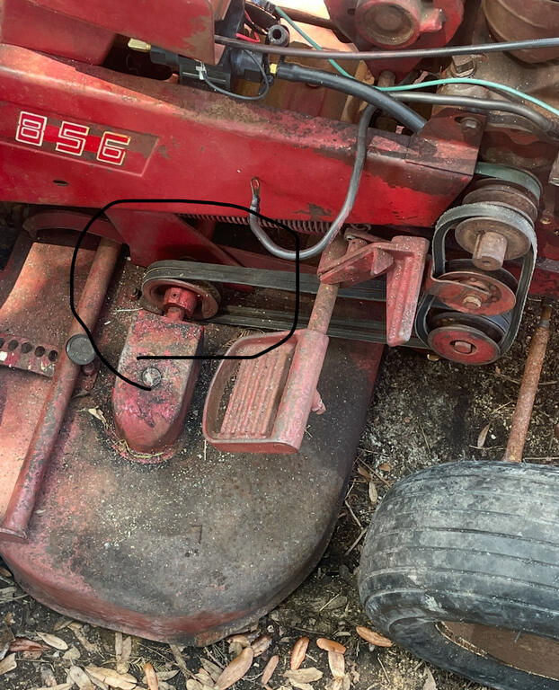

FLtractor 240 #4 Posted June 28 (edited) 18 hours ago, adsm08 said: It's pretty easy, even easier with two people. Step one, very important this is done first: Slip the belt from the engine off the deck pulley. 2: remove the lift link. 3: Release the retaining forks at the front of the tractor. 4: Turn wheels all the way to the right, pull deck out from the left. It helps to rock it up to the right a bit so the lift link clears under the frame. That's where the second person comes in. Thank you. So after looking over my tractor today. Before I attempted remove and make more work for myself. I’ve taken pictures of what I believe are the steps you mentioned. 1. Is this the Deck belt I need to slip off the deck. From this circled end? Where would it slip off at if the gear box is in the way? 2. Is this the lift link I need to pull up And remove off tractor? 3. Loosen this Nut Bolt and remove- This is 1 of 2 the retaining fork? Edited June 28 by FLtractor 1 Share this post Link to post Share on other sites

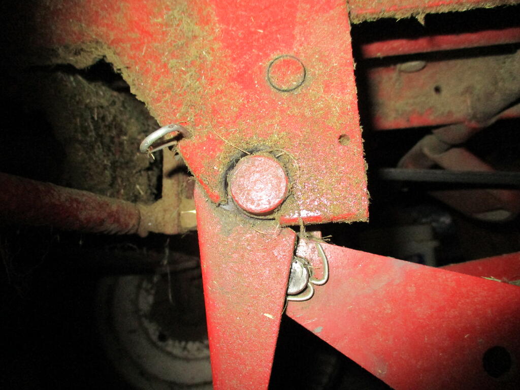

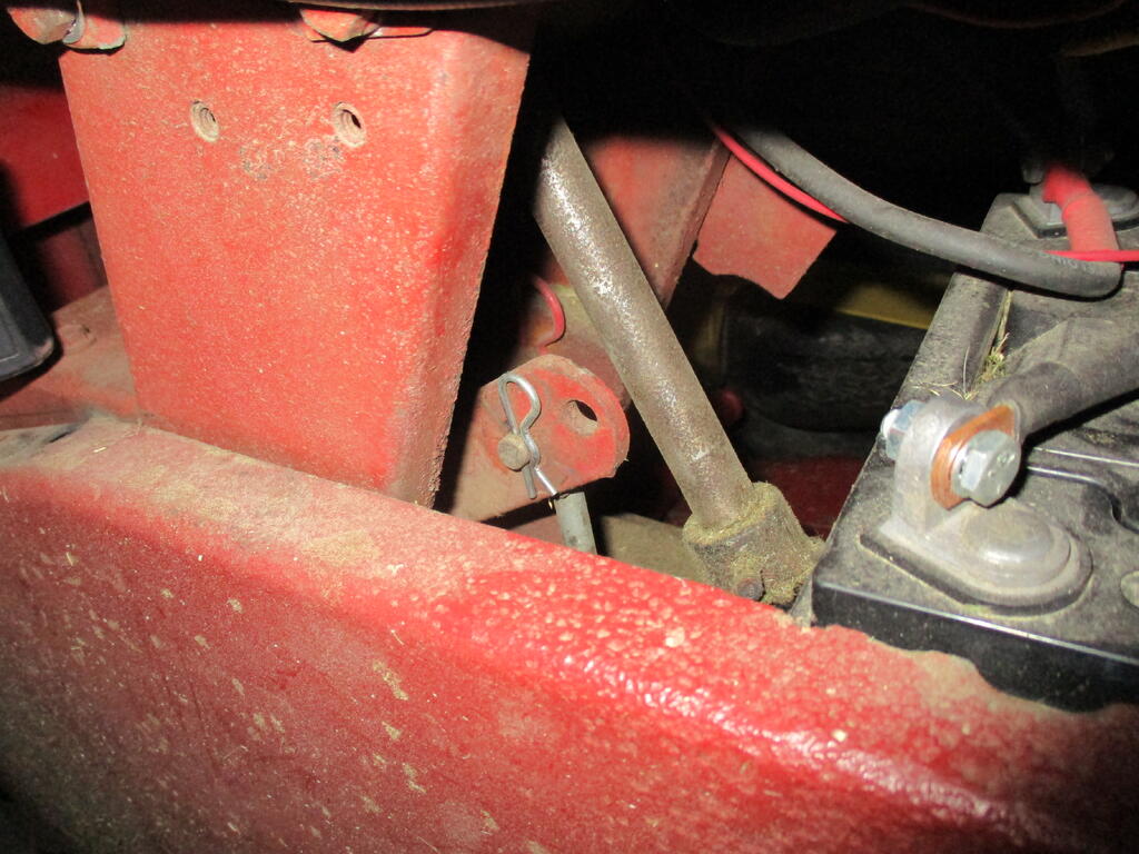

pfrederi 21,216 #5 Posted June 28 I am afraid ever thing you pictured is wrong 1 Remove the single belt that goes from engine to deck 2 lift link pull hair pin from trunion to remove see my pic 1 3 release retaining fork Pull the hair pint that is sticking out at you move the lever below it forward deck will drop pic2 2 Share this post Link to post Share on other sites
adsm08 5,194 #6 Posted June 28 2 hours ago, FLtractor said: Thank you. So after looking over my tractor today. Before I attempted remove and make more work for myself. I’ve taken pictures of what I believe are the steps you mentioned. 1. Is this the Deck belt I need to slip off the deck. From this circled end? Where would it slip off at if the gear box is in the way? 2. Is this the lift link I need to pull up And remove off tractor? 3. Loosen this Nut Bolt and remove- This is 1 of 2 the retaining fork? Like @pfrederisaid, you are 0 for 3. His pictures are correct. The things you pictured, in order, are 1) The double deck drive belts, the deck has to be almost fully disassembled to remove them. 2) The cut height adjustment. 3) The tension adjustment for the double deck belts. 1 Share this post Link to post Share on other sites
