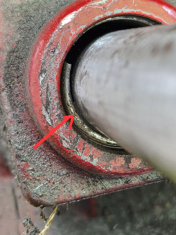

I have a 1973 "no name" model, 8 hp 4 speed.  The rear axle seal has been leaking and finally blew all the way out and was riding around the axle itself.  Not ideal.
I pulled the hub which didn't go well but that's beside the point.  Pulled what was left of the old seal out/off and when I looked inside where the seal sits, I saw what was in the image. There is some kind of edge in there that the seal sits on?  Or is that part of the old seal?

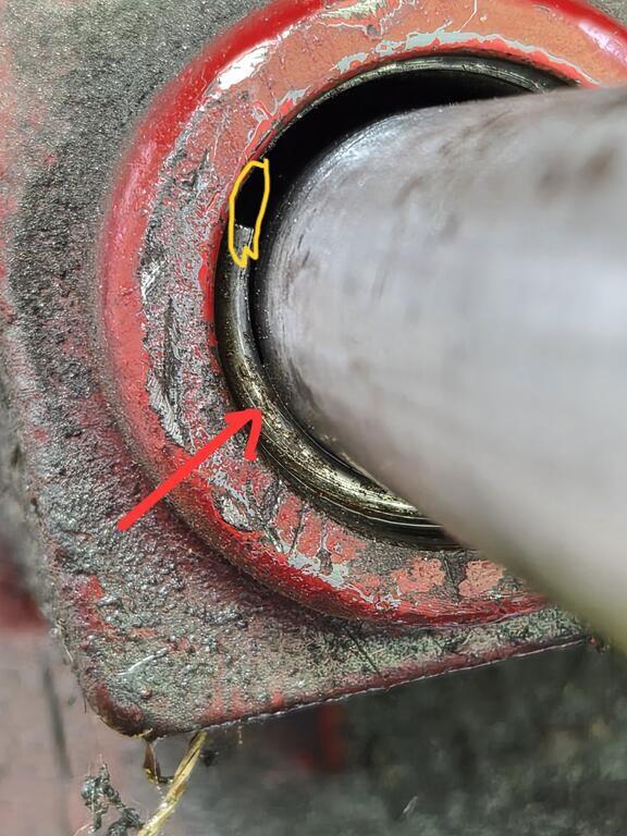

I think the bright metal ring that is broken is really what is left of the axle needle bearing....  Bad news.. Is the axle loose meaning any up/down fore/aft movement a little in and out is ok
Oh no. Yes, there is a little up and down movement. I am assuming that there should be exactly none?  It is less that the in and out movement if that is of any help.
If that is the case I'm up the creek so to speak. That is well beyond my mechanical abilities.  I hate to put her out to pasture, I've owned it for I'd guess, near 30 years. :sad:

As Paul stated, there should only be in & out movement, none allowable for either up & down or side to side..... Just replacing the seal with a bad bearing behind it is a waste of effort & money.... If the bearing is shot, the axle may be roughed up & need to be replaced. IF any of the needles in any bearings got loose inside, gear damage can result. Only way to know is to pull it apart.....
To replace the bearing, the Unidrive needs to come apart. Or.... swap it with another good 4 speed.
There are some excellent instructional documents in the Transmissions section that cover the teardown.
