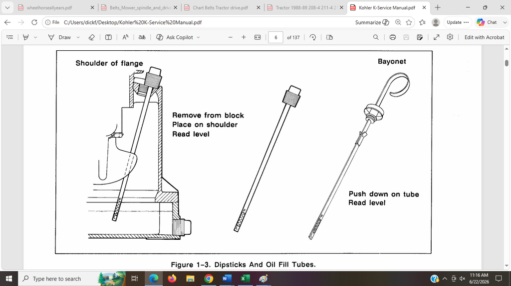

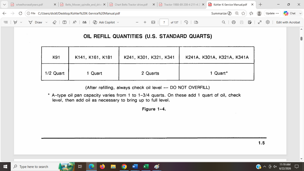

953 nut 69,073 #3 Posted June 22 Kohler engines all have a drain plug near the base, drain the oil into a container until empty. Once empty reinstall the drain plug and use straight 30 motor oil. Your engine should use one quart. The drawing below shows how to check the oil level. 1 2 Share this post Link to post Share on other sites
