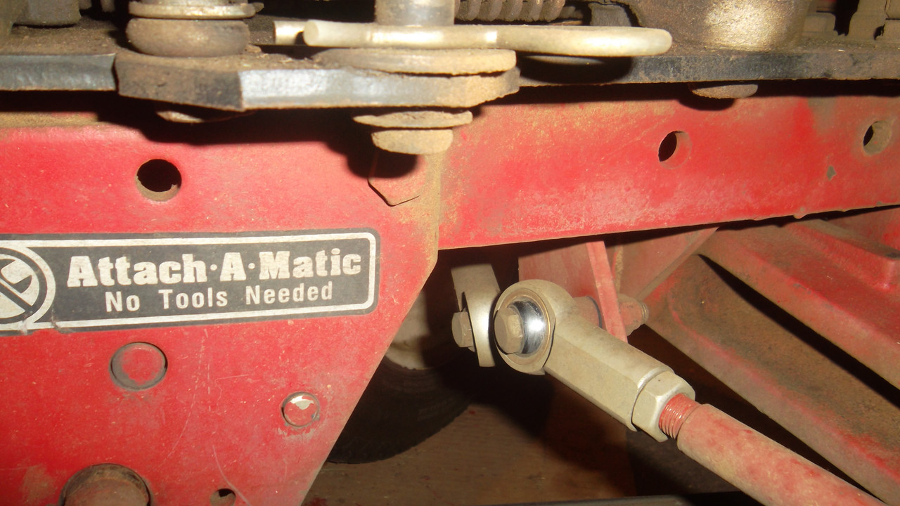

Lee1977 7,744 #6 Posted June 21 (edited) I'm not sure but the main difference may be the bent triangle plate for clearance of the larger tierod ends. I have used 1/2" heims joints and just attached to the back side of the triangle plate no my 300, C-120 and 89 520, don't see any difference in steering. Edited June 21 by Lee1977 1 Share this post Link to post Share on other sites
