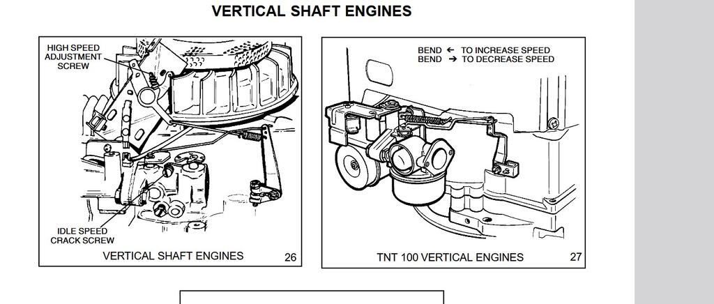

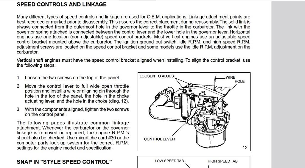

Teddy da Bear62 172 #3 Posted 2 hours ago 15 minutes ago, gwest_ca said: This model uses a VM-80 Tecumseh engine. I went to parts tree and looked at a very blurry diagram. Exploded diagram is just no help unfortunately. I need a photo of fully assembled speed control plate and linkages that sits a top the carburator. Share this post Link to post Share on other sites
