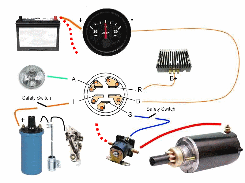

953 nut 69,296 #10 Posted June 19 Is your condenser connected to the "-" side of the ignition coil along with the points? This drawing was done by @Save Old Iron many years ago, good for visual learners. 2 Share this post Link to post Share on other sites
ebinmaine 80,695 #11 Posted June 19 23 hours ago, John c said: I put new spark plug, coil, points and condenser on it Why the new coil? Is the old one verified bad? Share this post Link to post Share on other sites
John c 223 #12 Posted June 20 yes the condenser is landed on the "-" terminal on the coil along with points lead. The old coil....I never gave it any thought I assumed the old coil probably OK, but the machine still had what looked like all it's original ancillary equipment, so I was refreshing things that deteriorate, fuel lines filters, fluids, repairs as needed, waking it up in a sense. Share this post Link to post Share on other sites

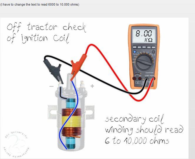

pfrederi 21,150 #14 Posted June 20 (edited) I would test your old coil.. Note secondary should read 6000 to 10000 ohms Edited June 20 by pfrederi 1 Share this post Link to post Share on other sites

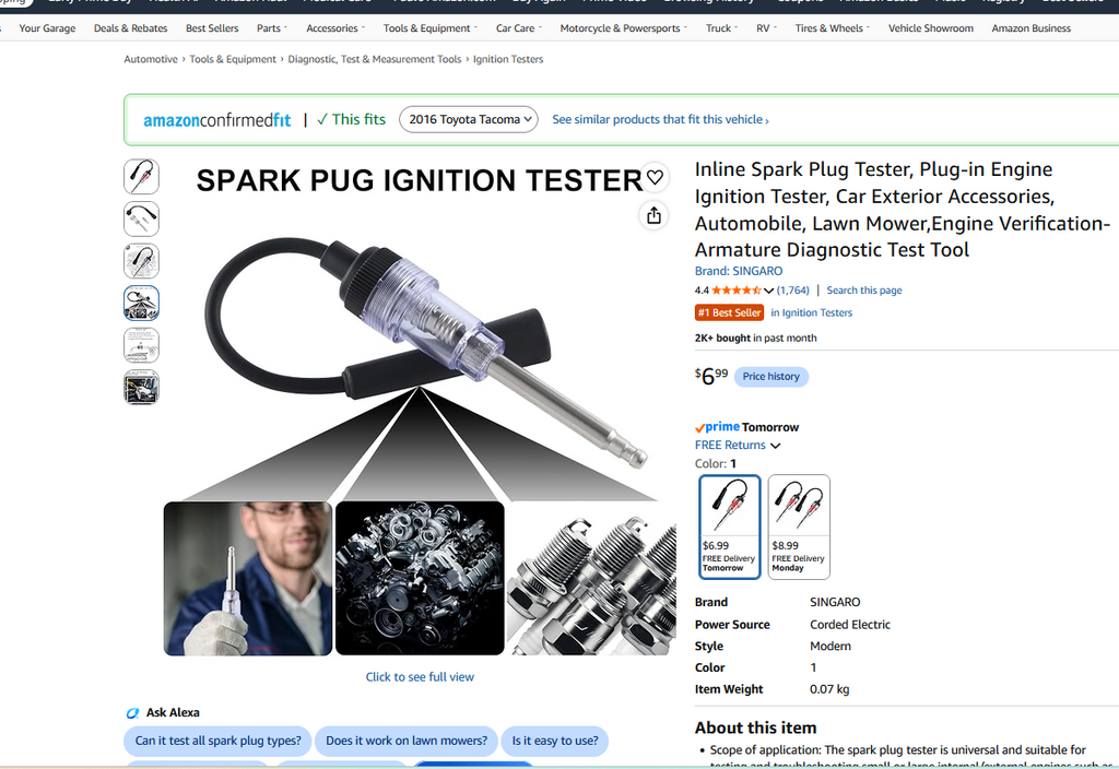

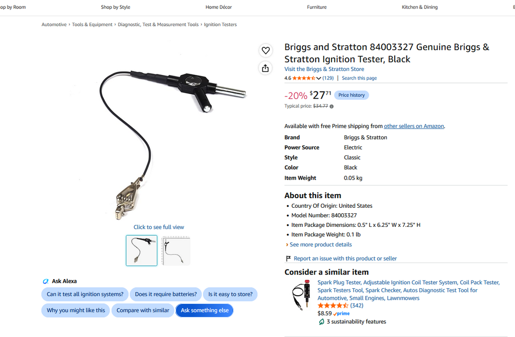

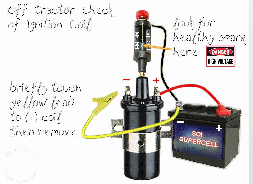

John c 223 #16 Posted June 20 Paul, what is that spark checker thing shown plugged into the plug wire terminal Share this post Link to post Share on other sites
John c 223 #17 Posted June 20 (edited) how can you tell if a coil needs an external resistor or not ? and then if it does, how do you determine what size to use, both ohms and watts ratings Edited June 20 by John c Share this post Link to post Share on other sites
pfrederi 21,150 #18 Posted June 20 1 minute ago, John c said: how can you tell if a coil needs an external resistor or not ? Kohler Coils had internal resisters usually marked as such. Not my picture but any spark tester can be used in that test. I use the cheap neon one for the test. The B&S tester is better but harder to use in this test Share this post Link to post Share on other sites

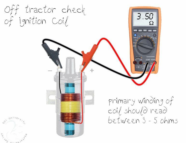

953 nut 69,296 #19 Posted June 20 (edited) 48 minutes ago, John c said: how can you tell if a coil needs an external resistor or not ? and then if it does, how do you determine what size to use, both ohms and watts ratings If you do the resistance check on the primary windings and it reads 1 ohm to 1.5 ohms then you need an external resistor. Until 1973 when Chrysler went to electronic ignition they had an external ballast resistor mounted on the firewall. Ford and GM had their resistors in the wiring harness. You should be able to buy a Chrysler resistor at a good auto parts store or on line IF you need one. Edited June 20 by 953 nut fat finger 1 Share this post Link to post Share on other sites
pfrederi 21,150 #20 Posted June 20 If yo do get an external resister be careful where you mount it...they get hot and they do not like to get wet. 1 1 Share this post Link to post Share on other sites
John c 223 #21 Posted June 20 reads 1 ohm to 1.5 ohms then you need an external resistor. The drawing above shows primary winding reading 3-5 ohms, does that reading indicate an internal resistor is there? I've ordered me a coil with an external resistor, just be sure After school and before the air force, I worked in an auto parts store, I remember the Chrysler ballast resistors, that was in a time before advance, O'Rielly's, and the other chain stores, there was NAPA, and the independents. I knew some guys that drove mopars, they'd keep spares in the glovebox. Share this post Link to post Share on other sites
953 nut 69,296 #22 Posted June 20 1 hour ago, John c said: drawing above shows primary winding reading 3-5 ohms, does that reading indicate an internal resistor is there? YES 1 hour ago, John c said: I knew some guys that drove mopars, they'd keep spares in the glovebox. I was one of the many people who did that. Share this post Link to post Share on other sites
