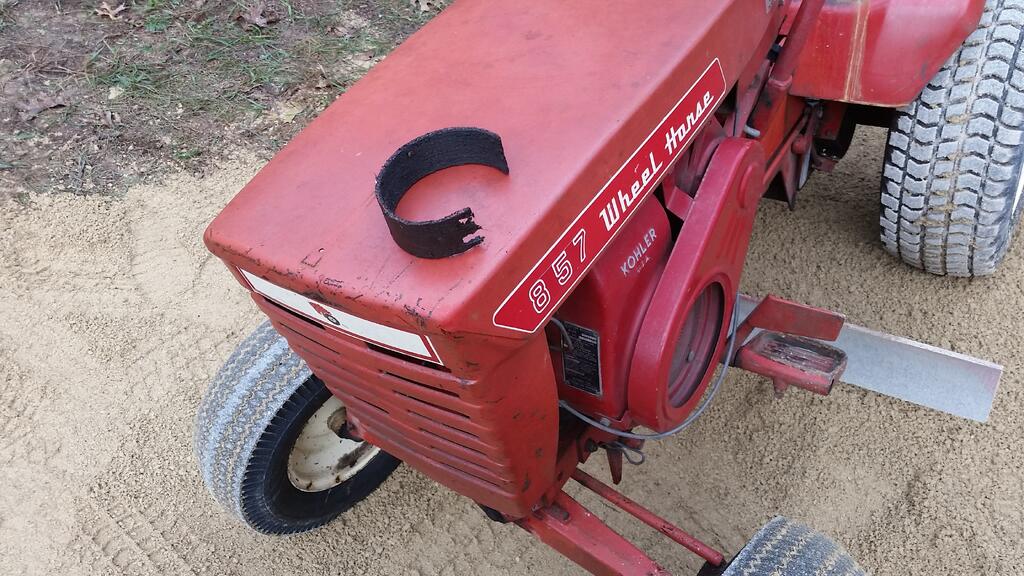

FLtractor 215 #3 Posted June 18 (edited) 4 minutes ago, kpinnc said: All the garden tractors made by wheel horse use a simple band and drum. They can be adjusted, but the only serviceable portion is the band itself. It should be kept clean and properly adjusted. And the clutch/ brake combination on some older machines is not the reason you can't shift on the fly. It is because the transmissions do not have any form of synchronization. You have to stop to select a new gear. Thank you for the prompt reply and correcting where I was wrong.. is the band is drum a very safe reliable easy to maintain brake (band) https://wheelhorsepartsandmore.com/product/brake-band-lining-wheel-horse/ just buy one of these and find where it attaches to brake lining.. bolt it in and done? Safe reliable brakes Edited June 18 by FLtractor Share this post Link to post Share on other sites
adsm08 5,114 #4 Posted June 18 (edited) 17 minutes ago, FLtractor said: Thank you for the prompt reply and correcting where I was wrong.. is the band is drum a very safe reliable easy to maintain brake (band) https://wheelhorsepartsandmore.com/product/brake-band-lining-wheel-horse/ just buy one of these and find where it attaches to brake lining.. bolt it in and done? Safe reliable brakes Safe and reliable are relative terms. Most bicycle brakes have more stopping force relative to weight than a garden tractor. I've never relied too much on garden tractor brakes, particularly the parking brake, but they are fully mechanical linkage, so no hydraulic lines to blow out. Easy to maintain is also relative. The process of adjusting them is simple enough, it's just a nut to tighten or loosed on a threaded rod. Access is the issue, it's not in a super-easy to access spot. My hand fits fine, but there is precious little room to swing a tool. If you flip the seat pan up it should all be on the left side. The lining you linked to is just the friction material. The old would need to be removed from the band and the new glued down. @rmaynardalso sells the linings. Brian at K&B@76c12091520h will sell you a whole, ready to go band with lining. Edited June 18 by adsm08 Share this post Link to post Share on other sites

FLtractor 215 #9 Posted June 18 2 hours ago, adsm08 said: Safe and reliable are relative terms. Most bicycle brakes have more stopping force relative to weight than a garden tractor. I've never relied too much on garden tractor brakes, particularly the parking brake, but they are fully mechanical linkage, so no hydraulic lines to blow out. Easy to maintain is also relative. The process of adjusting them is simple enough, it's just a nut to tighten or loosed on a threaded rod. Access is the issue, it's not in a super-easy to access spot. My hand fits fine, but there is precious little room to swing a tool. If you flip the seat pan up it should all be on the left side. The lining you linked to is just the friction material. The old would need to be removed from the band and the new glued down. @rmaynardalso sells the linings. Brian at K&B@76c12091520h will sell you a whole, ready to go band with lining. Thank you for the detailed info. Would this be the exact process i need to follow on the 856? Share this post Link to post Share on other sites
adsm08 5,114 #10 Posted June 18 6 hours ago, FLtractor said: Thank you for the detailed info. Would this be the exact process i need to follow on the 856? Yes. I just skimme the video but it looks like a good set of instructions for that job. Bob @rmaynard ? 1 Share this post Link to post Share on other sites
rmaynard 17,572 #11 Posted June 18 (edited) Well, I saw several things that I did not like. First, I did not like the way that he inserted the seal with a punch. I always use a piece of PVC pipe to set a seal. That makes sure it's set at equal depth all around. Next and most importantly, he didn't use a Bob Maynard brake lining. My linings are 1.5 inches wide. His 1 inch lining will give him 30% LESS braking. Also, he complained about how hard it was to get the old glue off, then he used the same type of glue to put the new lining back on. My opinion is, if you are going to do something as important as brakes, don't cut corners. Do it right. Just my Edited June 18 by rmaynard 3 Share this post Link to post Share on other sites
WHX?? 58,043 #12 Posted June 18 And this is why we don't take YT for gospel. Aside of the things Bob has already mentioned he did not tape the keyway off to avoid nicking the seal. Although it's never a bad idea to put one of B-100 Bob's linings on I never change out an original just because it's grease soaked. I have a method of cleaning originals using a mineral based solvent and burning the old grease off. If this happens yes ... replace. 1 Share this post Link to post Share on other sites
