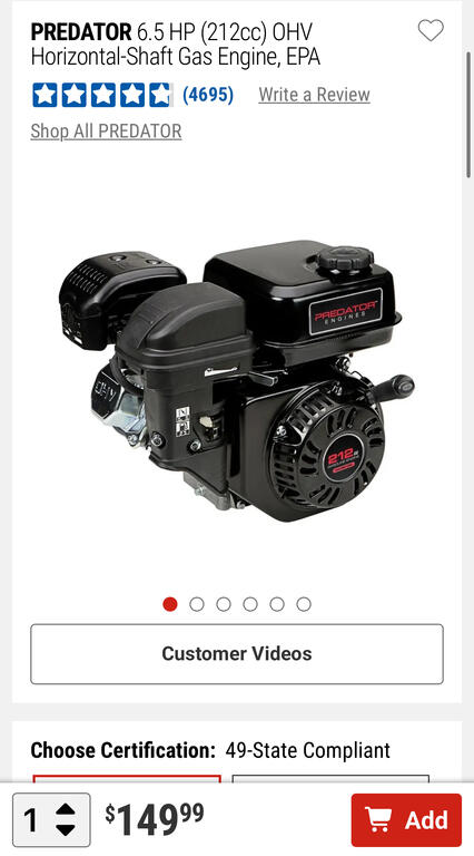

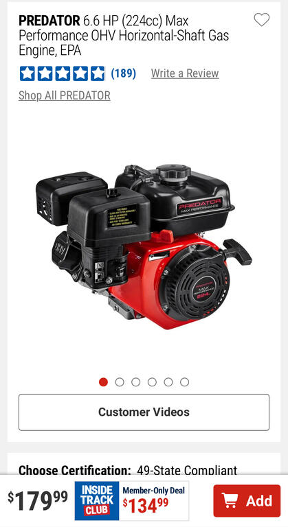

FLtractor 223 #1 Posted June 16 Evening? After watching several videos on old Wheelhorses.. not 856.. being repowered by new predator engines.. wondering which would be best easiest fit? For just mowing and or towing? No snow. Harbor freight has these two.. wondering which would be better option and or fitment… Also.. if I did install.. I would simply: unbolt and remove old engine.. coil.. points.. starter .. generator.. voltage regulator … gas tank and or pan if desired … Drill holes in tractor frame .. Add adapter plate to bolt to frame.. bolt new engine to that.. attach choke and throttle to new engine linkages… find a engine to mower and transmission Pulleys? if sizes different? Any steps wrong or missing? Overall how difficult would this be to do? Share this post Link to post Share on other sites
adsm08 5,145 #2 Posted June 16 What's wrong with the engine you have? A K181 is going to be far superior to anything you buy at HF. 3 1 Share this post Link to post Share on other sites
