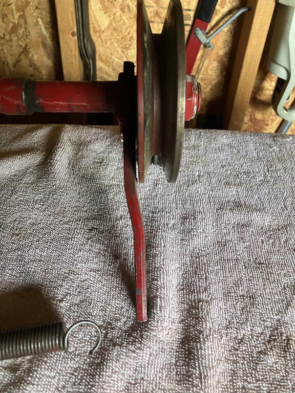

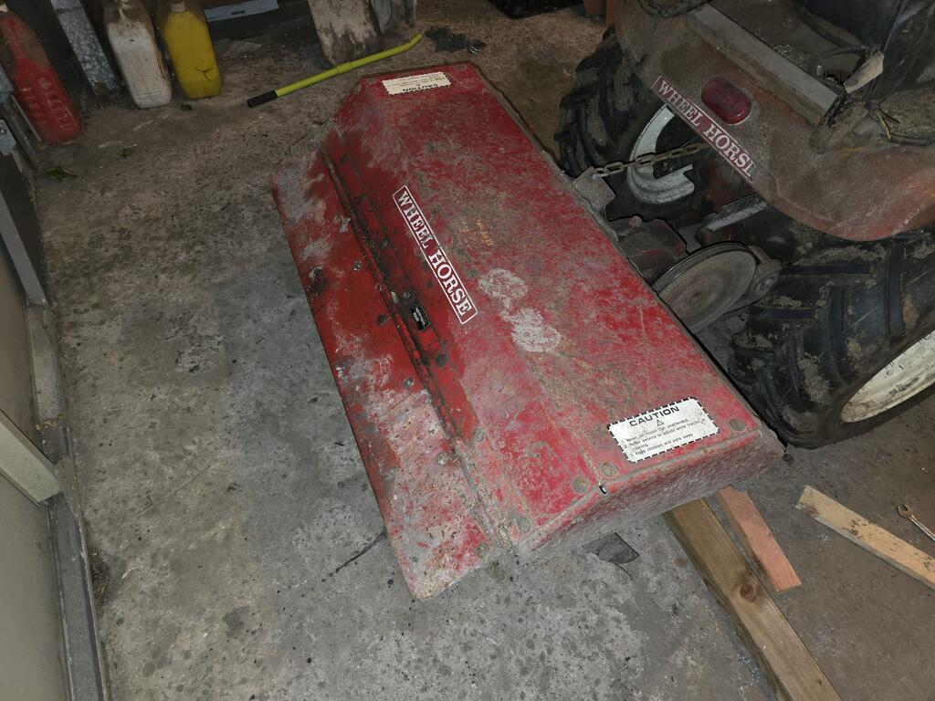

Sutty 101 #1 Posted June 13 (edited) I am trying to fit my tiller that has not been fitted for 30 years, maybe more. The belt will not go on, no way no how and I think it must have shrunk, or the rubber has lost compliance, so I cannot get it on. It is the only belt I have that's close to this length, so it has to be the right one. My problem is now two fold. My model does not have a lever arm for the spring belt tensioner, and I know when I last used it it did not need the spring. It was so tight, back then, that it was a real pig to get on the big rear pulley anyway, now it seems impossible. Anyway, there is no lever arm on the attach-o-matic pulley and idler that mounts there to apply the spring to. Second, because my model seems to be somewhat unrecognised on here, it's a Belgium machine, I worry that if I get the standard length it will be slightly too long, requiring the spring loaded idler, which I do not have. Is there anywhere to look up what belt length is needed on my specific machine for my tiller? It's a C-140 8 speed, and has serial number 151391. Yes, I know there is no C-140 8 speed in the USA. See below. Everyone seemed very pleased to see one. Also below is the tiller: By the way, it's very late here now, so I won't check back in until tomorrow, so don't think I'm being rude if I don't reply further tonight to any suggestions. Thanks in advance. Regards Sutty Edited June 13 by Sutty Share this post Link to post Share on other sites
gwest_ca-(File Mod) 12,552 #2 Posted June 13 Click on the fuzzy picture Share this post Link to post Share on other sites

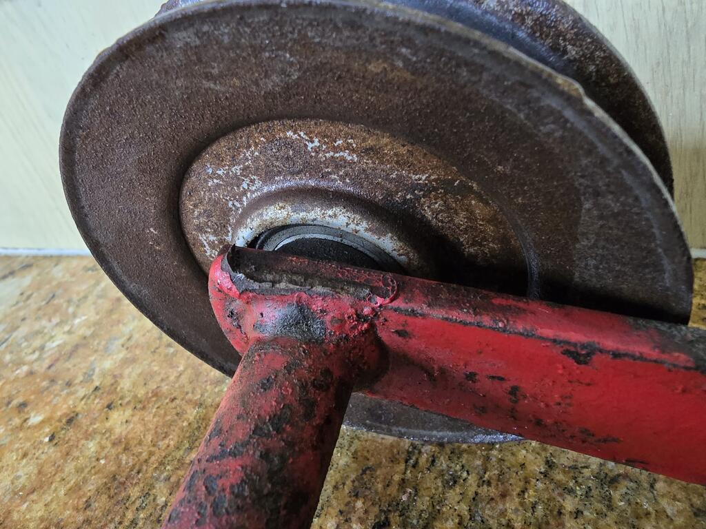

Sutty 101 #3 Posted June 13 Thank you for the exploded view, and the belt description. I'd read the belt was 139" x 1/2" elsewhere on this site, but was worried it won't be tight enough, without a spring tensioner. However, I have just discovered why I do not have a spring tensioner lever. I think it's fairly clear that it was badly welded, and at some point it has snapped off. The fact that it has paint on the flat metal portion, behind the front weld area, suggests there was no weld there and it was somewhat open. I will have to see what I can come up with. Maybe I can weld something on? Excuse my ignorance, but just in case I get it wrong, can I assume that the 139" will be the inside running length or shall we say, inside circumference? Thanks again. Share this post Link to post Share on other sites

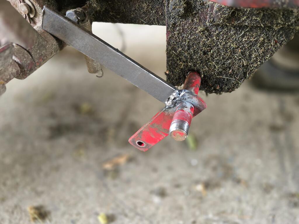

Sutty 101 #6 Posted June 13 Thanks Peter, but I'm not sure I follow your post about fish oil. I've looked up a bunch of pictures, and have now clearly identified the issue, the belt tensioner arm has snapped off on my attachment. I have the pulleys off it now, and have a piece of appropriate steel to weld in place. I'm not entirely clear why part number 88 in the picture above has an offset. Many of the photographs I've seen are just flat bar. It doesn't look like I will foul anything with just flat bar, but I need to take a closer look before I can be sure. Can anyone tell me the length of the flat bar for the spring arm? From pictures I could guess, but easier with a measurement from someone, if maybe someone could measure one. Thanks. Thanks gwest for the belt detail. My belt, that I had used before, is 135.625 outside, which explains why it is too short, when it should be 139 outside. It must have shrunk a lot, or was a little shorter to begin with, to make up for not having any tensioner mechanism. Last time I used it, all those years ago, it was super tight. Now it's just a tad beyond that. The following product should be okay then, for when I get my spring arm welded on to my attachment? https://bepltd.com/products/spa3482cr-advance-continental-advance-wrapped-wedge-belt Share this post Link to post Share on other sites

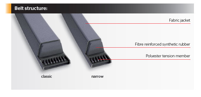

Sutty 101 #8 Posted June 13 It's tricky because mainly I don't know anything about belts. I do know that many sites have A136 or A138, but no A137, which is the 139" outer that's needed. If I do find an A137, it often looks worryingly poor quality, like some no name eBay item. The one I linked, like all I've seen, has the cords near the flat side. It is the classic profile shown below. Share this post Link to post Share on other sites

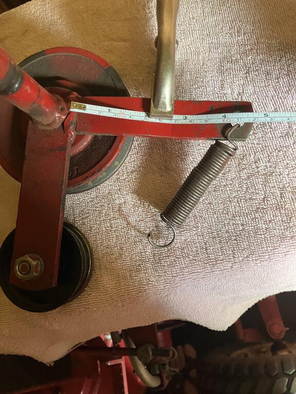

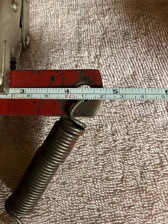

Sutty 101 #9 Posted June 13 I can't find those Gates green A137 over here. I think I'll just have to try the one I linked. Do you happen to know the length of the tensioning arm, from where it is shown broken off in my picture? Share this post Link to post Share on other sites
Razorback 1,370 #10 Posted June 13 (edited) 27 minutes ago, Sutty said: I can't find those Gates green A137 over here. I think I'll just have to try the one I linked. Do you happen to know the length of the tensioning arm, from where it is shown broken off in my picture? I hope these pics help. The top of that measuring tape is inches, bottom is centimeters. Mine uses an A139 belt. Edited June 13 by Razorback added soem text Share this post Link to post Share on other sites

Sutty 101 #12 Posted June 13 Thanks for the pictures Razorback, I will cut it to the length you show there and drill accordingly. Yes gwest, thanks, I can see how that would stress it more, it would be stretched a lot on the outside curve. Having said that, I'm doing a couple of small areas, and it will be worth it for £40, if it lasts out the job. My welding skills are appalling, but I think in this case they will be good enough. The other side is the same quality, or lack thereof. Share this post Link to post Share on other sites
Razorback 1,370 #13 Posted June 13 (edited) @Sutty I’m not sure if it matters much, but in my second picture, can you tell that there is a compound bend in that flat stock? Where the vise-grip is clamped is in the middle of the two bends. I think the top end where the spring attaches ends up in line with the outside of the pulley. I’ll get another pic …. Edited June 13 by Razorback Share this post Link to post Share on other sites

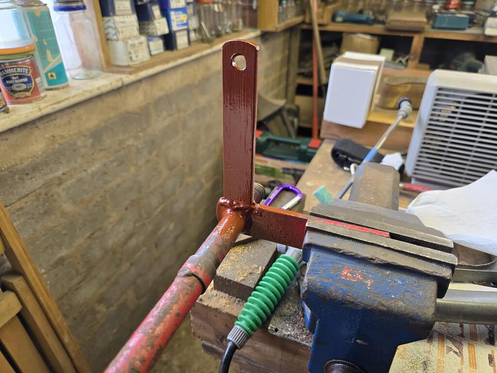

Sutty 101 #14 Posted June 13 Yes, thanks, I mentioned it up the thread. Part 88 in the drawing, clearly shows it, but many photos of other people's didn't seem to have it. I checked mine, and it shouldn't interfere with anything, so I've left it flat like many of the photos of other people's. If it does need it, it won't be difficult to add it, and will lose hardly anything off the length. I've finished it now, and painted it with red oxide primer, which I'll have to run it with until I can get hold of some Wheel Horse red. Good enough, I think. Just need the belt now. 1 Share this post Link to post Share on other sites

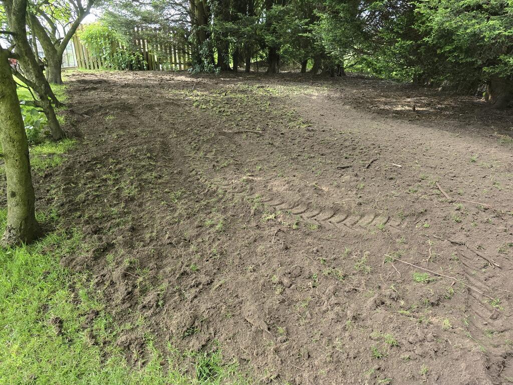

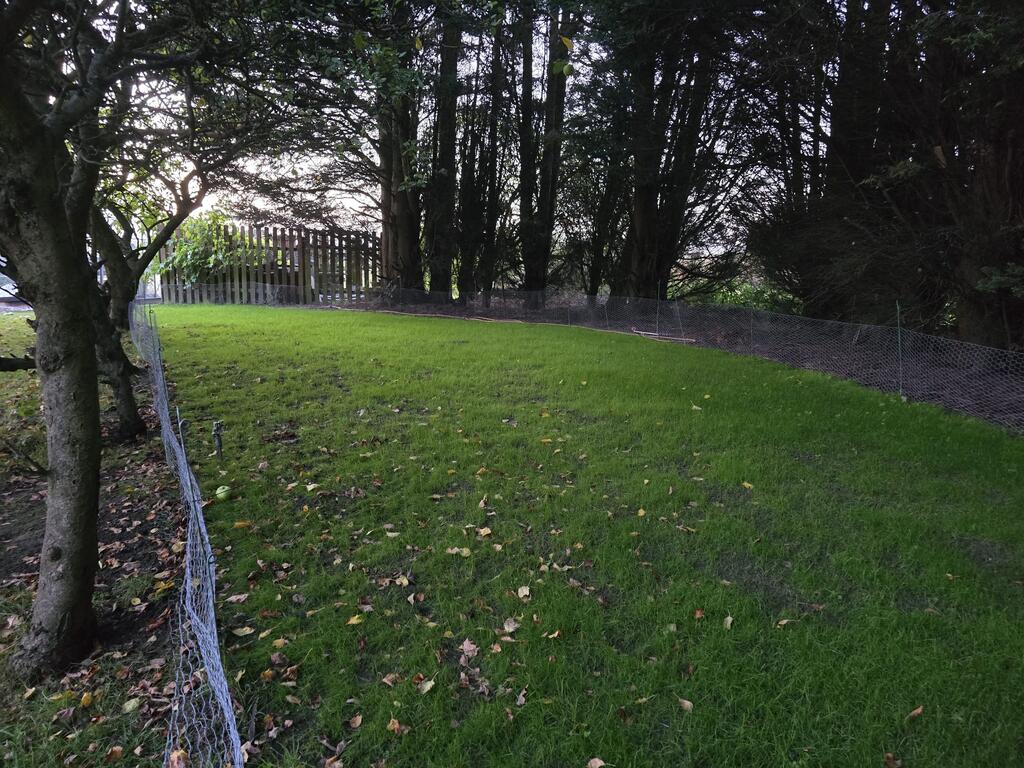

Sutty 101 #21 Posted June 16 (edited) Achieved part one of what I wanted to get done. Part two is a similar sized area elsewhere. Very satisfied. Just wanted to till it a few inches down, ready to try some shade tolerant grass. Bit of an experiment, because it's well shaded, and pretty dark, but the according the website, they say it practically grows in the dark. We shall see. Need to pick out some roots, and rake it, but otherwise it's good enough. Too tired to do that today though. I'm not fit enough at my age to have done that, without the wheel horse, because it had such a solid crust, from having had no grass for so many years. Great machine. Edited June 16 by Sutty 1 Share this post Link to post Share on other sites
