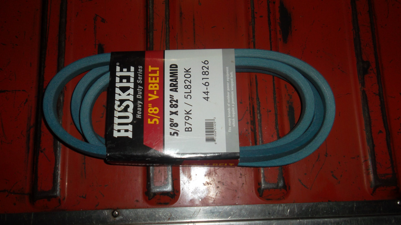

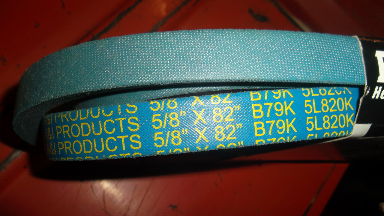

Lee1977 7,761 #5 Posted June 16 If you get it from Tractor Supply you need to check both the sleeve and belt. Some people take them out and put them back in the wronge sleeve. 3 1 Share this post Link to post Share on other sites
