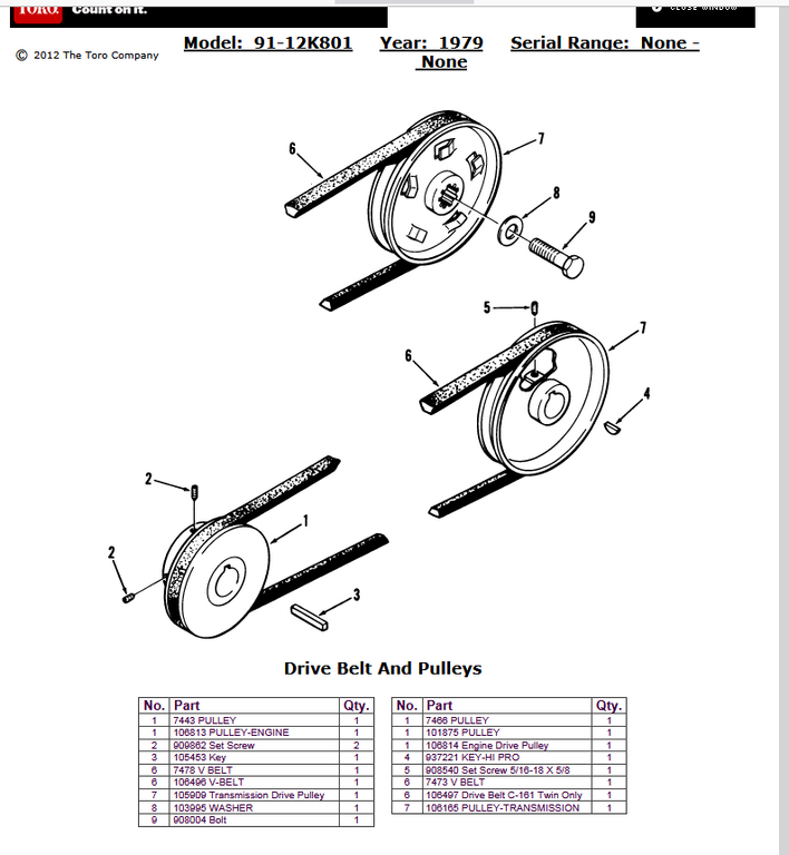

BobR 10 #1 Posted June 11 I have tried searching for an answer to my question on this site, but struggling. My question is this - what drive belt (engine to 8-speed transmission) do I need for my 1979 C121 (91-12K801) tractor? I want to order one without taking the old one off and measuring it (it's summer here and everything is growing fast). I have read that it's a 7478, but I have also seen 7473, which is correct? 1 Share this post Link to post Share on other sites
nylyon-(Admin) 9,196 #2 Posted June 11 Welcome to the forum, it looks like the 7478 is the correct belt 1 Share this post Link to post Share on other sites
pfrederi 21,342 #3 Posted June 11 I think you nay have misread the diagram The 7478 is for a hydro (see the top pulley picture) Parts diagram coverdmore than on etracto. Gear drives are 7473 the bottom # 6 2 Share this post Link to post Share on other sites
DLF 74 #4 Posted June 11 (edited) I buy my 7473 Belts. from Tractor Supply ( 5/8" x 82" ) .Aramid Blue Belt. Lee1977 Edited June 11 by DLF 2 2 Share this post Link to post Share on other sites
nylyon-(Admin) 9,196 #5 Posted June 11 7 minutes ago, pfrederi said: I think you nay have misread the diagram The 7478 is for a hydro (see the top pulley picture) Parts diagram coverdmore than on etracto. Gear drives are 7473 the bottom # 6 This is why we have the pro’s here, thank you for the correction 2 Share this post Link to post Share on other sites

BobR 10 #7 Posted June 11 Thanks guys - just ordered the 7473. Appreciate the help. Share this post Link to post Share on other sites
