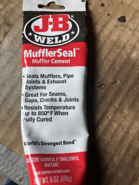

Retired Wrencher 6,993 #1 Posted June 11 i’m giving this JB weld a try. It is muffler cement It had a big crack at the base about half way around. I have some big wire wheels and I brush the heck out of it clean it up the best I could and then I applied the muffler cement. Let’s sit overnight and this is the way it turned out once I got the engine running I guess time will tell if it’s gonna last right now. It seems to be pretty stable. Hope you enjoy the video and the pictures. IMG_1245.mov 1 Share this post Link to post Share on other sites

RED-Z06 2,720 #6 Posted June 17 My big Simplicity has a narrow area of rot in thr top of the muffler canister, its not structural but i wire wheeled it, soaked in 30% vinegar, wire wheeled, ive tried 6 different products including this one. The problem has been the pressure eventually (usually a half hour), pushing the stuff off. I finally relented and welded a plate over it. Share this post Link to post Share on other sites
Retired Wrencher 6,993 #7 Posted June 17 2 hours ago, RED-Z06 said: My big Simplicity has a narrow area of rot in thr top of the muffler canister, its not structural but i wire wheeled it, soaked in 30% vinegar, wire wheeled, ive tried 6 different products including this one. The problem has been the pressure eventually (usually a half hour), pushing the stuff off. I finally relented and welded a plate over it. RED-Z I used just about the hole tube on it. So far so good. I will keep an eye on it through the year. And see if it holds up or not. Share this post Link to post Share on other sites
