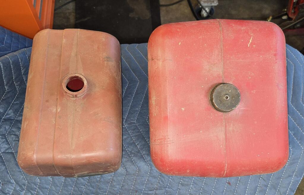

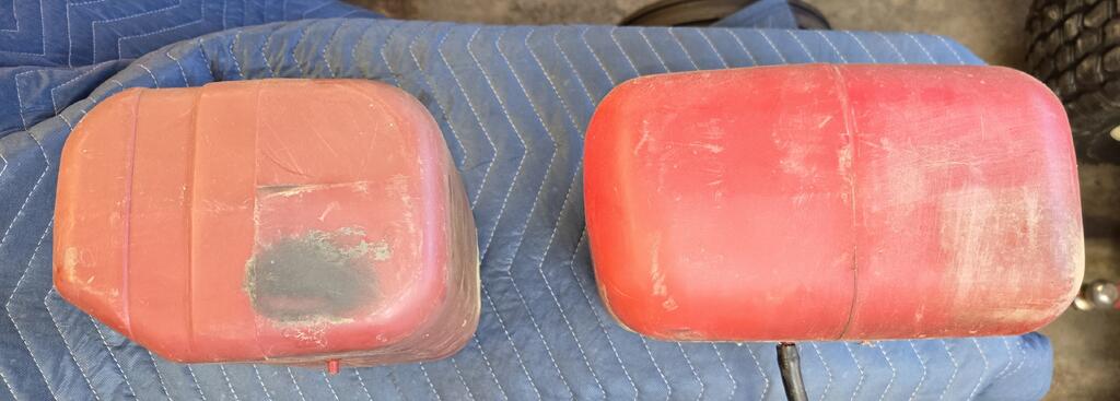

kpinnc 18,963 #4 Posted June 11 (edited) 1 hour ago, FLtractor said: Wondering if there’s a plastic gas tank that fits the factory pan on the 856 Wheelhorse My 867 also has the steel tank and I've often wondered about this as well. But the tank is fairly secure with the strap that holds it in place. I also have one in my custom V14. But if you really want to change it, there were factory plastic tanks on later machines that should fit. "Should" is the key word here. I've had two damaged ones. I think one was from a 1974 no name 8hp-4 speed. The other I have no clue (maybe a Commando?) but these tanks are basically half the size of the Raider/Charger/Bronco tanks that predates the C series. You might want to hit up a couple of the folks in our vendor section. And stay away from the larger sized square tanks. They will not allow the 856 hood to close. See the pic below. The style you will be looking for is on the left. The right side will not fit under an 856 hood. Edited June 11 by kpinnc 2 Share this post Link to post Share on other sites

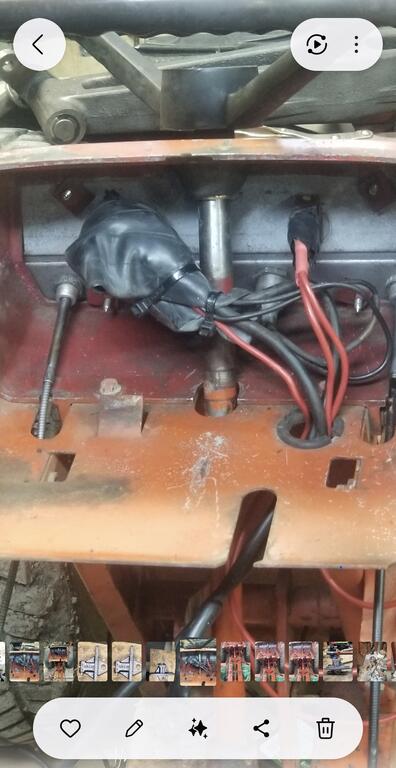

gt14rider 1,278 #6 Posted June 11 I used a bike inertube and zip ties to insulate the wires on my 856. Hasn't blown up yet. 3 3 Share this post Link to post Share on other sites
ebinmaine 80,695 #7 Posted June 11 1 minute ago, gt14rider said: I used a bike inertube and zip ties to insulate the wires on my 856. Hasn't blown up yet. @FLtractor There ya go!! 1 Share this post Link to post Share on other sites

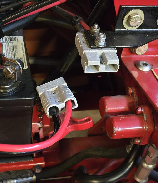

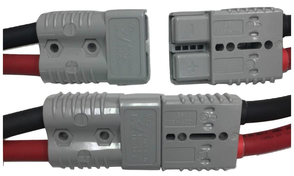

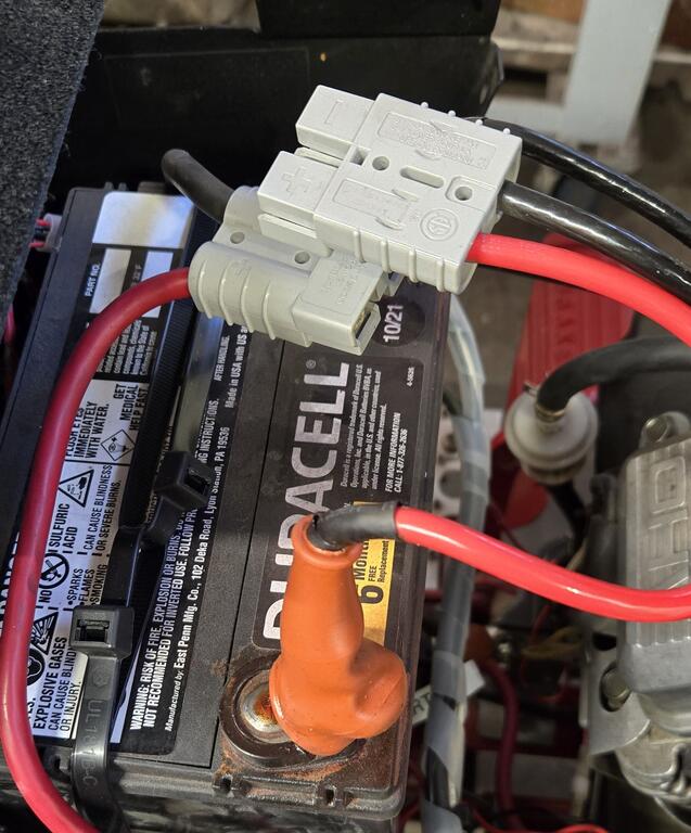

kpinnc 18,963 #20 Posted June 12 2 hours ago, FLtractor said: unbolt the negative battery terminal and or bolt so battery terminal on regulator is no longer hot? I use Anderson connectors on all my tractors. Lets me quickly swap batteries if needed and also completely disconnect when not in use. No parasitic drain, and no problems working on stuff. 1 1 Share this post Link to post Share on other sites

kpinnc 18,963 #23 Posted June 13 (edited) On 6/12/2026 at 8:33 AM, FLtractor said: Where does this connect to and or from? Haven’t ever seen that before. Have a link where to get ? Anderson 120 amp connectors on Amazon I think the 50 Amp connectors are sufficient. The only difference is the wire guage that will fit the crimp connector. I run 6 guage wire with zero issues on Kohler small and large block as well as Vanguard twins. I usually make a 8-10 inch length wires on the battery side so my batteries will swap easily between machines. Then on the tractor side, hot to the solenoid and ground to the chassis. Connects like any other battery cables, just with two connectors in the middle. These connectors only connect one way, so polarity is never an issue. A few of mine have the tractor side hard mounted, the rest are not but batteries swap regardless. Edited June 13 by kpinnc 1 1 Share this post Link to post Share on other sites
