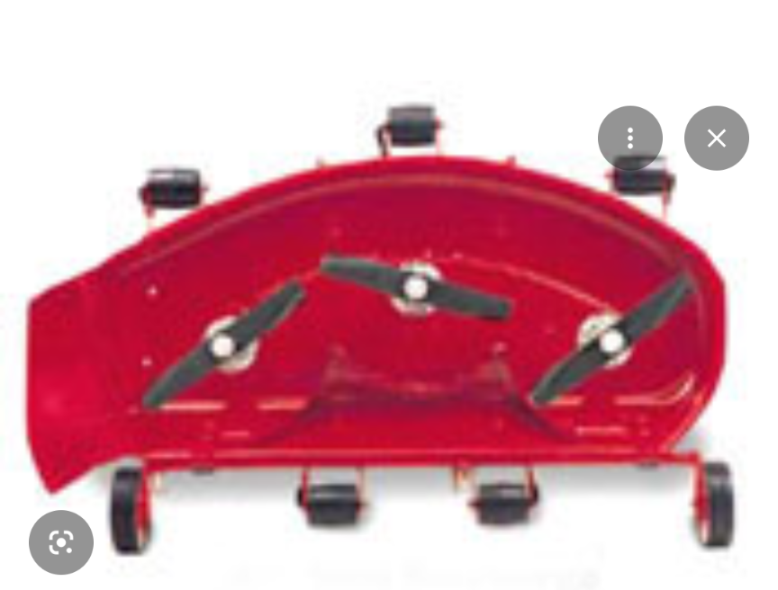

MShepheard 8 #1 Posted June 9 I have acquired a 72110 Wheelhore with the above deck but I am totally confused by the path the cut grass takes to exit the deck. Does anybody have a picture of the underside of this deck ?? Thanks Share this post Link to post Share on other sites
rmaynard 17,612 #2 Posted June 9 78252 is the ID of the tractor that deck came from. The deck is probably a 42" one. As with all regular side discharge decks, the grass follows the direction of rotation of the blades. Here is a typical 42" SD deck 1 Share this post Link to post Share on other sites
gwest_ca-(File Mod) 12,508 #3 Posted June 9 78252 is a 52" side discharge mower for the 260-Series yard tractors. This model may have been exported to the UK only. Manuals Share this post Link to post Share on other sites
gwest_ca-(File Mod) 12,508 #4 Posted June 9 The 78252 deck had a recycler kit available for it. Model 79185. Do you have that? The deck outlet is blocked and the clippings should be distributed below each blade if all the kickers are in place. Added 2 files to the operator manual above. Share this post Link to post Share on other sites
gwest_ca-(File Mod) 12,508 #5 Posted June 10 Different operator manual for 1996 and different recycler kit 59225 Illustrated parts list same 1996-1999. 1 Share this post Link to post Share on other sites
MShepheard 8 #6 Posted June 10 Thanks all for the response. Gwest_ca had it spot on, think I'll remove the recycler though . You guys do a fantatstic job, thank you.. I might be back as there is a hydraulic leak somewhere which I have yet to investigate. Thanks again 1 Share this post Link to post Share on other sites
