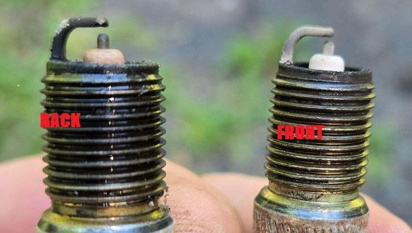

Strokerace2639 1 #1 Posted 4 hours ago Yes I understand there are many threads about this. As they as a few years old, and I just picked up this machine I am starting a new. 1988 Wheel Horse 520-H bought from original owner. only parts I have replaced to this point are the Fuel Filter and the starter solenoid. Runs great on start up and until its good and warm ( 15 minutes or so), then it starts surging/hunting. The engine speed goes up and down, the vacuum goes from like 2 to 15 very rapidly, under load. As soon as I stop the mower deck it settles right back to what I would consider normal. Sets already done. used propane and starter fluid around the intake and carb. found no noticeable changes. i did notice the fuel filter never seems FULL. is this normal? What are the things I should look at and in what order? Thank You, StrokerA Share this post Link to post Share on other sites
