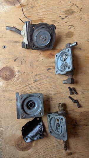

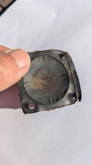

Phan 65 #1 Posted June 6 Please comment. It looks like it has been modified (top was from B80) The diaphragm has debris and cannot be cleaned. If I need to buy new, which one I should go. Share this post Link to post Share on other sites

sqrlgtr 3,284 #4 Posted June 7 19 hours ago, Phan said: Please comment. It looks like it has been modified (top was from B80) The diaphragm has debris and cannot be cleaned. If I need to buy new, which one I should go. I have had pretty good luck rebuilding these and have rebuilt 3 in the past year using "ThenandNow" kits. I dont like the looks of the electric pumps on the S/g tractors but I do use them on the later model stuff and if your only goal is to get up and running that is the only way to go but if your trying to keep original look its well worth the effort of rebuilding the ol mech pumps. I don't even look at the newer plastic pumps, all though I have couple that came on tractors from PO's and have had good luck out of them. 1 Share this post Link to post Share on other sites
Phan 65 #5 Posted June 7 Thank - sqrlgtr! I Will sent them an inquiry if they will ship the kit for me. Share this post Link to post Share on other sites
