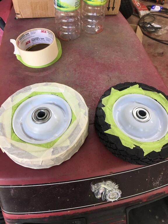

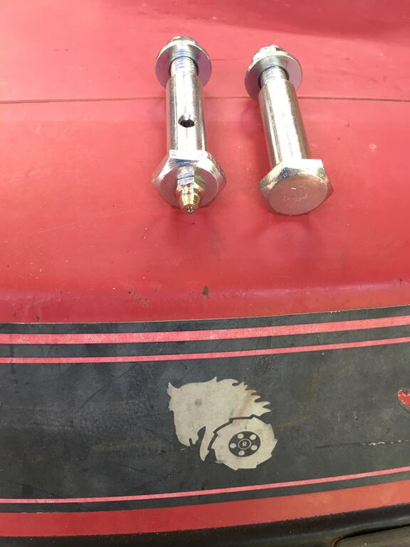

sqrlgtr 2,973 #1 Posted 3 hours ago Found some steel wheels with ball bearings for 520h mowing deck, wheels had no grease fitting . So made greasable axles instead of adding fittings to wheels seems to have worked out good. Forgot pics of painted wheels but they are you guessed it red now. 1 1 Share this post Link to post Share on other sites
953 nut 66,350 #2 Posted 2 hours ago Aren't those bearings sealed? Share this post Link to post Share on other sites
Handy Don 16,698 #3 Posted 1 hour ago (edited) 1 hour ago, 953 nut said: Aren't those bearings sealed? Yep. Stamped steel outer race but certainly pre-greased and closed on the “inner” side. Edited 1 hour ago by Handy Don 1 Share this post Link to post Share on other sites
sqrlgtr 2,973 #4 Posted 1 hour ago They probably suposed to be but u could see the new grease coming out around the outer race. 1 Share this post Link to post Share on other sites
