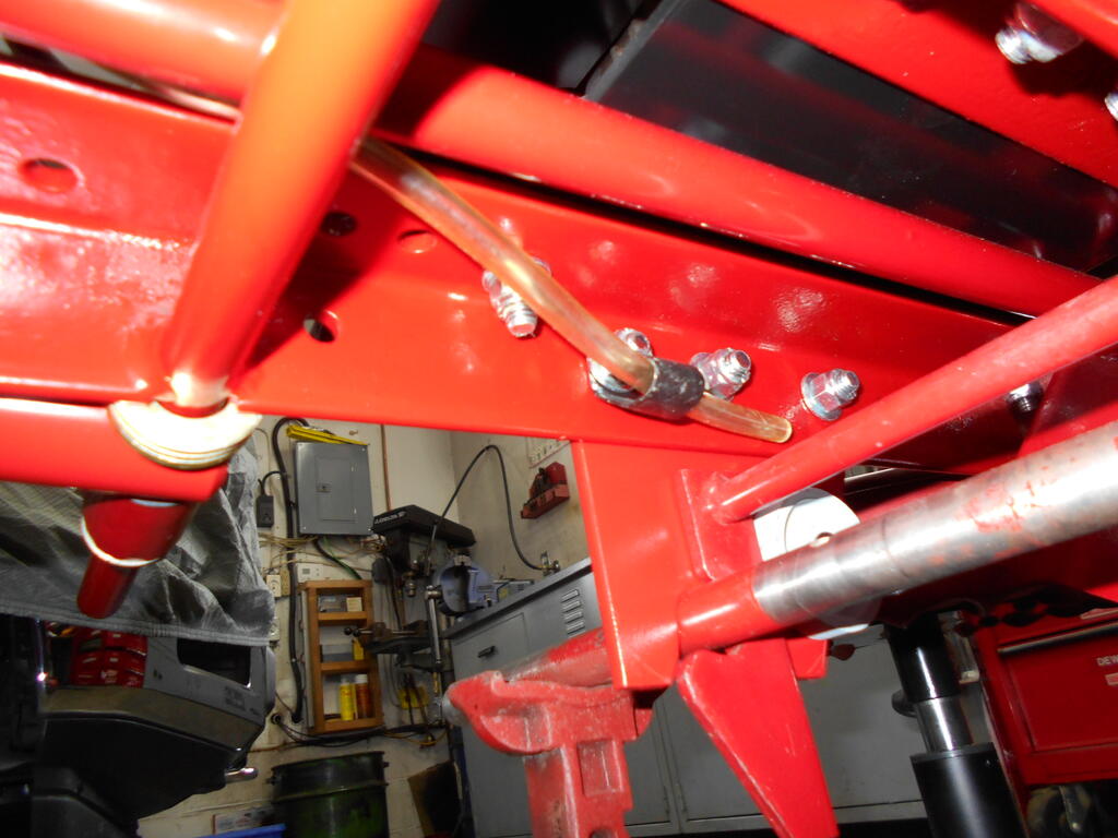

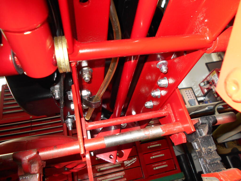

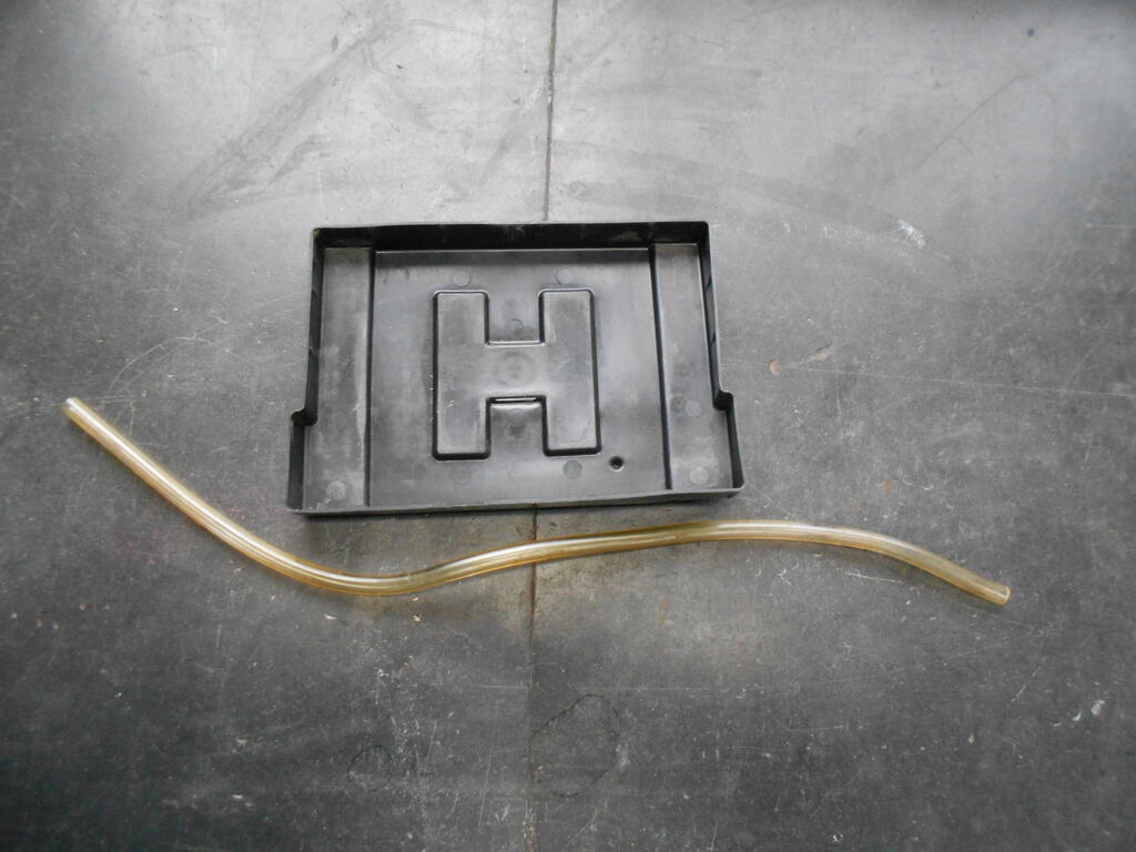

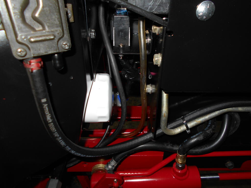

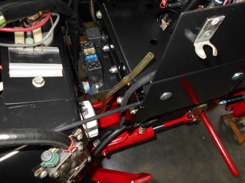

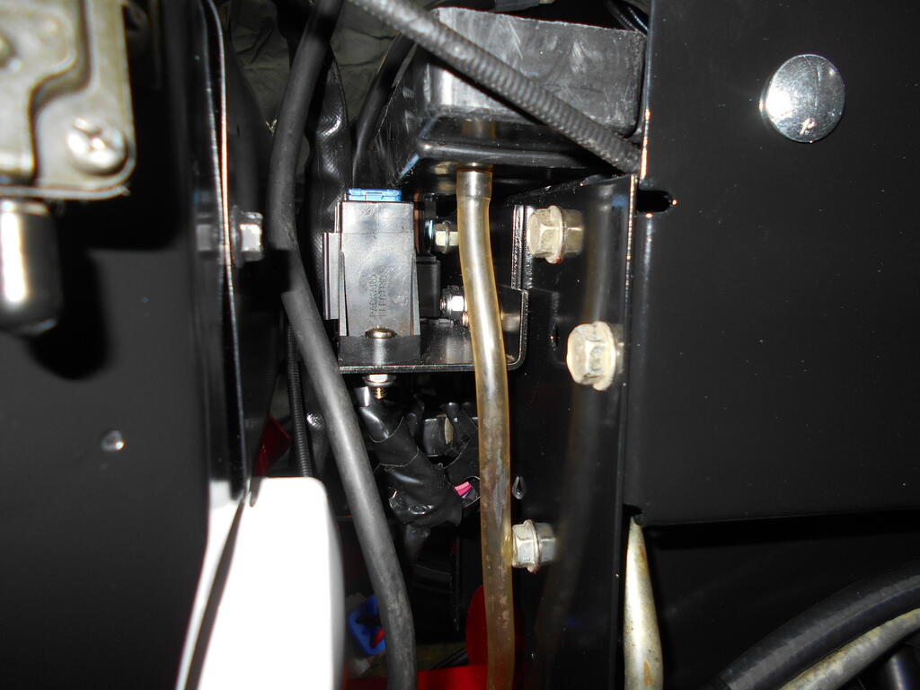

cleat 9,093 #3 Posted June 5 Here are all the pics I could find of the tube in my last rebuild. + I'm not sure about the size offhand but if you take your battery tray in you should be able to find a tube that fits the nipple coming out the bottom of it. That said, I don't usually bother installing this tube but since this tractor had it I installed it. 1 2 Share this post Link to post Share on other sites
eric8 8 #4 Posted June 5 Excellent photos, thanks! I assume since yours was still there, the clear looking tube is original. I would have never got the routing correct without those pics. i have a lead acid battery with the caps so id like to have the drain. Share this post Link to post Share on other sites
