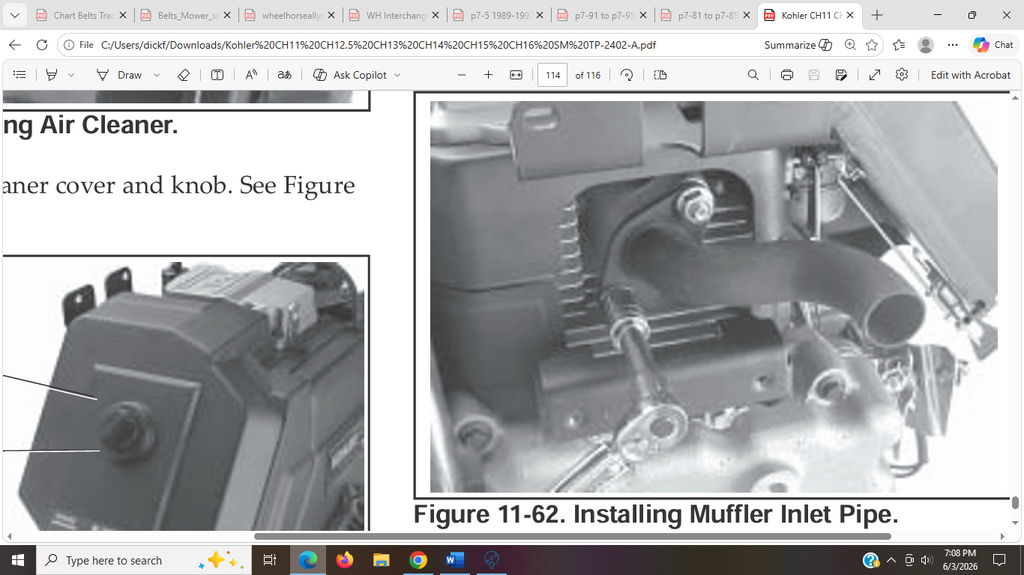

Bob3148 1 #1 Posted June 3 I am looking for muffler options for a 2000 Wheel Horse 314-8. Mounting is 2 3/8” on center posts. Share this post Link to post Share on other sites
Achto 32,537 #2 Posted June 3 (edited) 1 hour ago, Bob3148 said: Mounting is 2 3/8” on center posts. It should also have 1" pipe thread inside. You can use the threaded portion to install a pepper box style muffler. One source. https://www.amazon.com/Oregon-35-006-Muffler-Replaces-Stratton/dp/B0018U04WK/ref=pd_lpo_d_sccl_2/142-7460308-9253862 Edited June 3 by Achto Share this post Link to post Share on other sites
953 nut 68,867 #3 Posted June 3 5 hours ago, Achto said: should also have 1" pipe thread inside. Dan, this is a newer Kohler Command engine, no pipe thread. 7 hours ago, Bob3148 said: I am looking for muffler options for a 2000 Wheel Horse 314-8. Mounting is 2 3/8” on center posts. Depending on the outside diameter of the muffler inlet pipe you could probably use a Gravely muffler, it has a 1 5/16 inside diameter and is reasonably quiet. 1 Share this post Link to post Share on other sites
Bob3148 1 #4 Posted June 4 23 hours ago, Achto said: It should also have 1" pipe thread inside. You can use the threaded portion to install a pepper box style muffler. No threads but I suppose I could tap it. One source. https://www.amazon.com/Oregon-35-006-Muffler-Replaces-Stratton/dp/B0018U04WK/ref=pd_lpo_d_sccl_2/142-7460308-9253862 1 Share this post Link to post Share on other sites
