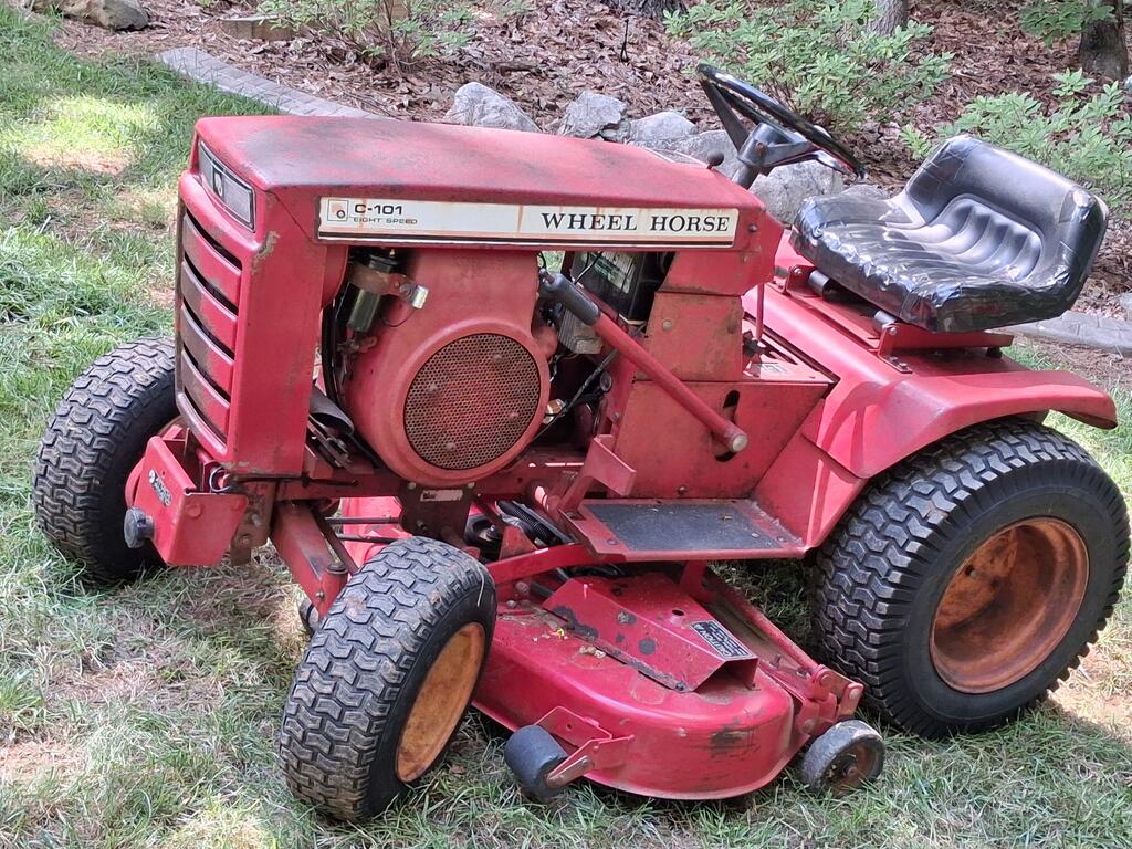

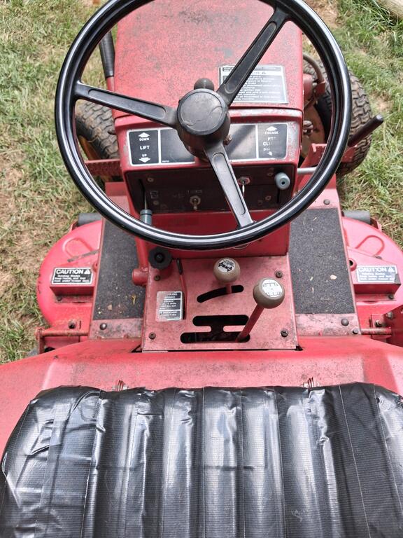

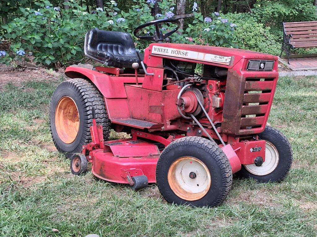

John c 197 #1 Posted June 2 Here's some pictures of the C101 I found earlier this year on FBMP, a little more than an hour from home too. It came with a 42"RD deck that looks better than the one a rebuilt last fall, so I swapped all the new parts over from one shell to the other and now have VGC spindles to make another serviceable 42"RD, just won't have the old patina, but it's not rotted out. I really have enjoyed going through this machine. I cut some grass with it yesterday and probable cut some more today or tomorrow. I runs smooth and strong, it's weathered and solid I went with penetrol and steel wool finish refurbish and I like the OG survivor look. 11 7 Share this post Link to post Share on other sites
953 nut 67,355 #2 Posted June 2 Looks like there was a hot time under the hood at one time, if only they could talk ant tell their story. 4 Share this post Link to post Share on other sites
oliver2-44 11,618 #3 Posted June 2 2 hours ago, 953 nut said: Looks like there was a hot time under the hood at one time, if only they could talk and tell their story. Nice seat repair too 2 Share this post Link to post Share on other sites
Achto 32,093 #4 Posted June 2 (edited) Nice Tractor 21 hours ago, 953 nut said: Looks like there was a hot time under the hood at one time One thing that I've noticed with a Nelson muffler on that style of tractor. It's difficult to find the happy spot between being too close to the points or being too close to the hood. The B100 that I recently picked up had the muffler way too close to the points cover, actually damaged the points under the cover. I think I have it centered good now, time will tell. Edited June 3 by Achto 3 Share this post Link to post Share on other sites
JoeM 10,081 #5 Posted June 2 49 minutes ago, Achto said: with a Nelson muffler on that style of tractor. It's difficult to find the happy spot And if it leans out a touch there is a Chernobyl effect! 2 Share this post Link to post Share on other sites

ebinmaine 79,630 #7 Posted June 2 2 hours ago, Achto said: Nice Tractor One thing that I've noticed with a Nelson muffler on that style of tractor. It's difficult to find the happy spot between being too close to the points or being too close to the hood. The B100 that I recently picked up had the muffler only way too close to the points cover, actually damaged the points under the cover. I think I have it centered good now, time will tell. Not for sure here but I'm thinking the larger can style didn't come out until after the black hoods, which were a larger wider hood. 2 Share this post Link to post Share on other sites
Achto 32,093 #8 Posted June 2 34 minutes ago, ebinmaine said: Not for sure here but I'm thinking the larger can style didn't come out until after the black hoods Mine has a smaller can, still tight on room. 2 Share this post Link to post Share on other sites

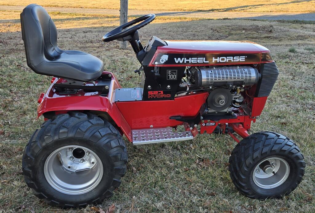

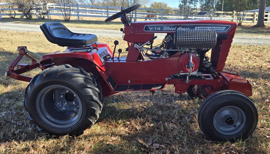

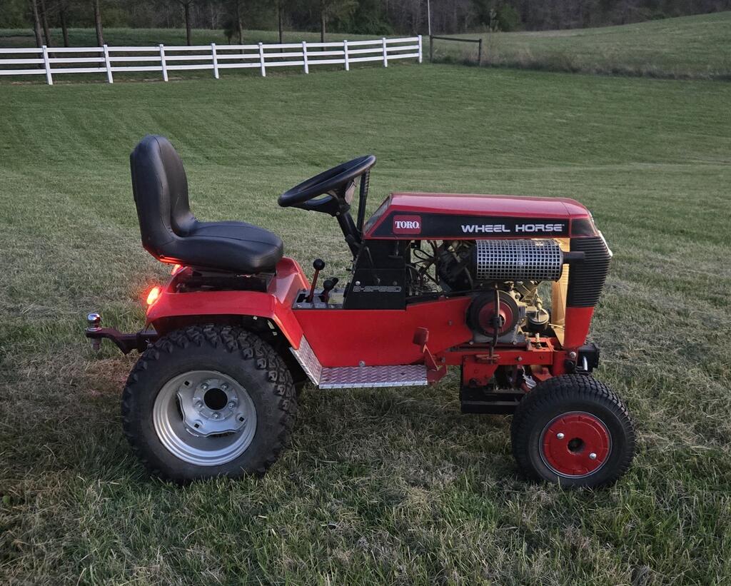

ebinmaine 79,630 #9 Posted June 2 Just now, Achto said: Mine has a smaller can, still tight on room. Yeah they definitely are. Not a fan of it. That's why on the last several tractors I've built you can see where I've switched over to the exterior mounted Gravely Muffler that points down and forward. I don't like the look quite as much but I think it's more practical. 2 1 Share this post Link to post Share on other sites

squonk 47,358 #12 Posted June 3 (edited) 18 hours ago, Achto said: Nice Tractor One thing that I've noticed with a Nelson muffler on that style of tractor. It's difficult to find the happy spot between being too close to the points or being too close to the hood. The B100 that I recently picked up had the muffler only way too close to the points cover, actually damaged the points under the cover. I think I have it centered good now, time will tell. My muffler on my C-160 actually holds the hood from opening too far! Edited June 3 by squonk 1 Share this post Link to post Share on other sites
Retired Wrencher 6,783 #13 Posted June 4 On 6/2/2026 at 8:46 AM, 953 nut said: Looks like there was a hot time under the hood at one time, if only they could talk ant tell their story. 953: I had a C141 one time and it had that same problem. So I went to see my dealer when they were in business with wheel horse he told me it’s probably because the engine was not in tune which created overheating and it bake the paint. And the other thing with the cradle mount to me that seemed to be a power robber with that big 14 shaken all over the place. This is just my two cents. 1 Share this post Link to post Share on other sites

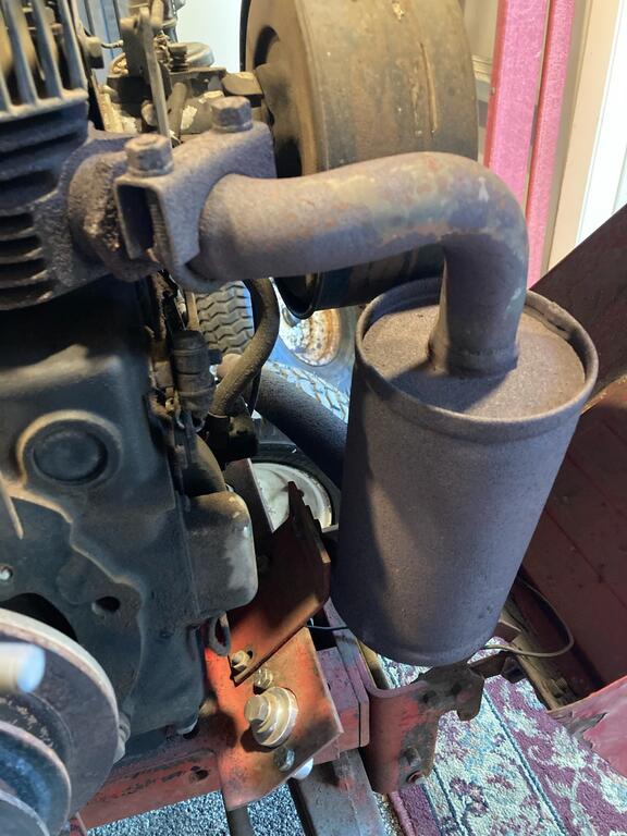

ineedanother 2,577 #14 Posted June 4 I have an essentially unmolested black hood 165 and it's tough to see in this pic but the Nelson is anchored to the shaker plate with not much room to get creative Share this post Link to post Share on other sites

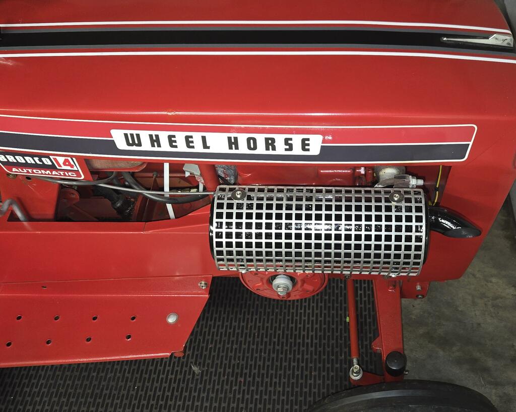

kpinnc 18,736 #15 Posted June 5 I don't care what is technically correct on the muffler mount. Mine go outside the hood where they won't trap all that heat. 3 Share this post Link to post Share on other sites
