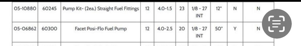

FLtractor 198 #8 Posted June 3 21 hours ago, pfrederi said: What pressure fuel pump did you use. It may have over powered the float valve in the carb. How did you verify spark? Was the plug wet after you cranked it for a while. May be really badly flooded. 4-1.5 psi. I believe the same one you recommended to me which you mentioned never having a Problem. With the 2 straight fittings. used spark plug light bulb tester to Verify spark. didnt pull spark plug after. Was getting dark and went in for evening. Share this post Link to post Share on other sites
