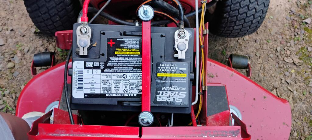

I decided to start out with a new AGM battery for a base.  I went with the "Too much is just right" line of thought and dropped in a car battery.  I donated the old battery to my Lowe's rider. The plastic tray under the battery just touches the hyro control linkage rod. I had some nice battery clamps laying around from another project and they worked perfect with the D's battery cable terminal ends.  After running for an hour a full throttle it showed 14.5+ volts.  I still have a bunch of stuff to check out on the electrical side and now the Onan seems to have developed a lean condition as it only likes to run with the choke on.  Fuel pump, filter, intake, carb all need a look.  I don't know much about these Onan's.  I took a service school on them many years ago but I've slept since then.
