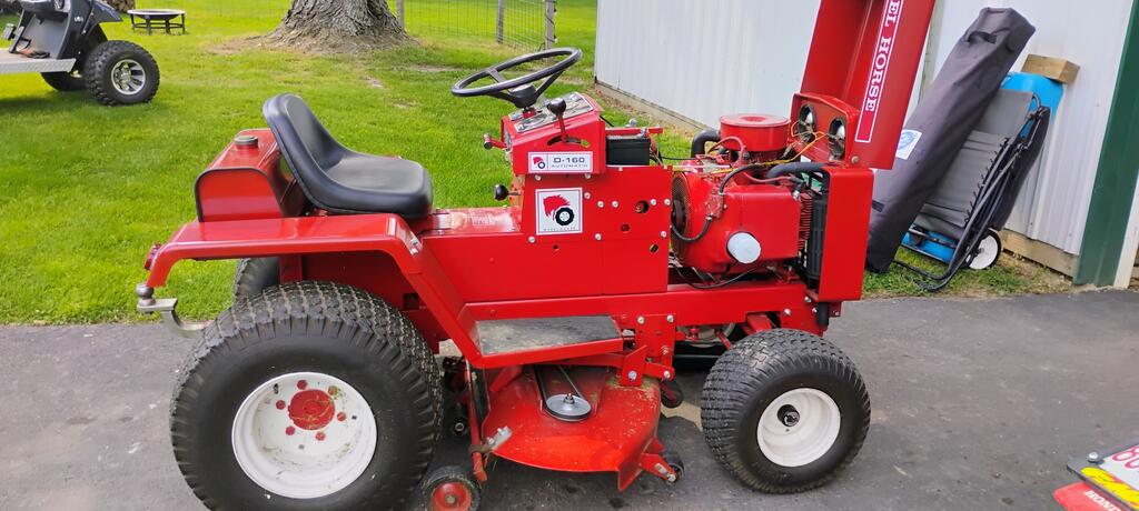

wfopete 59 #1 Posted June 1 Looking at a D160. I plan to see it up close, pictures show it to be in very nice condition. I'm concerned about if later model decks and other attachments will work with these units. Also what areas should I be checking close with this model? Share this post Link to post Share on other sites
pfrederi 21,145 #2 Posted June 1 D 160-200 attachments are unique to that series. Decks, Blowers and plows from C 300/400 series will not fit There are two versions of D160 some came with Kohler K341 other with a twin onan. 2 4 Share this post Link to post Share on other sites
wfopete 59 #3 Posted June 1 That's good to know. Parts availability is important for the long term; are parts like finding hen's teeth? Are there any reliability issues with these. Ideally I was looking at the 300 series but this D160 popped up on FB claiming it was restored. Priced at $1800 so I don't want to go into this without some knowledge on the model. Share this post Link to post Share on other sites
pfrederi 21,145 #4 Posted June 1 Restoration can mean a lot of things ranging from a quick wash and a bit of paint to overhauled engine and hydro. Personally I would much prefer the Kohler, parts for that are plentiful Onans not nearly as much. Onan has an electric PTO not sure about parts for that. Big thing is to test the hydro. Get it warmed up there may be a hydro temp gauge to check that. Then put it up against an immovable object and see if it will dig holes with rear tires. What are you planning on using it for. They are big heavy not the most maneuverable tractor overkill for lawn mowing.... Share this post Link to post Share on other sites
wfopete 59 #5 Posted June 1 (edited) Id rather stay away from the Onan too. I'm not a hydro fan either but if unit is solid I could live with it. I have not seen a D series up close so I can't appreciate what it is or isn't. What years was the D series produced? Edited June 1 by wfopete Share this post Link to post Share on other sites
pfrederi 21,145 #6 Posted June 1 (edited) First year it was only an 18 hp and called 18. 1973 last year was 1981. Not much changed over the years. Some modifications to the motion control and parking brake setup. The are heavy over 1000 lbs. I would ask again what you are planning on doing with it. I have a D200 but it has an FEL. If you want to add a rotor tiller or 5' finish mower you have to add a rear PTO unit and 3 pt hitch. D160 did not come standard with 3pt hitch or rear PTO they were an option. Edited June 1 by pfrederi 3 Share this post Link to post Share on other sites

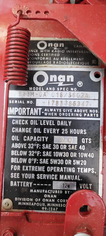

wfopete 59 #16 Posted June 8 Put a bit of time on the 160 and for now it seems "Ok". However I have a couple of questions: 1. Any recommendations on where to source a crankcase breather rebuild kit for the B43 Onan? 2. In regards to the Electric PTO How tight is too tight? 3 Are there any modifications that would results in better clutch performance? On it's maiden voyage my "New to Me" D160 didn't want to cut grass well unless it was a light cut. The belts are new. I went through a hay field at various cutting heights and speeds to evaluate where/what was the problem. I didn't detect any slippage from the belts in the form of squealing or burning but the pulleys slowed down the minute I got into a 2"-3" (or deeper ) cut. The charging system is throwing more than 13.50V to the battery @ WOT so I'm hoping the clutch is seeing plenty of juice but I still need to check that. Measured at .026"+ at the three measuring points. Tightened all four plate nuts about 1/2" turn and closed the gap to .003". Is .003" too tight? I watched a few E-clutch YouTube videos and it seemed that the thought was tighter is better. After I finished the clutch engaged and disengaged just fine but I did not cut with it yet due to heavy rain here. I'm thinking once it heats up the clearance may go away and it won't dis-engage well. I don't know what clutch is on the 160; attached is a picture of a painted over label on it. Share this post Link to post Share on other sites
pfrederi 21,145 #17 Posted June 9 WH didn't spec an air gap on the older Electric PTOs used on Chargers GT14. For later PTO s on Vertical shaft engines they spec .005 as minimum. Can't find anything about the PTO on your Onan Share this post Link to post Share on other sites

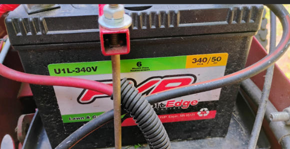

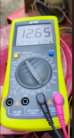

wfopete 59 #22 Posted June 10 While I have not got my my hands on my buddy's multi-meter (Mine can only handle a 10A max load), I did do some more testing but it all may mean nothing as the battery is only a little 340 CCA unit with roughly a 35AH rating. So probably just the minimum for this tractor. Anyway the static voltage (engine off) of this battery is ~12.65v and at WOT ~13.65 with only the engine running. I'm fine with the voltage of 12.65 but the charging voltage is a little light. Once I engage the E-clutch voltage starts falling into ~13.30 area with the amperage reading dropping to the 3-4A so if the dash Amp gauge in correct the E-Clutch draw is in the ballpark. Strangely, I get a much larger amp draw when I turn on the lights (5A+) compared to the E-Clutch's 3-4A. I did take a few passes on my lawn this morning the cut seemed better but it doesn't count as the grass was still a wet. So I'm off to get a fresh battery while the grass has a chance to dry out. Share this post Link to post Share on other sites
Handy Don 17,467 #23 Posted June 10 Good news on the clutch current draw. Likely no shorts. Yes, a low voltage does lessen the clutch’s “gripping” force somewhat but a volt or two isn’t going to be a huge factor. I’d be more concerned that the clutch faces are glazed. Incandescent PAR headlights can easily consume 5 amps--or more with a corroded or rusted contact in the circuit. Are you confident that ALL of the wiring and grounds are clean and offering no resistance. I’d pay particular attention to the connections to the regulator. The battery you have, especially if it is not having trouble starting the engine, might be the last thing I’d change. It seems adequate. Share this post Link to post Share on other sites

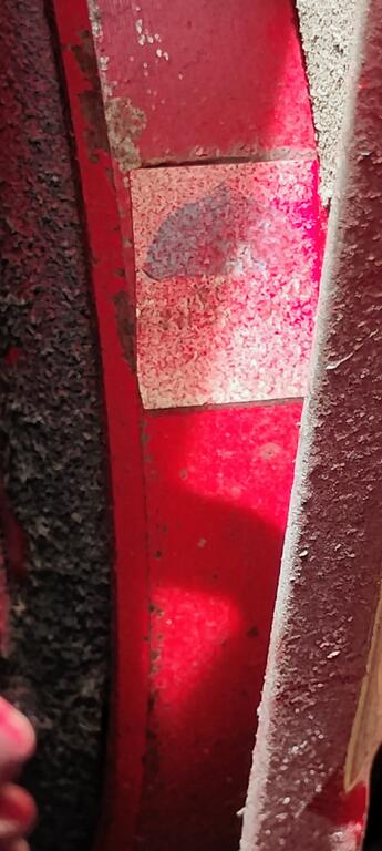

wfopete 59 #24 Posted June 10 The clutch faces may very well be glazed based on the excessive clearance I found. Dang I really don't want to pull that apart right now. The PO (seller) went though all the wiring with many new ring terminals for grounds. I have not dug into the wiring deep but from what I've seen it all looks clean and secure; new wires with no splices or sub standard work that I've seen...yet. I'll check the v/r tomorrow. Of course all it takes is a freshly painted surface for a poor ground and the hunt is on. On a separate note; I did a compression check this morning and got a little over 90psi out of both Onan cylinders at wot. Have not checked the valve clearance yet. 1 Share this post Link to post Share on other sites
Handy Don 17,467 #25 Posted June 11 6 hours ago, wfopete said: Of course all it takes is a freshly painted surface Like many here, I learned this lesson the hard way. After that, I test the electricals as I go with assembly and, again like others, I've become a fan of direct-wired grounds for many circuits. Share this post Link to post Share on other sites
