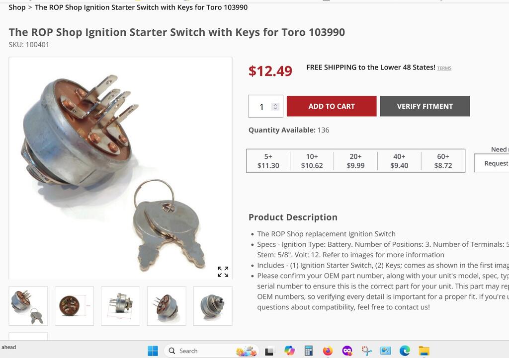

pfrederi 21,150 #2 Posted June 1 (edited) It is a very expensive heavy duty switch. You might want to consider a regular switch 103990 (if you have battery ignition) and add 12v solenoid. Edited June 1 by pfrederi 2 1 Share this post Link to post Share on other sites

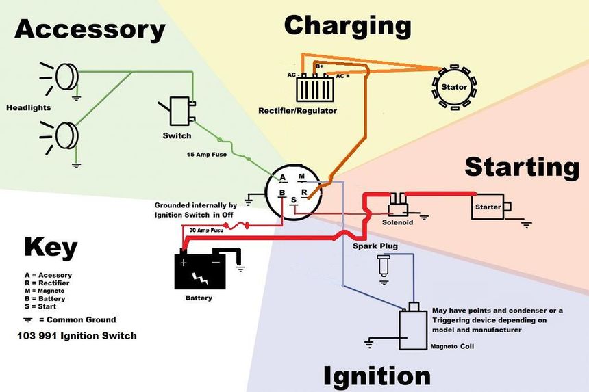

squonk 48,119 #5 Posted June 1 (edited) 39 minutes ago, kbert1171 said: Sounds like my only option at this point. So, will I run the starter wire to the solenoid, and another wire from it to the starter? And then what about the other wires? Where will they go on the new switch? Thank you for the help. (How expensive is expensive? It'll probably last for the rest on my life at this point. And it might be worth the money to not have to rewire the switch and add a solenoid somewhere.) Depending on what type of coil you have. But this is the magneto style diagram, If you have a battery ignition the switch should have an I instead of an M Battery ignition: Edited June 1 by squonk 3 Share this post Link to post Share on other sites

Handy Don 17,474 #7 Posted June 1 (edited) 6 hours ago, kbert1171 said: Sounds like my only option at this point. So, will I run the starter wire to the solenoid, and another wire from it to the starter? And then what about the other wires? Where will they go on the new switch? Thank you for the help. (How expensive is expensive? It'll probably last for the rest on my life at this point. And it might be worth the money to not have to rewire the switch and add a solenoid somewhere.) I put a new high amp ($50 at the time) Cole Hersee switch on my similar vintage K181. It lasted only three years and was getting testy before it died. Starting uses a lot of current, especially the older spark-retard engines starting against full compression. High Amperage: Cole Hersee 95521-01-BX (orig. Part No. 4988 superseded by 7263) Low Amperage: Toro 103990 I “switched" to the low amp switch with a solenoid like @ri702bill. No longer have the heavy wiring straining against the ignition switch connectors. Two years so far and smooth sailing. The switch plus solenoid plus some wire cost about the same as the high-amperage switch. Edited June 1 by Handy Don 1 2 Share this post Link to post Share on other sites

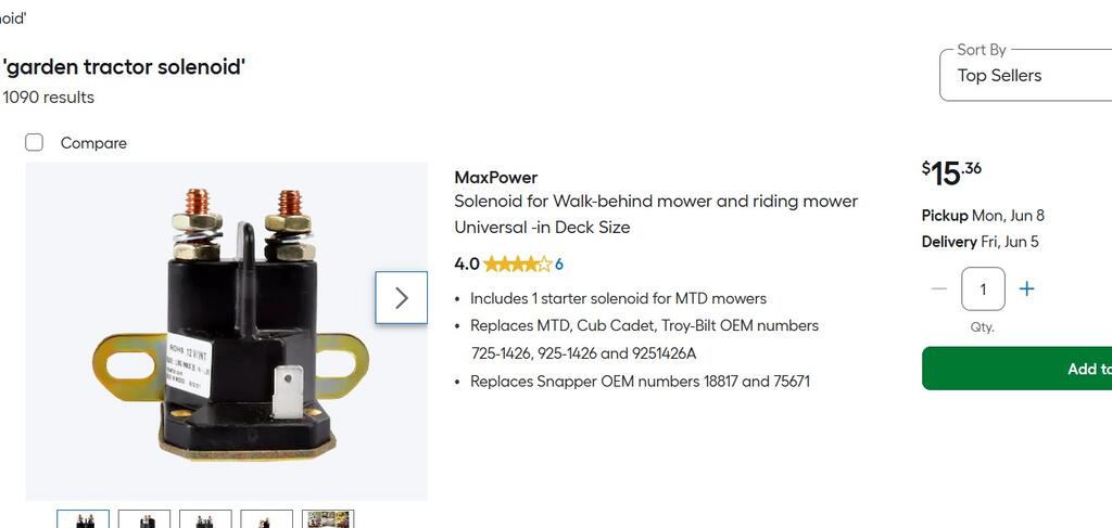

Handy Don 17,474 #10 Posted June 3 (edited) I used a Stens 435-435 Starter Solenoid and the 103990 ignition switch. Modest prices for good quality. Solenoid had several mounting flanges which gave me flexibility. I cut off the ones I didn’t use. I also redid the heavy wiring (ground and positive) with new 6ga stranded cable and new lug ends. Just to be clear, my tractor’s engine had battery ignition, NOT a magneto--the switch and some wiring differ between the two but neither is especially complicated. Edited June 3 by Handy Don Share this post Link to post Share on other sites

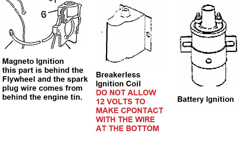

kbert1171 2 #11 Posted June 3 Okay. So how do I differentiate between the two types, battery and magneto? Share this post Link to post Share on other sites
953 nut 69,296 #12 Posted June 3 If you have a little round thing with a plug wire coming from it you have a battery powered ignition. 1 Share this post Link to post Share on other sites
pfrederi 21,150 #13 Posted June 3 12 minutes ago, kbert1171 said: Okay. So how do I differentiate between the two types, battery and magneto? That is important. Raiders of that era could have Battery Points, Magneto or possibly breakerless ignition systems. How to tell: if the spark plug wire comes from a can shaped coil battery points. If it just comes from under the air shroud magneto. If it comes from a triangular shaped box breakerless Batter point yo need ignition switch with an "I"Terminal Magento Breakerless "M" terminal Share this post Link to post Share on other sites
953 nut 69,296 #14 Posted June 4 Battery ignition will use a 103990 switch and the Magneto and Breaker less will use the 103991 switch. 1 Share this post Link to post Share on other sites
kbert1171 2 #15 Posted June 4 Okay. Just checked and it's breakerless, so the 103991 is what I'll need. Thank you all for the information. I really appreciate your help. 1 Share this post Link to post Share on other sites
