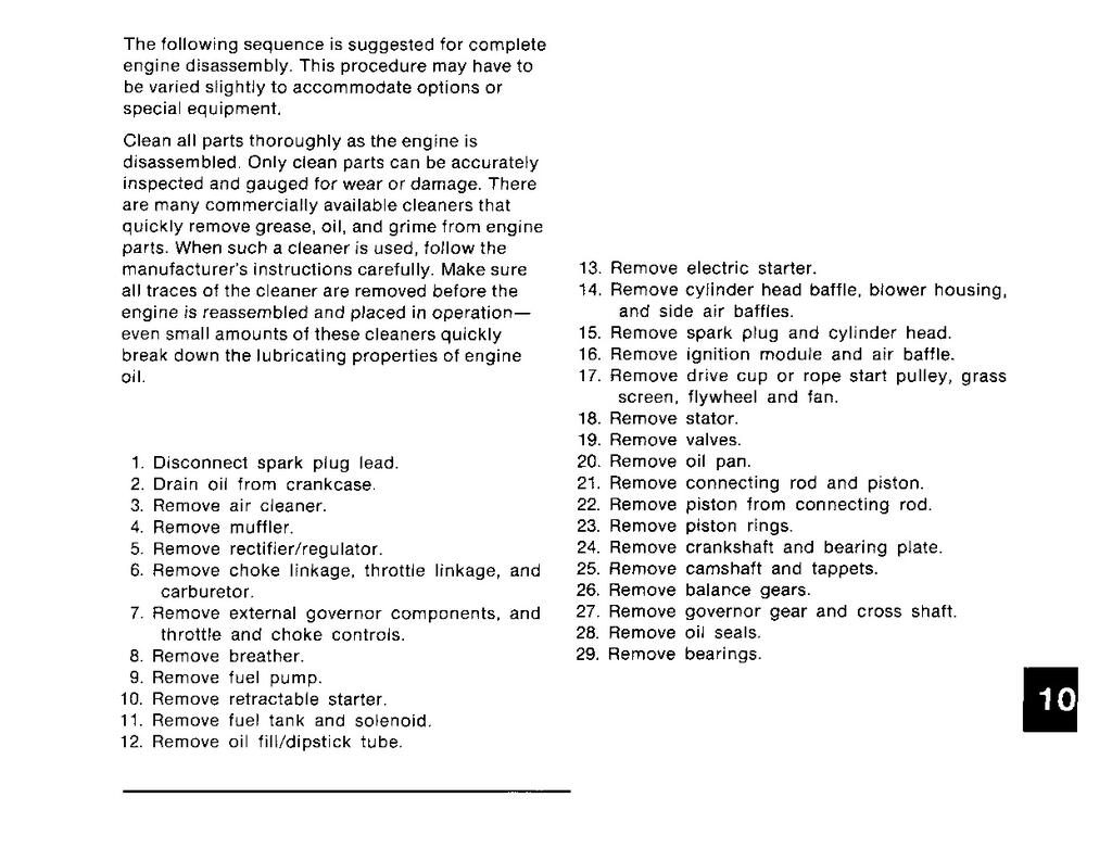

oldlineman 1,809 #1 Posted May 30 Just a quick question, do you have to remove the oil fill dipstick tube in order to remove the starter? 1989 c-414, kohler M 12. Thank you Share this post Link to post Share on other sites
953 nut 69,304 #2 Posted May 30 Yes, though someone on here has probably managed to do so without removing it. Now that I have given a definitive answer somebody has to controdict it. 1 Share this post Link to post Share on other sites
gwest_ca-(File Mod) 12,488 #3 Posted May 30 Took a while to find it. #12 & #13 1 Share this post Link to post Share on other sites

Ed Kennell 47,328 #7 Posted May 30 6 hours ago, oldlineman said: Just a quick question, do you have to remove the oil fill dipstick tube in order to remove the starter? 1989 c-414, kohler M 12. Thank you Yes, and due to the tight clearance to the starter 12v. lug, I install a rubber sleeve on the fill tube to provide insulation. 1 2 Share this post Link to post Share on other sites
