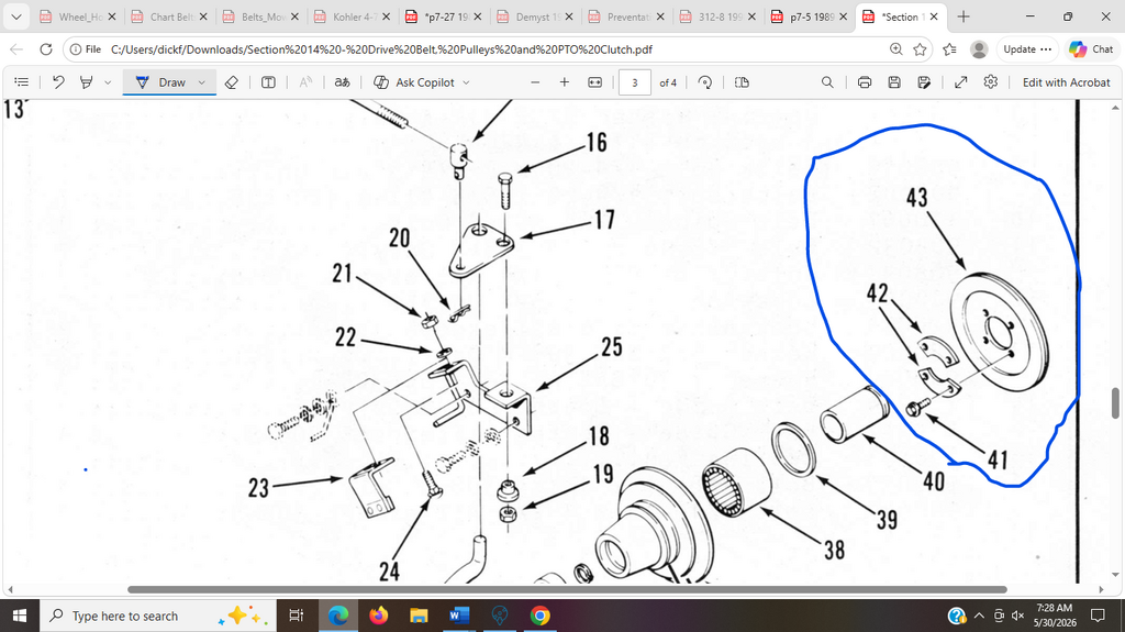

Duddy 7 #1 Posted May 30 I changed the clutch fiber disk put everything back the way it came off. After running it for and a 1.5 hours the bolts all backed out. Does anyone know why this could happen. Share this post Link to post Share on other sites
ol550 880 #2 Posted May 30 Did you install the 2 lock plates and bend them to lock the bolts? 3 1 Share this post Link to post Share on other sites
JoeM 10,318 #3 Posted May 30 Clean the bolts and threads up with carb cleaner and put a spot of blue removable locktite on each bolt and reinstall, 8 ft lbs torque. 2 2 Share this post Link to post Share on other sites
953 nut 70,649 #4 Posted May 30 Those plates were intended to distribute the torque across the disc. 2 Share this post Link to post Share on other sites
ri702bill 13,391 #5 Posted May 30 46 minutes ago, 953 nut said: Those plates were intended to distribute the torque across the disc. AND to retain the inner race sleeve #40..... 5 Share this post Link to post Share on other sites
Duddy 7 #6 Posted May 30 Yes I did put those plates on and I might forgot to add blue lock tight. Could that be the only problem is I forgot lock tight. 1 Share this post Link to post Share on other sites
kpinnc 19,107 #7 Posted May 30 51 minutes ago, Duddy said: Yes I did put those plates on and I might forgot to add blue lock tight. Could that be the only problem is I forgot lock tight. Most likely. I've never had any loosen that had loctite on them. One thing of note: make sure the retaining plates are nice and flat. Sometimes overzealous folks apply too much torque and bend them. If they have a bend just lie them on flat steel and tap flat with a hammer. 1 1 Share this post Link to post Share on other sites
squonk 48,427 #8 Posted May 30 I never had any loosen without Loctite. 1 Share this post Link to post Share on other sites
Duddy 7 #9 Posted May 30 I will have to give it a try when I get the new parts. Since when the bolts came out I lost them. 1 Share this post Link to post Share on other sites
lynnmor 9,081 #10 Posted May 30 I wonder if the clutch plate thickness is different than the dimension from the groove to the end of part 40. Is this an aftermarket clutch plate? Share this post Link to post Share on other sites
Duddy 7 #11 Posted May 30 It could be not to sure. It did fit on the part 40 It did fit snug. Share this post Link to post Share on other sites
