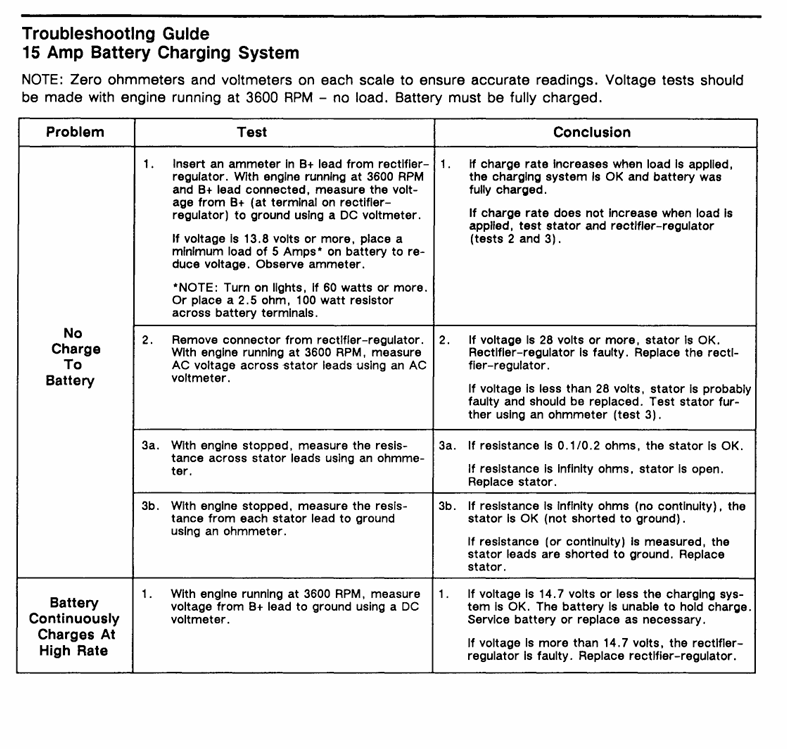

John c 224 #1 Posted May 29 (edited) I've got what I think may be a rectifier given up 1978 C101 8spd. K241 engine battery not charging when running, 12.65vdc when off 12.50vdc when running 12.35vdc running, headlights on Battery is new in good condition, As close to a manual as I have is one for magnum series Kohlers, based on that I read the following: Neither of the stator leads show shorted or grounded, about 2~3 ohms between them, and 34ish-vac output at full throttle. So I suspect the rectifier is at fault is there a chart showing points to test and values to expect to troubleshoot the rectifier ? I've got others laying around, so how interchangeable are they among other sizes engines Also how can you determine what amperage the stator is rated for ? Thanks, john Edited May 29 by John c Share this post Link to post Share on other sites

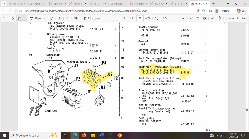

953 nut 70,648 #8 Posted May 30 (edited) Your engine Spec Number shows it being a 1979 K-241 which is correct for the '79 C-101. Going into the K-241 parts manual Groupe 18 (charging and ignition) we find the number 114 applies to all components related to charging for that engine. You have a 15 amp charging system and the parts illustrated below are correct for your engine. We know that your stator is working properly based on the test you have done. Your voltage regulator / rectifier should be a 15 Amp unit. It has three tabs in an "L" pattern. I have attached a link to the parts manual for you. Edited May 30 by 953 nut add photo 2 Share this post Link to post Share on other sites

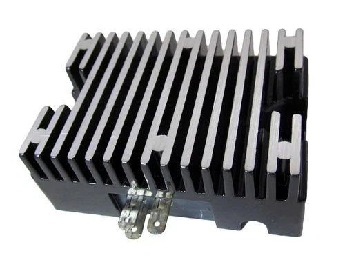

pfrederi 21,342 #11 Posted May 30 Sounds like time for a new rectifier.... 2 Share this post Link to post Share on other sites
John c 224 #12 Posted May 30 that's what I'm thinking too, How much interchangeability is there among these things, I've got several on hand, I suppose they're rated in amps or maybe watts ? Anybody know ? Since the plug configuration is dependent on the rating, maybe anything with an "L" shape plug should be compatable ? I'll dig through the junkyard in a little while and see what I have 1 Share this post Link to post Share on other sites
pfrederi 21,342 #13 Posted May 30 The big finned ones are usually either 10 or 15 amp just match the terminal pattern. 1 Share this post Link to post Share on other sites

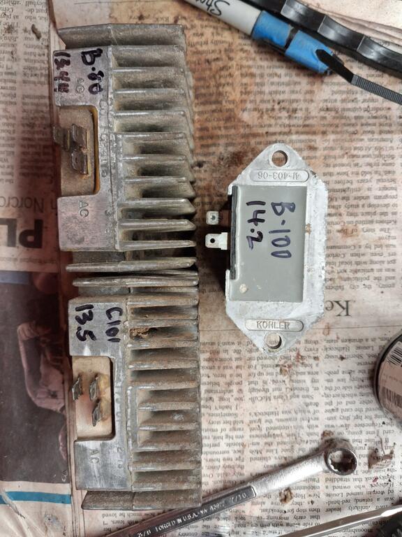

John c 224 #14 Posted May 30 I took one off of a B80 exact look alike, does the exact same thing. Now is probably the perfect time to wonder if the ammeter delete would affect the recifier..... Share this post Link to post Share on other sites

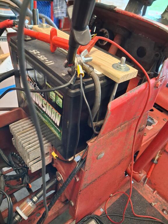

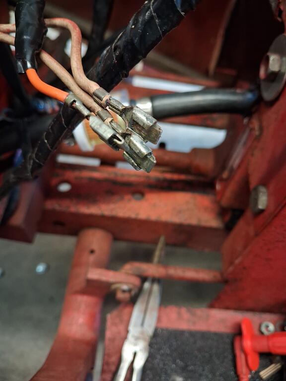

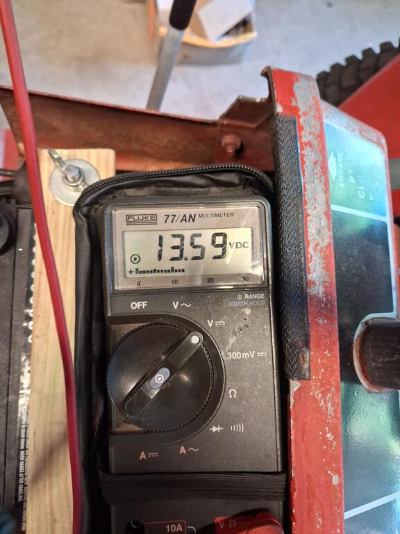

John c 224 #19 Posted June 2 well, I was able to figure this thing out, turns out the connections at the rectifier was the issue. I got my 314 in the shop and used it as a base to verify and eliminate, once I remade the connections I got it back to 13.6vdc at full throttle. While I was at it I tested 2 other unit I have to verify they work. I think I may want to take it back out, find some dremel bits and get a proper and thorough clean on the rectifier stabs, solder some pigtails on it then splice them back into the harness. Poor boys battery tester showed me my battery may still has some guts in it, after 4 15second crank cycles, it was holding at 11.4vdc. After that it ran about 13.65vdc at full throttle and was holding at 13.6 after spending the night plugged into a trickle charger. thanks for your help guys Share this post Link to post Share on other sites
953 nut 70,648 #20 Posted June 2 Del City sells the Packard 56 female connectors and a four terminal block that will slip right over the terminals on your regulator. https://www.delcity.net/store/wire-connectors-quick-splices/packard-56-series-electrical-connectors/female-4-contact/ https://www.delcity.net/store/wire-connectors-quick-splices/packard-56-series-electrical-connectors/female-terminals/ 1 Share this post Link to post Share on other sites
John c 224 #21 Posted June 2 thank you Richard, I couldn't think of what those terminals were called to save my life the other day. 1 Share this post Link to post Share on other sites
