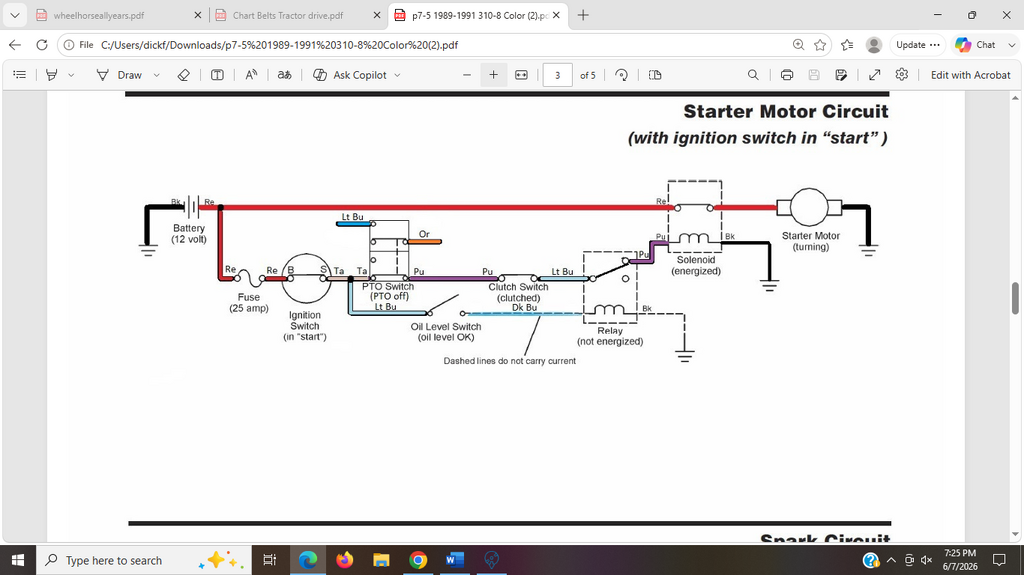

953 nut 70,648 #37 Posted June 7 5 hours ago, BHpa said: I used a small jumper wire to connect the + line from the battery to the terminal on the solenoid that the purple is connected to - this turned the starter over. This proves that the solenoid is functioning properly. The purple wire provides a path FROM the ignition switch to the soleniod if; the 25 Amp Fuse is good, the Key Switch is in the START position. the engine oil level is good, the PTO is not in the operate position, and The clutch is depressed. 1 Share this post Link to post Share on other sites

Handy Don 17,735 #39 Posted June 8 (edited) 3 hours ago, BHpa said: So if all that and the others check out, does it seem likely it's the ignition switch? I'm sorry if I'm asking dumb or obvious questions - I really don't have a lot of experience in all this, just trying to learn as I work through things on my WH. I do greatly appreciate the advice and help. If you’ve followed @953 nut’s sequence and demystification diagram in post #37 with a VOM and found 12V power before and after each and every component (fuse, switch, etc) then a “non-start” is a cosmic mystery. HOWEVER, if the very first place in the sequence where you do not see power is on the S terminal on the ignition switch (while the key is being held in the “start” position, of course) then you can begin to assume a problem with the ignition switch. I”m assuming here that you have and know how to operate a volt-ohm meter in VDC (volts DC) mode and are connecting the Minus/Gnd/Ground/Black lead to the negative/minus battery terminal and the Plus/Positive/Red lead to each location in the wiring in the sequence shown under the stated conditions (key to start, clutch disengaged, PTO disengaged, oil level OK). Also assuming that you are proceeding sequentially and not trying to jump around making guesses. Edited June 8 by Handy Don 1 1 Share this post Link to post Share on other sites

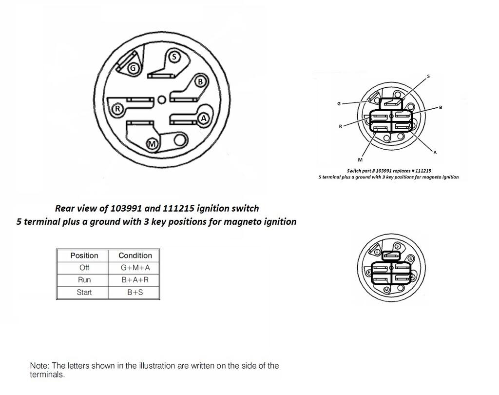

gwest_ca-(File Mod) 12,557 #40 Posted June 8 A simple 12 volt test light is my first weapon of choice with a problem like this. Usually you can probe the wires at the rear of the ignition switch without disturbing the connector. By following the illustration of the rear of the ignition switch using the one two two terminal positions you can identify the circuit you are after. Then just follow the diagram through each component to get to the intended destination. 1 1 Share this post Link to post Share on other sites

Handy Don 17,735 #43 Posted June 17 (edited) On 6/8/2026 at 5:07 PM, BHpa said: So I unhooked them and then tried to jump the two wires he mentioned (B & S) - that's when it wouldn't do anything. Is this the correct way to do it? Again, I'm sorry if I'm asking dumb questions. As you can see from the diagram, pulling the B wire off stops power from the battery getting through the fuse to the ignition switch. You didn’t include a picture, so I’m assuming that your ignition switch wiring has all of the wires in a “ganged” connector that then simply presses onto the ignition terminals. Yeah, this can make troubleshooting harder! One pretty simple option is to pull off the connector, wrap the stripped end of a length of thin insulated wire two turns around the base of each of the B and S switch terminals (taking care to avoid having them touch each other, another terminal, the switch case, or any part of the tractor). Label each wire with the terminal it’s connected to and then put the connector back on (it won’t go all the way but it’ll go far enough to make contact. Now you can use your VOM to see what’s happening at each terminal by touching it to the other end of the thin wire connected to the terminal. You can use the same trick at the other connectors if your VOM probe can’t reach them Edited June 17 by Handy Don 1 Share this post Link to post Share on other sites

gwest_ca-(File Mod) 12,557 #45 Posted June 17 If you go to the colored wiring diagram I linked you to earlier the rear of the ignition switch is illustrated. The unique one two two of the connector cavities allows one to identify the individual wires without removing the connector from the switch or even knowing what colors the wires are. Your switch may be upside down but the one two two still applies - just rotate the drawing to match your switch position. Share this post Link to post Share on other sites
