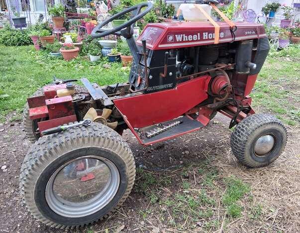

nyquil junkie 333 #1 Posted May 28 This is the 314A I got in that auction I posted about elsewhere. I got the steering hammered out, figured out the starting issue, a few dirty grounds and a clutch safety and now it starts fine w the key. So I go to take it for a good ride, and it started out ok but within 50 feet, it stopped, got slow, wouldn't move, grabbed a bit, jerked a little, moved along slowly.... would hardly pull itself up a grade. Ugh. I was taking it to another driveway to take it apart and clean it anyway, so I see the little reservoir under the seat is nearly empty. I looked up the spec, filled it with 10w30 as its all I had, close enough until its changed. I worked it back and forth a while, some bubbles worked out, but its still as weak and a sick kitten. I jacked up the rear and let it run a while in rev and fwd. You can stop the wheels with your hands at full engagement. After about 15 min of shifting and running, its still barely moved the tractor at full engagement. This is bout where my pay grade ends. Is there something else I can try here? I'm not gonna replace the pump or anything heroic, I can part it out or something if its shot but I had planned to sell it off as a whole working tractor.... oh well. What are my options here.... Share this post Link to post Share on other sites

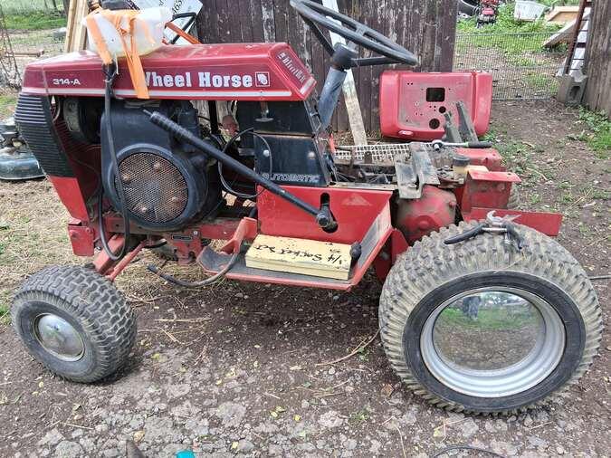

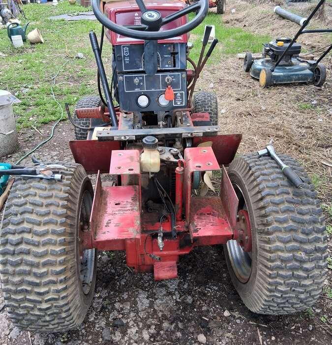

nyquil junkie 333 #2 Posted May 28 A few pointless pics... Share this post Link to post Share on other sites

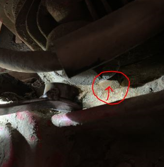

kpinnc 18,940 #15 Posted May 29 2 hours ago, Handy Don said: If you choose to drain/refill, look closely at what comes out. This may have already been mentioned, but I do not see it. One of the primary differences between the 700 and 1100 series transmissions is that while the 1100 shares oil with the gearbox through the charge pump and filter circuits, the 700 does not. Draining the gearbox with the plug on the bottom of the gearbox will not affect the oil in the pump. The pump itself had a seperate and isolated oil supply. Look for the drain on the bottom of the pump itself. Share this post Link to post Share on other sites
Handy Don 17,467 #16 Posted May 29 2 minutes ago, kpinnc said: Look for the drain on the bottom of the pump itself. Yep, excellent callout, KP. And it is a PITA to get to and almost impossible to capture the draining oil. Share this post Link to post Share on other sites

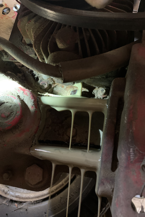

nyquil junkie 333 #17 Posted May 31 Getting that drain plug out nearly cause me to park it for scrap...jeeze. I got it out, what came out was perfectly fine, clean oil. So I refilled it thru the top plug where that tank hooks to, worked all the bubbles out. Put it all back together. It seems to go pretty well now, a lot better than it was. I dont have time today to take it on a run out in the field and up some hills but I think it'll be ok. It doesn't back up real fast but I imagine thats kinda normal. It must have been 5 min to quitting time when they designed that drain plug location. 2 Share this post Link to post Share on other sites
