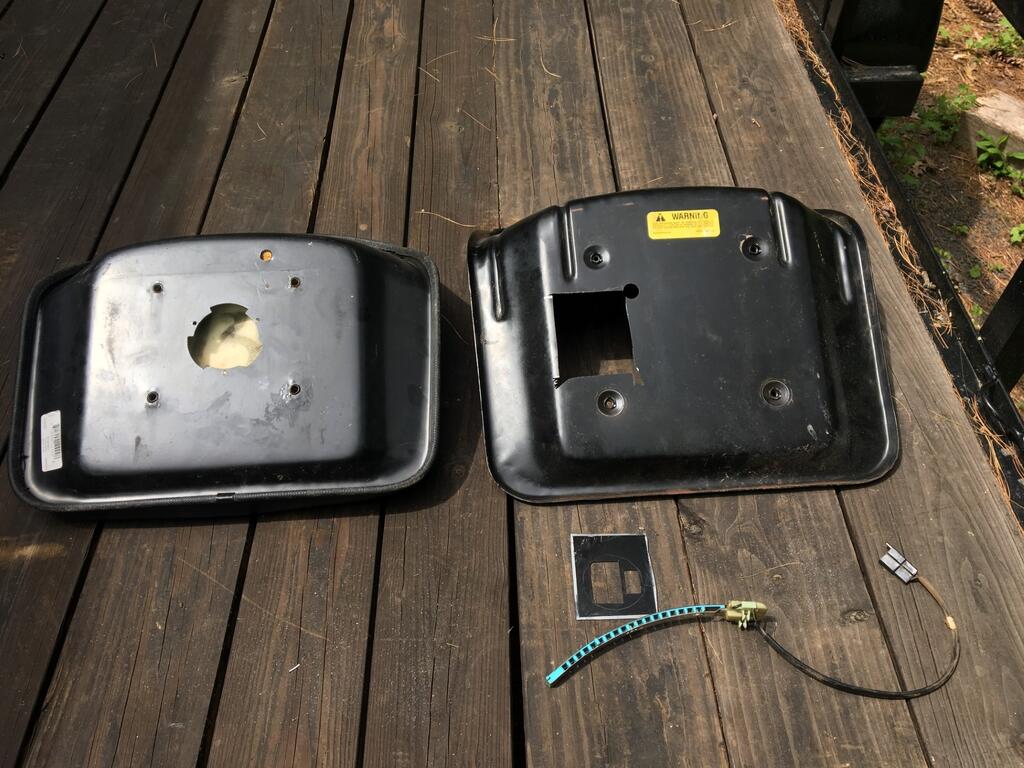

When I bought the tractor, there were a few electrical anomalies.  One was that it would only start with the PTO engaged!  I figured that someone had reversed the lockout switch connections.  I checked the schematic and saw that there were two micro-switches involved, one using the NO and the other the NC terminals.  Once I took out the battery and got a good look at the switches it was obvious that one of the plastic housings had been broken and the loose F spade plugged onto the wrong terminal. I dielectric greased everything and put it back together.  Problem solved.
Another issue was the seat switch.  It was disconnected and jumpered somewhere down the line.  Normally this wouldn't have bothered me because, on the Troy-Bilt with a hydro drive, once my foot was off the clutch, the tractor stopped.  Like I wrote, I had PTO issues and hated to turn it off and on.  Maybe I was tempting fate, but I mowed in steel-toe boots and always stepped wide of the deck when dismounting to pick up one of the dogs' bones or a branch in my way.
But I quickly realized that the Wheel Horse is an actual tractor.  As long as it is in gear and the clutch is engaged, if you fall out of the seat it's going to keep moving.  I know a few people around here who have lost friends and family on farm tractors that way, so I was planning to reconnect the switch.
My tractor's seat was falling apart.  I found an aftermarket MTD seat for $30, but it used a different kind of switch.  At first, 'cause I thought it would be more elegant (and I'm cheap), I considered adapting the Wheel Horse switch to the new seat by cutting out the WH mounting area and riveting it over a hole on the new seat.  The center hole wouldn't leave enough space for the switch length, so I thought to cut a hole at the side and mount it there.  But the new seat's foam was too tight and that was just a PITA too far.
So I'm going to buy a switch that fits the seat. When I match to the seat's model #, all the switches that show up are square with a big center plunge button.  Nothing that would fit that circle.  Oh well, guess I'll have to make an adapter plate for that!
But back to your suggestions, today as I was troubleshooting I connected the WH switch to its hanging cable, put it up on the seat, and sat on it while I engaged the PTO.  I've checked the switch and know that it's functioning, but I was less than rigorous in my test because I was "sure" of the outcome.
Let me try that again and I will get back to you.

I converted to the early style seat switches in the fender pan, just use the old seat switch assembly to make an adapter. If you cut the wire off the old switch then crimp on two insulated 0.187 female spade terminals it will plug in to the existing harness and connect to an older style seat switch.
