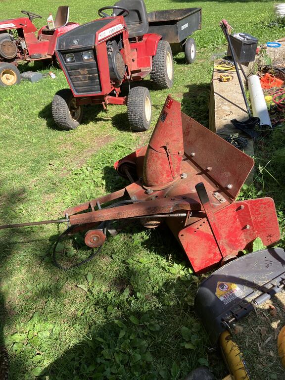

Joshyg 40 #1 Posted May 27 Model-6-6211 Serial-524241 Share this post Link to post Share on other sites
squonk 47,885 #2 Posted May 27 That snowbblower is for the older models with out the front tach o matic Share this post Link to post Share on other sites
Joshyg 40 #3 Posted May 27 Is there anyway I could modify this to fit my front tach o matic Share this post Link to post Share on other sites
Ed Kennell 46,973 #4 Posted May 27 1 minute ago, squonk said: That snowbblower is for the older models with out the front tach o matic It does have the frame mount attachment Mike. But I think the later C models have the two holes in the frame to use this mount. It should work. 1 Share this post Link to post Share on other sites

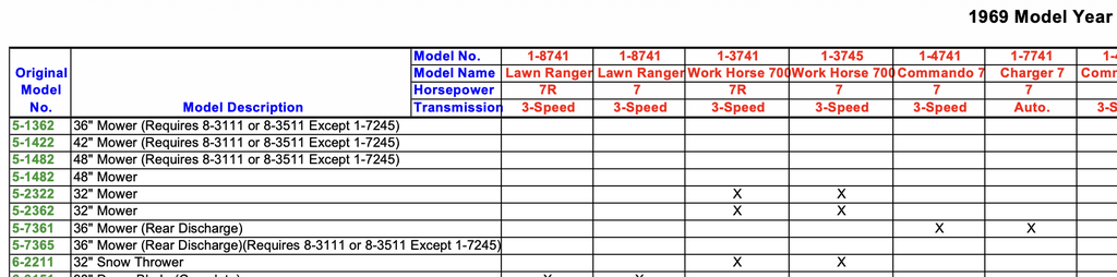

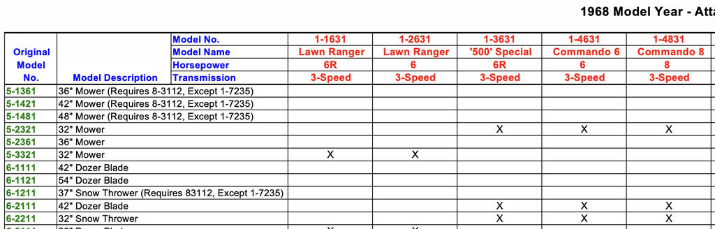

Handy Don 17,305 #5 Posted May 27 18 minutes ago, Joshyg said: Is there anyway I could modify this to fit my front tach o matic Almost anything is possible. Effort and compromises govern practicality. This model, per the interchange chart, was for 1968 and 1969 models that did not have Attach-a-Matic, had short or medium length frames, and may have had the pedal-activated PTO. It also could be used on some earlier 60’s models that used the earlier ST-326 Snow Thrower Factors: - holes in the frame rails to put the mounting bolt through and blower frame fitting around the front attach-a-matic - hood attachment and size for possible interference - PTO style and belt alignment/length - length and fit of lift tube 1 Share this post Link to post Share on other sites

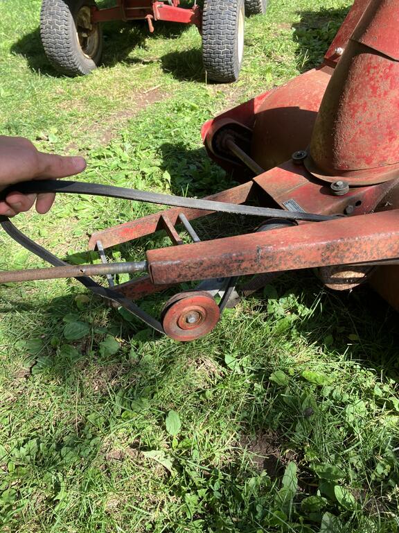

Joshyg 40 #6 Posted May 27 Got the snowblower on and the snowblower works fine with my tractor, but is there anything to lift it so I can lift the entire snowblower up? Share this post Link to post Share on other sites
Handy Don 17,305 #7 Posted May 27 (edited) 23 minutes ago, Joshyg said: Got the snowblower on and the snowblower works fine with my tractor, but is there anything to lift it so I can lift the entire snowblower up? Nice going! Uss the search bar at the top of this page to look in documents or files on this site for “6-2211” or “ST-323”. Look for an IPL (illustrated parts list) and/or an OM (owner’s manual) among the files available. That will include the tube that connects the mid-tractor rock shaft arm to the bottom rear of the blower to lift it. You’ll likely need to fabricate one (or modify an existing one) since you have the thrower on a tractor it wasn’t designed for. Edited May 27 by Handy Don Share this post Link to post Share on other sites

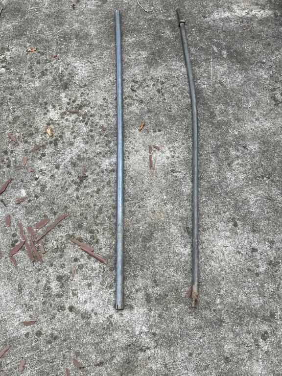

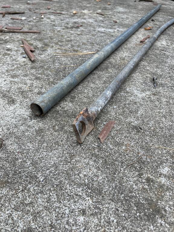

Ed Kennell 46,973 #8 Posted May 27 (edited) I had that same blower on a C-120 and the "Flag and lift rod" worked with a few spacrs. Look around the POs barn. The flag and lift rods are usually standing in a corner. Edited May 27 by Ed Kennell 2 Share this post Link to post Share on other sites
Joshyg 40 #9 Posted May 27 (edited) Is the one on the right a flag and lift rod, and would it be fine if I used the one on the left as a replacement, even though it’s hollow?I Edited May 27 by Joshyg Share this post Link to post Share on other sites
