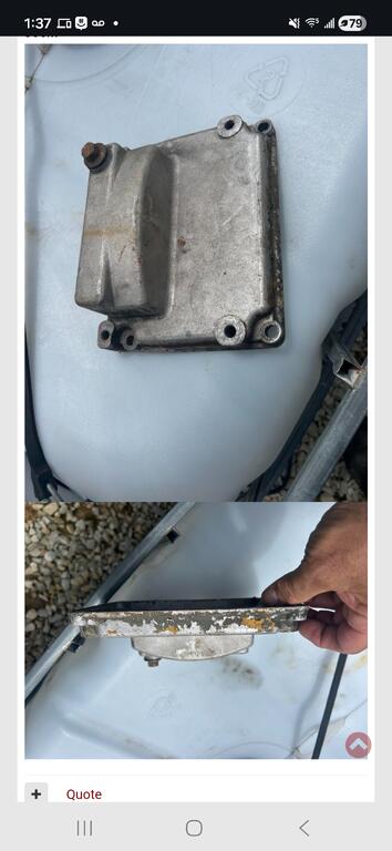

702854boy 782 #1 Posted 2 hours ago Would this oil pan work on a big block to fit under a small block square hood? Or would i still have to try to find a short pan like what the 1055s and 1045s used Share this post Link to post Share on other sites
pfrederi 20,549 #2 Posted 2 hours ago (edited) Do not think so the oil drain looks like it will be on a frame rail. What spec number engine are you working with. Edit: the pan you have in your hand probably is for Cub Cadet or an tractor with the engine mounted fore and aft not cross wise like wheel horse You need #236265 if engine is Spec # 46219 Edited 2 hours ago by pfrederi 2 Share this post Link to post Share on other sites
squonk 46,568 #3 Posted 9 minutes ago You also need a different connecting rod with a shorter oil dipper or modify your existing rod. Share this post Link to post Share on other sites
