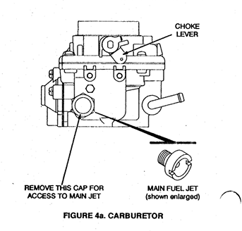

JoeM 10,316 #3 Posted May 26 (edited) I have had to clean those up to three times, make sure you clean the main jet. Edited May 26 by JoeM 1 1 Share this post Link to post Share on other sites
JoeM 10,316 #4 Posted May 26 2 minutes ago, sqrlgtr said: My 520H manifold was leaking at the seam Along the same lines I have seen the bolts loose and just need tightened. You can spray carb clean around the manifold while running to see if it revs. The plugs will tell a story too. 2 Share this post Link to post Share on other sites
Ed Kennell 47,552 #5 Posted May 26 46 minutes ago, JoeM said: I have had to clean those up to three times, make sure you clean the main jet. Mine got a little better every time I cleaned it. It took three cleanings to finally stop the surging. 1 Share this post Link to post Share on other sites

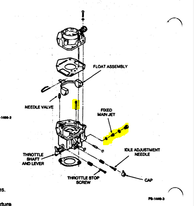

lynnmor 9,049 #6 Posted May 26 1 hour ago, JoeM said: Just above the IDLE ADJUSTMENT NEEDLE is a welsh plug, shown but not identified in the above drawing. Make sure it didn't fall out. Share this post Link to post Share on other sites
Handy Don 17,546 #7 Posted May 26 5 hours ago, lynnmor said: Just above the IDLE ADJUSTMENT NEEDLE is a welsh plug, shown but not identified in the above drawing. Make sure it didn't fall out. Yep, I had one fall out on a P218. Also, when cleaning, crud can accumulate back there so popping it off and putting in a new one should be planned for. Share this post Link to post Share on other sites
